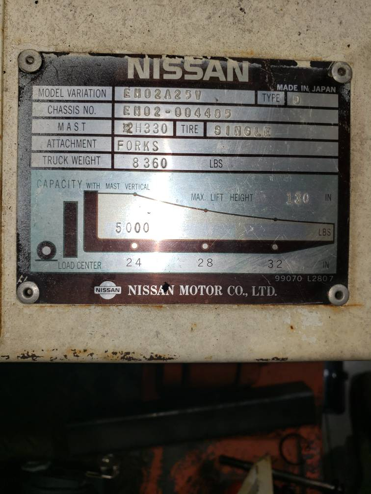

Here's the load weight chart for my forklift, thought it might be interesting, wish it had the actual numbers for all the distance points. Unlike the radial lift on a loader though, its lift capacity doesn't change throughout the lift range.
