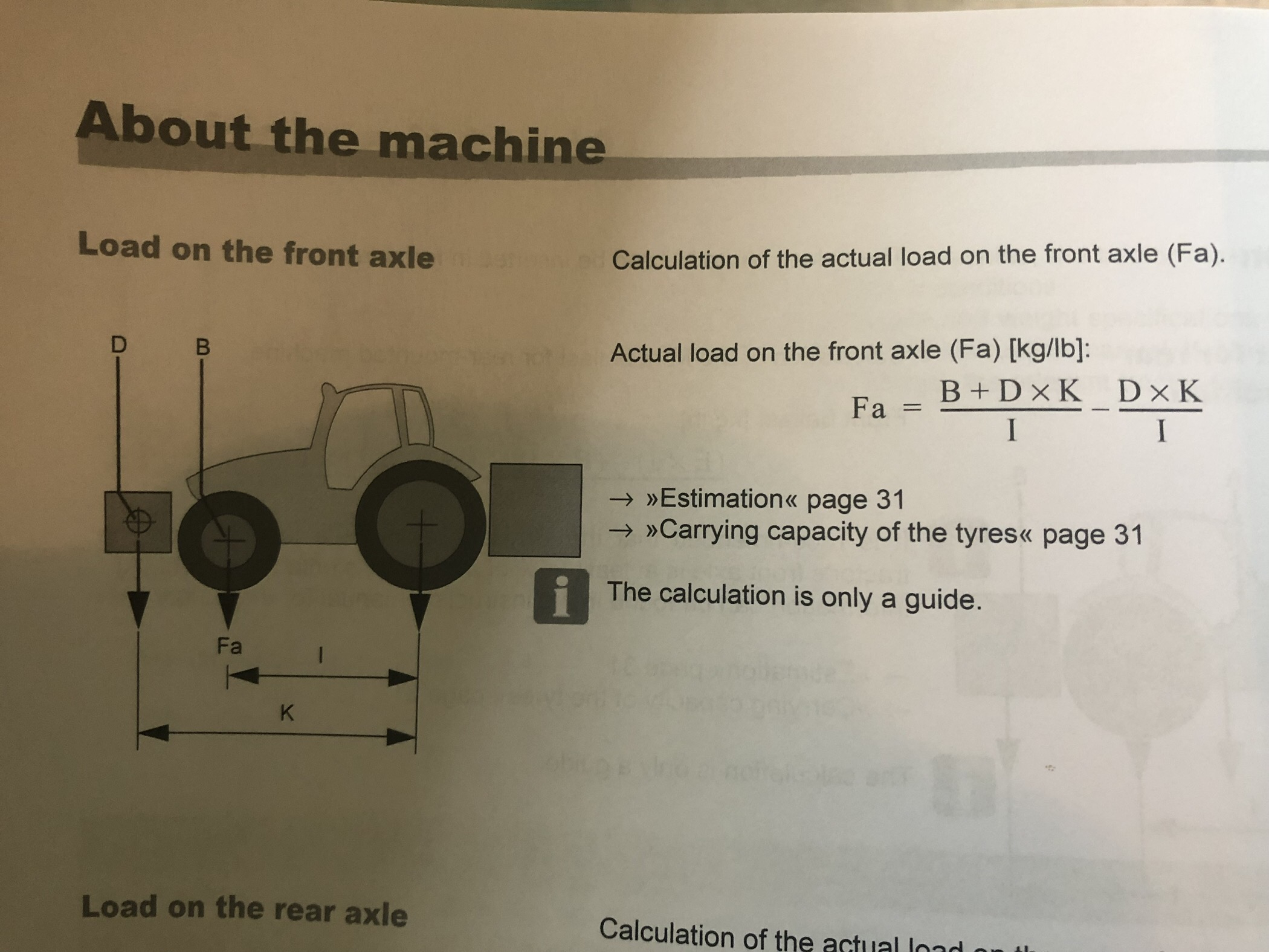

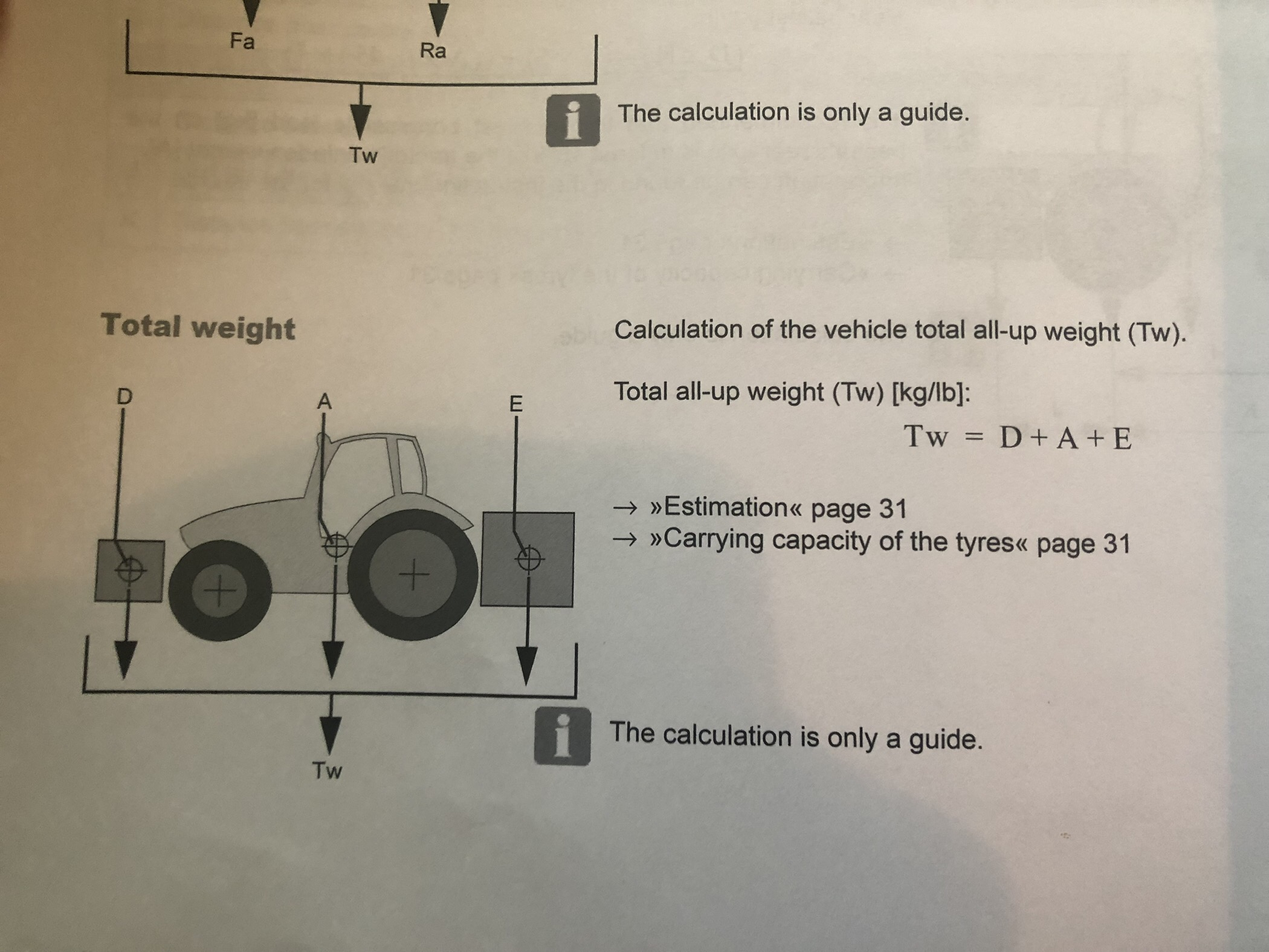

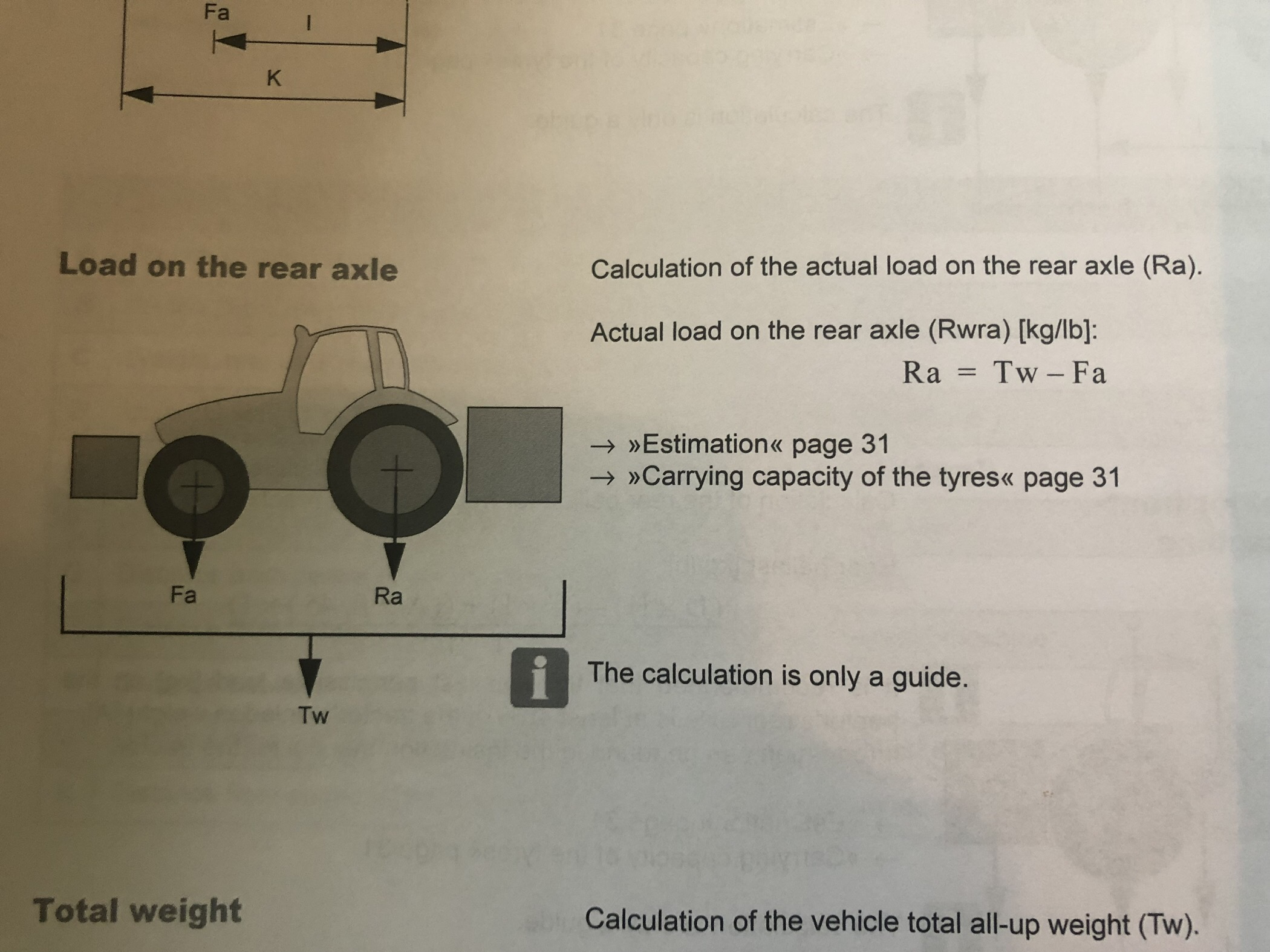

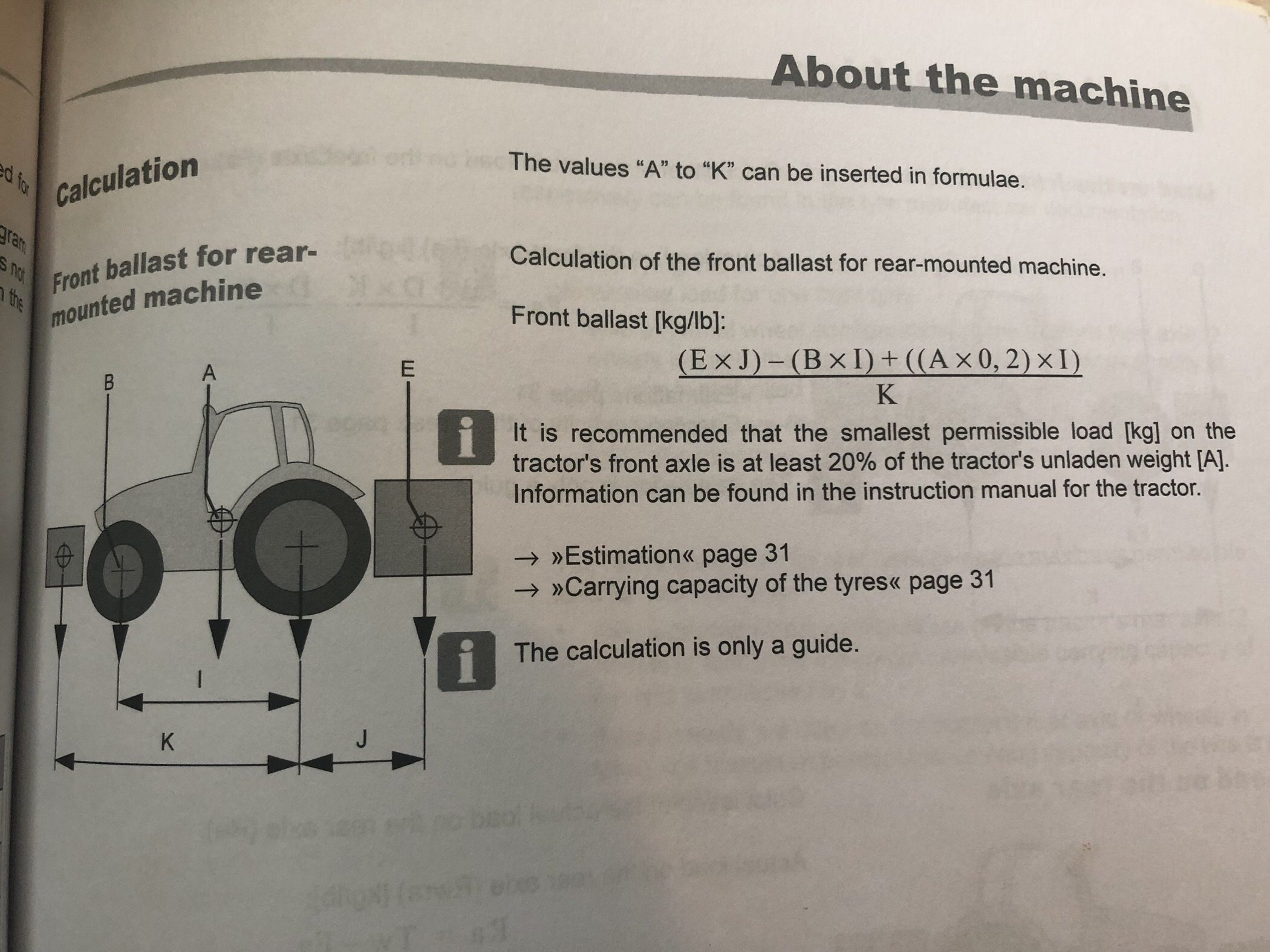

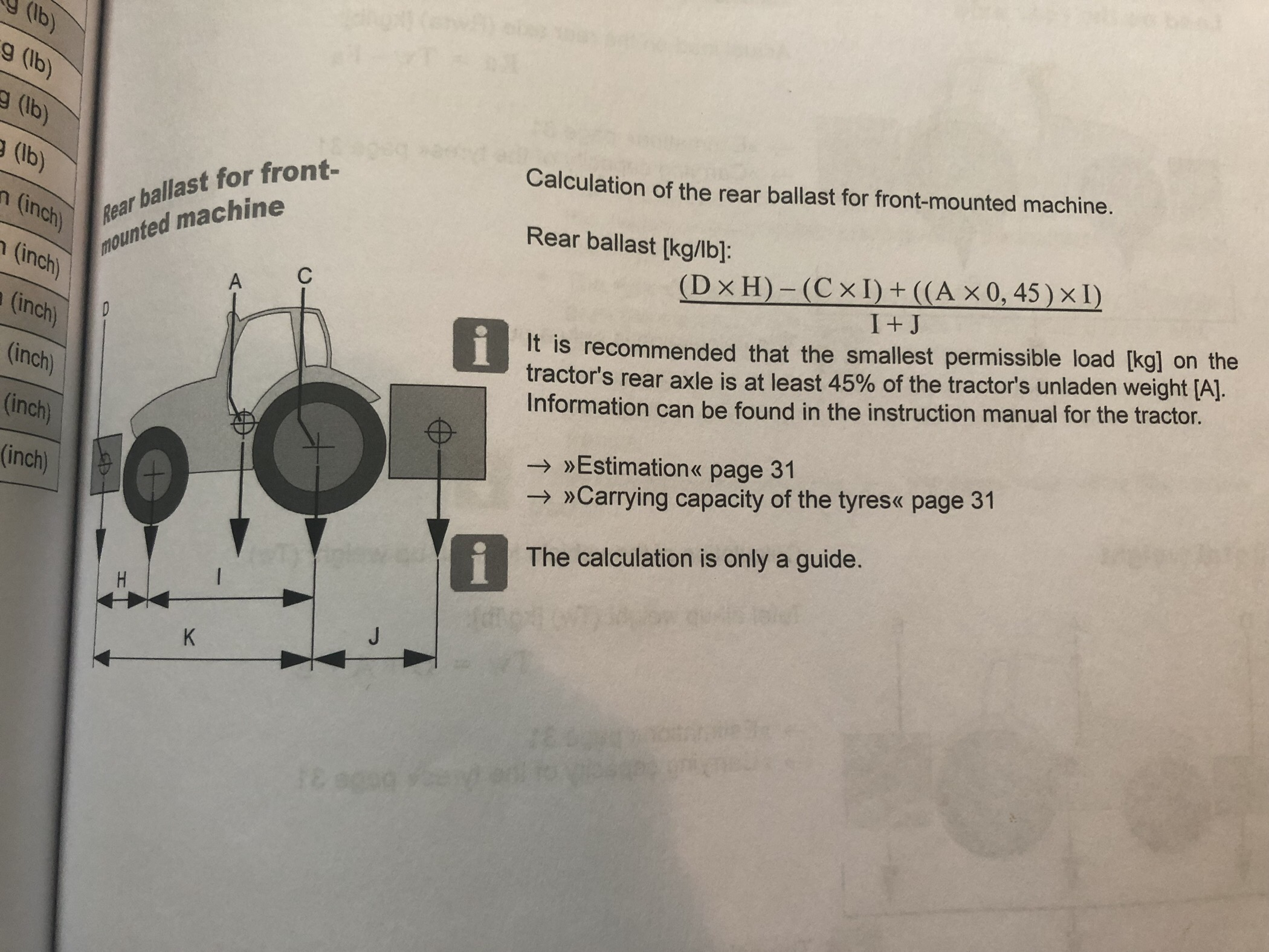

Was looking up some troubleshooting in my disc mower manual and came across these. So formulas you can plug and play for your tractors. Seems like it would be good info in the tractor manual.
   / Surprised by need for rear ballast with L 4060 in this situation #107
subscribed for those calculations nice find . tmgt beat me too it but I think there was some general info in the loader manual. especially about tire pressures with the loader installed. I think the basic concept is to use as much ballast as possible depending on the load being lifted.
