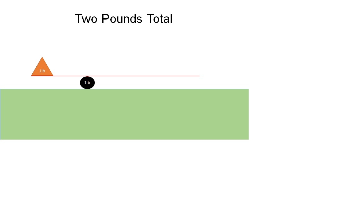

So boredom over lunch got me.
So if we have a wheel that weighed one pound and a weight that weighed one pound it would look like this. This is assuming we're using a 3' long board as referenced by 4570 and the one pound load is one foot from the one pound wheel.
If we apply gravity to this we get a tip over of our "tractor" because it can't hold the weight. Gravity causes force to be applied down with our weight (orange arrow) and our loaded tire for a total ground pressure of two pounds, one pound from our load coming in contact with the ground and one pound from our loaded tire.

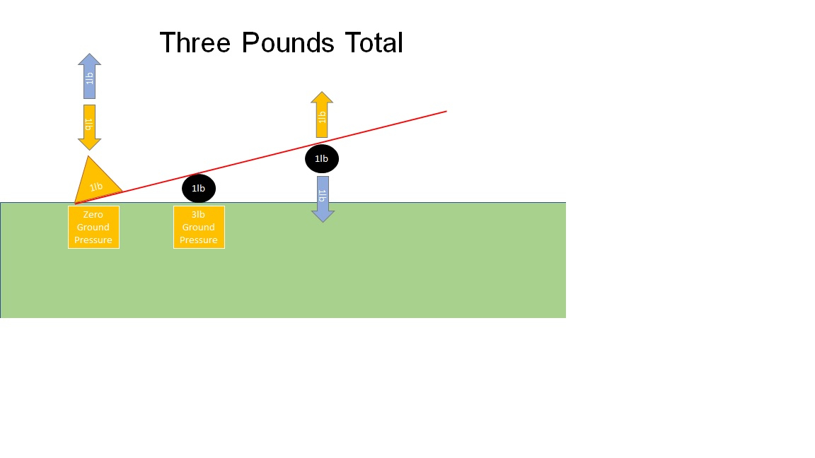

If we decide to add counterbalance in the form of a one pound loaded tire one foot farther from the load we apply three more forces to our "tractor". On pound pulling down from our counter balance tire (blue arrow), this applies one pound of upward force on the weight (blue arrow), in tern the one pound load applies a one pound upward force on our ballast tire (orange arrow). At this point both the weight and the ballast tire are balanced applying no force up or down. So unless some other force is applied the entire load is not placed on our initial tire for three pounds of ground force all at the tire, even if we leveled out this contraption so the second tire was touching the ground it would essentially weigh nothing.

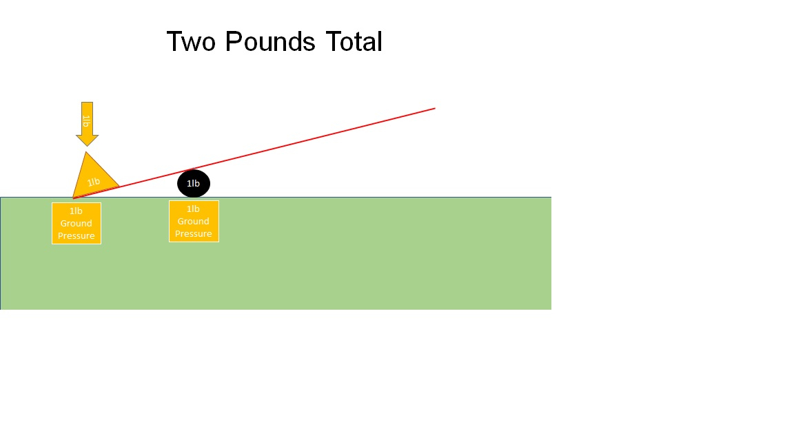

If we decide we want some weight on the second tire we can apply a second one pound weight to the opposite end of our "tractor" a further foot away from the load and past the second tire. This weight applies one pound of downward force of one pound (red arrow) which lifts one pound from the front axle (red arrow), at the same time the first tire is pulling down against that lift with one pound of force (green arrow) which also applies one pound of force upward on the new weight (green arrow). So now the total ground pressure is four pounds but each tire is only holding two pounds, that's a weight reduction on the front axle of one pound.
