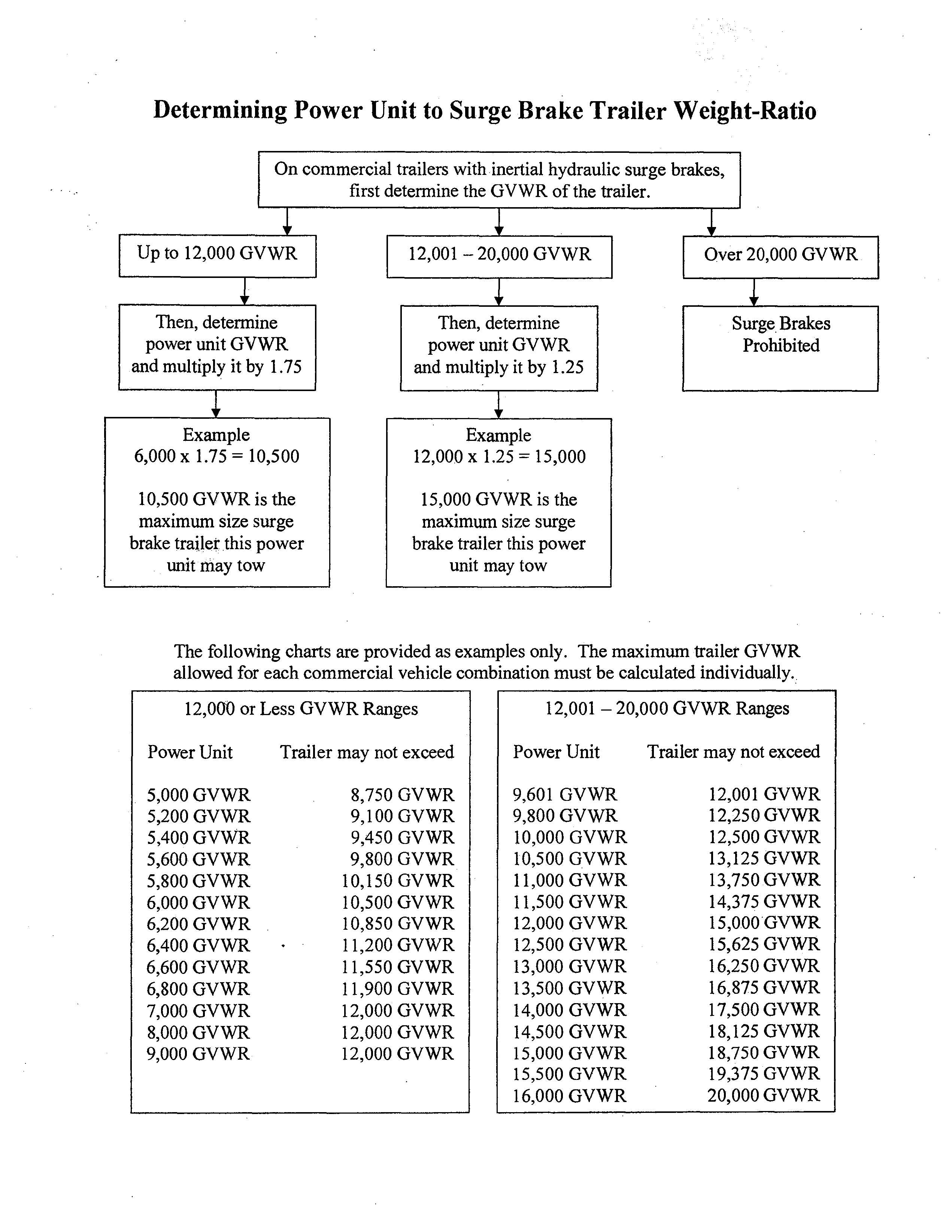

Something else to consider, when considering surge brakes.
/ Surge Brakes
#30
:ashamed:I don't understand what is being established here. What's a "Power Unit"? My trailer has a GVWR of 9,900 lbs. It weighs 2,200 lbs. To me that means it can only carry7,700 lbs. So what's a Power Unit got to do with it?
/ Surge Brakes #31
First this chart says its for COMMERCIAL OPERATORS so it does not apply to us unless you are for hire. Its a good guide though.
As for power unit I think they mean tow vehicle.
Chris
/ Surge Brakes #32
The power unit is the vehicle that pulls the trailer (usually a truck). The size of the power unit comes into play because when you are going up hill surge brakes efficiency is diminished. You can argue that gravity helps slow you down in this instance, I will not argue that. This is a chart/formula the feds came up with and I think it should be something one should consider when considering surge brakes.
You are correct on the load capacity of your trailer.
Yes the chart is for commercial vehicles, however if you were in a crash and a good attorney gets a hold of the information, who do you think they will find at fault.
