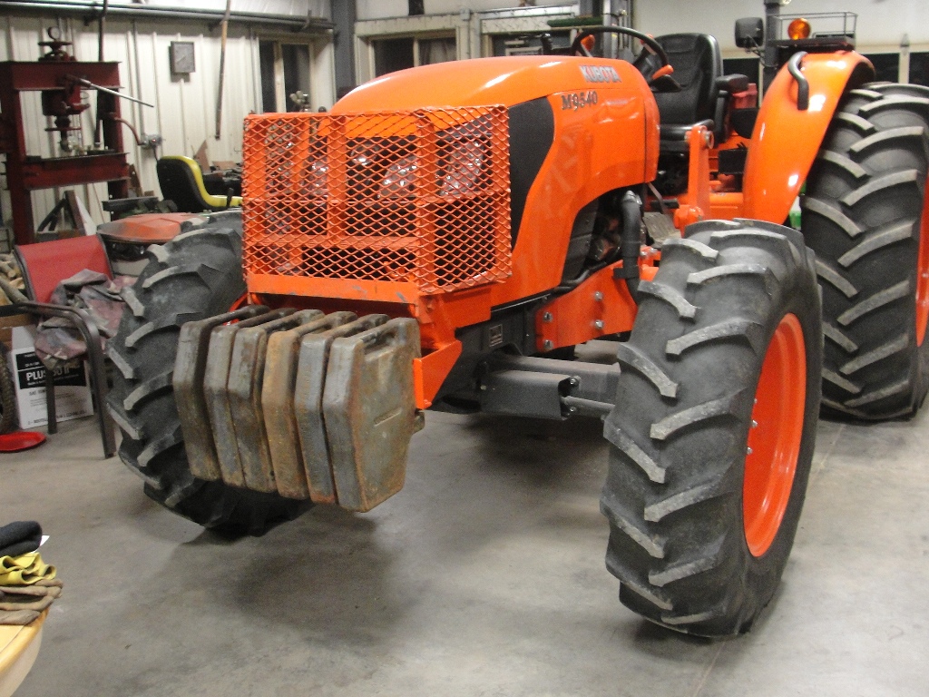

ovrszd--I've been thinking of adding 600 lbs off the front of my similar sized Kubota like yours. How does it feel and handle with that extra weight? Does it pull weights noticeably easier? How much easier?
/ Suitcase weight: is this ok? #25
Murph and Terry, don't be jealous. ;)
/ Suitcase weight: is this ok? #26
My primary use is with a JD M10ft 3pt brush cutter. I have added to the bracket and carry nine 120lb weights. Makes the tractor very stable.

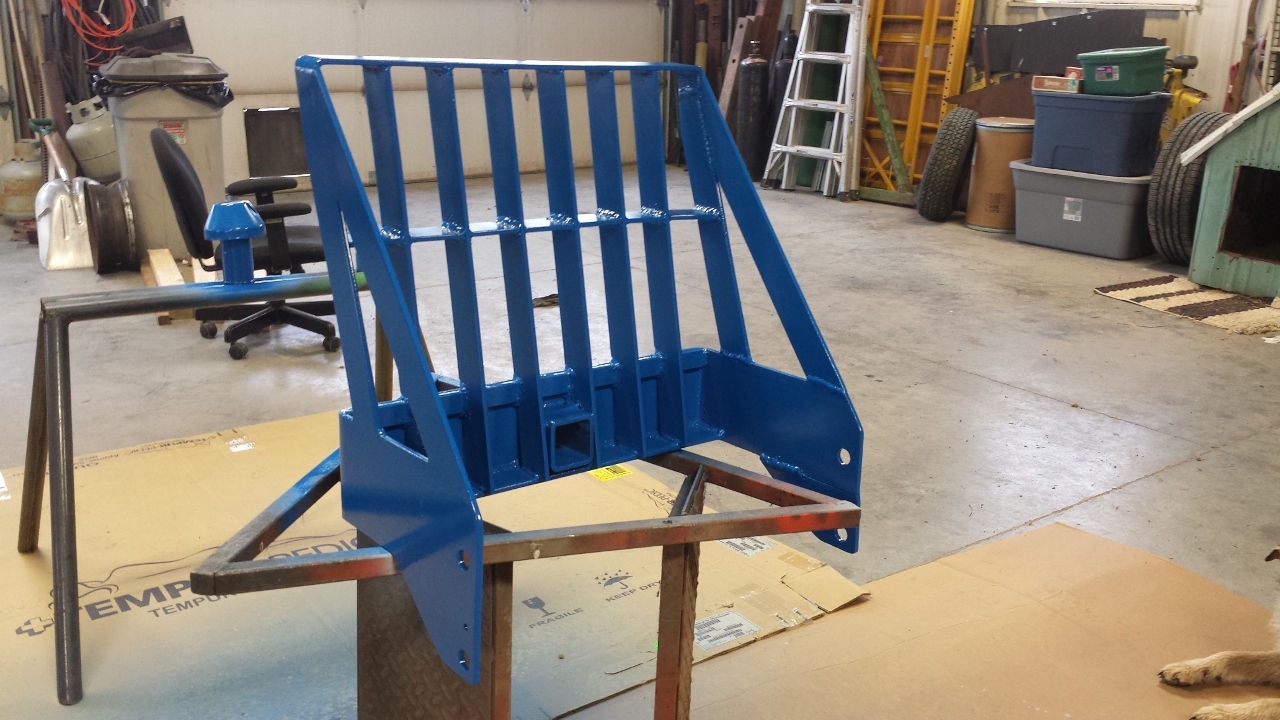

FWIW, I plan to make a 3pth carrier for 12 weights by altering a 3pt trailer mover I have.
/ Suitcase weight: is this ok? #28
Now that sounds like a great idea. Pics would be a nice since others would like to do something similar.

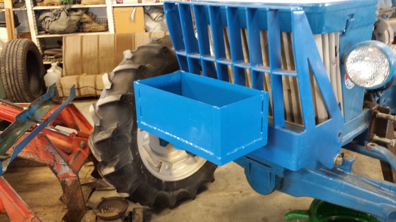

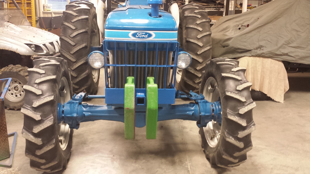

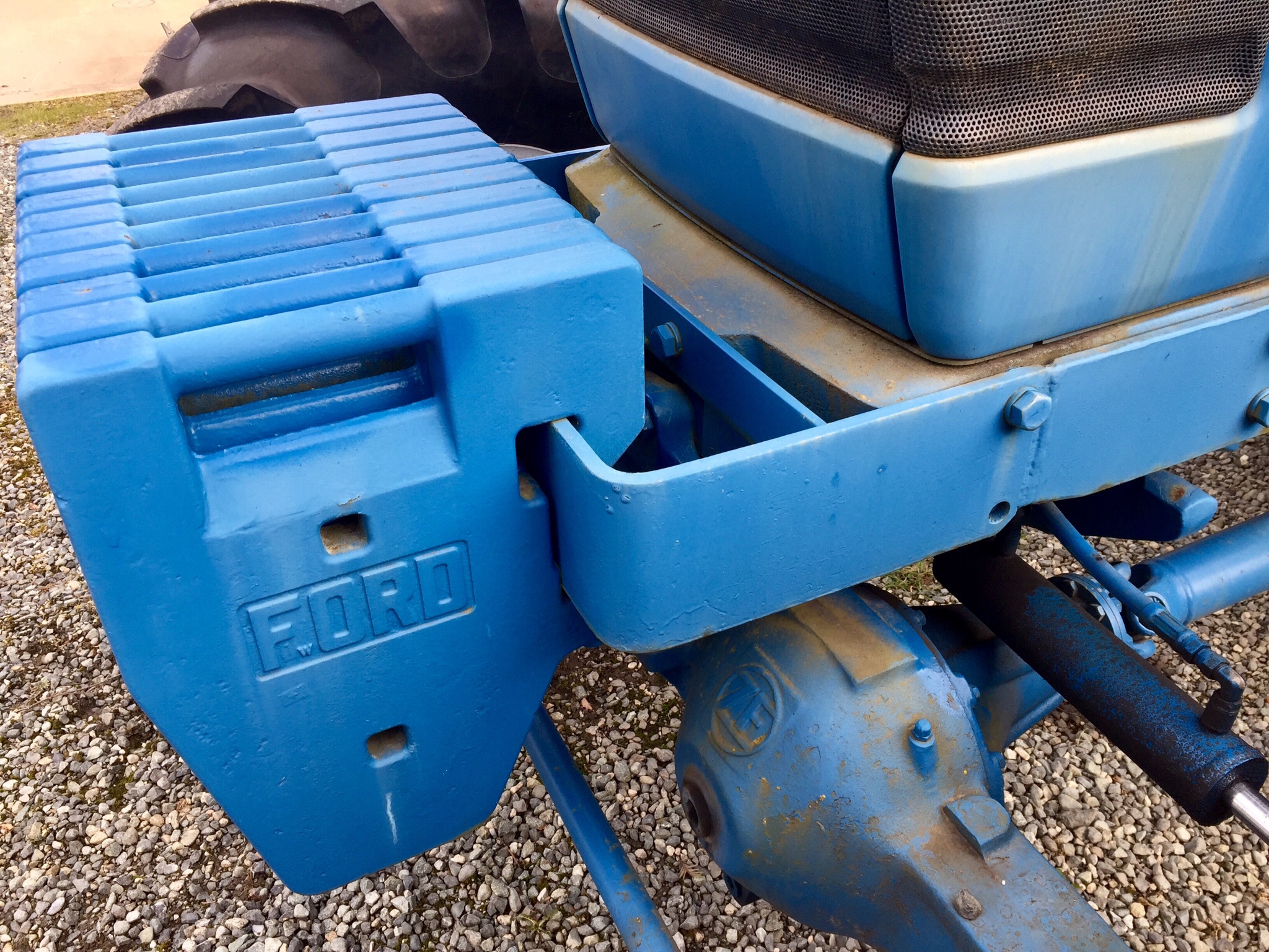

We've always kept suitcase weights whenever we sold a tractor. Here's a bracket I had to fab up up for the front of a Ford.
1/2"x6" flat bar was used. The weights are 120 pounds each IIRC.
Terry

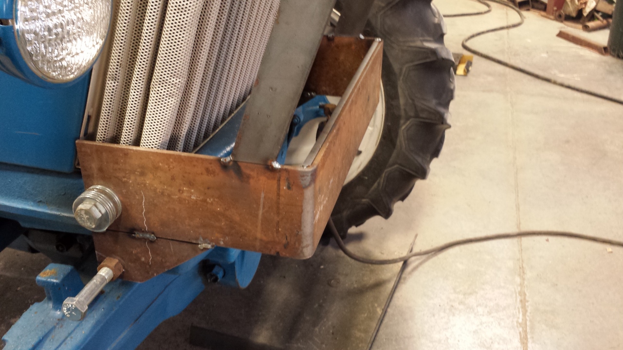

Is that bottom hole in your mounting bracket suppose to have a bolt in? Looks like you might have lost one.
/ Suitcase weight: is this ok? #36
No. I used salvaged parts. There were no holes in the tractor frame in that area. There are 4 bolts holding the bracket to the FRONT of the tractor frame behind the suitcase weights also.
/ Suitcase weight: is this ok? #37
I've lost track of the number of times I've built something from salvage parts that had an unused hole. Post a pic and someone asks why that hole is there or whatever. I then have to explain I'm cheap. I prefer to call it "repurposing". :)
/ Suitcase weight: is this ok? #38
I gave up on the "repurposing" explanation long ago.
My friends all KNOW I'm cheap. :D
/ Suitcase weight: is this ok? #39
I fill extra holes and grind flat. First, it's good welding practice plus I don't have to explain. They already know I'm a cheapskate.
/ Suitcase weight: is this ok? #40
That's definitely doing it the RIGHT way, sixdogs.
Since I can't get away with a "lightening holes" explanation for a weight ballast bracket I'll have to add LAZY to my résumé. :)
