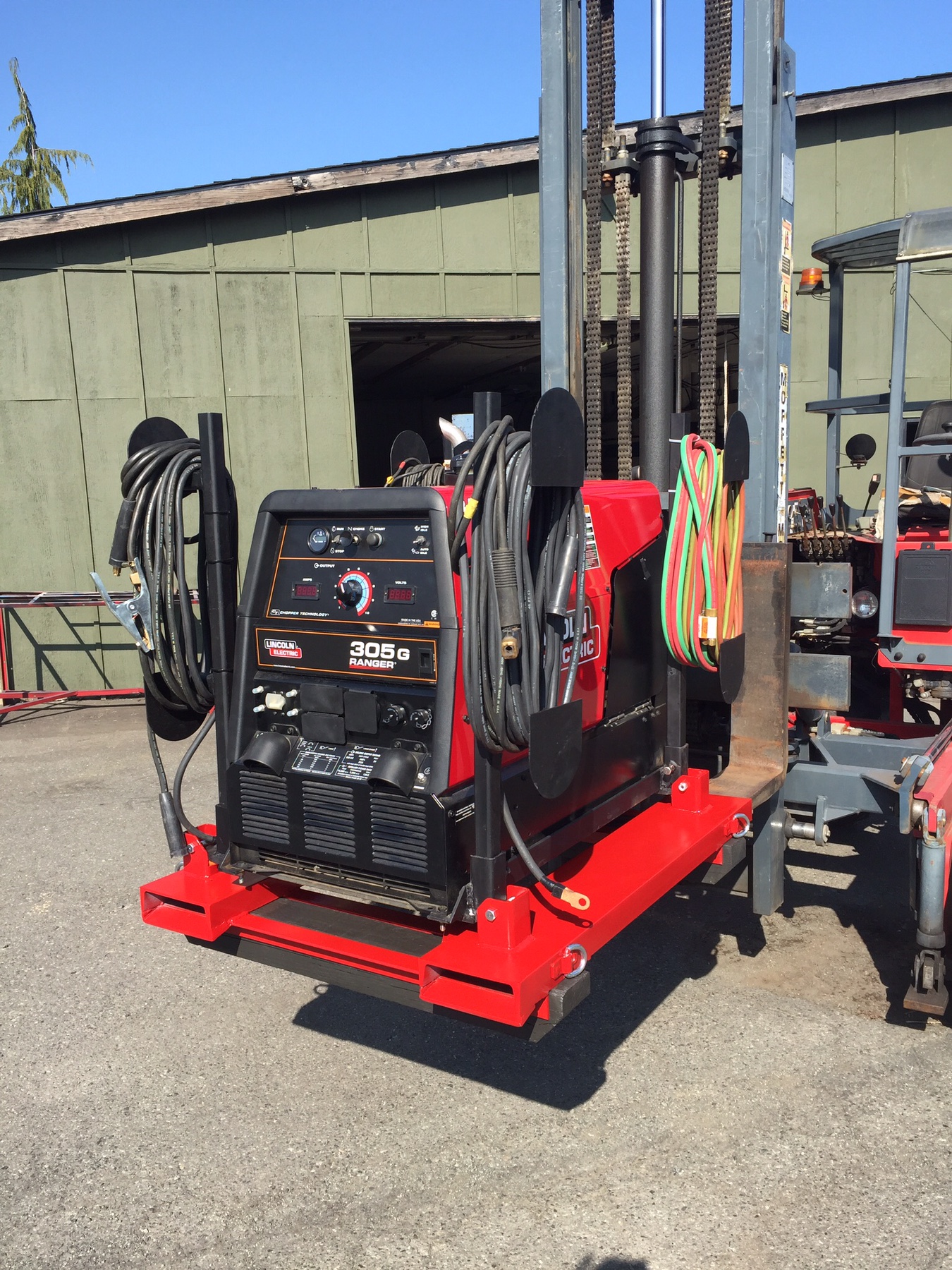

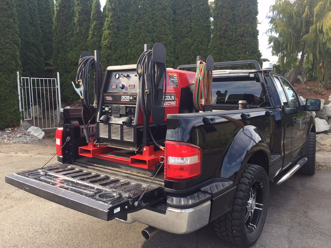

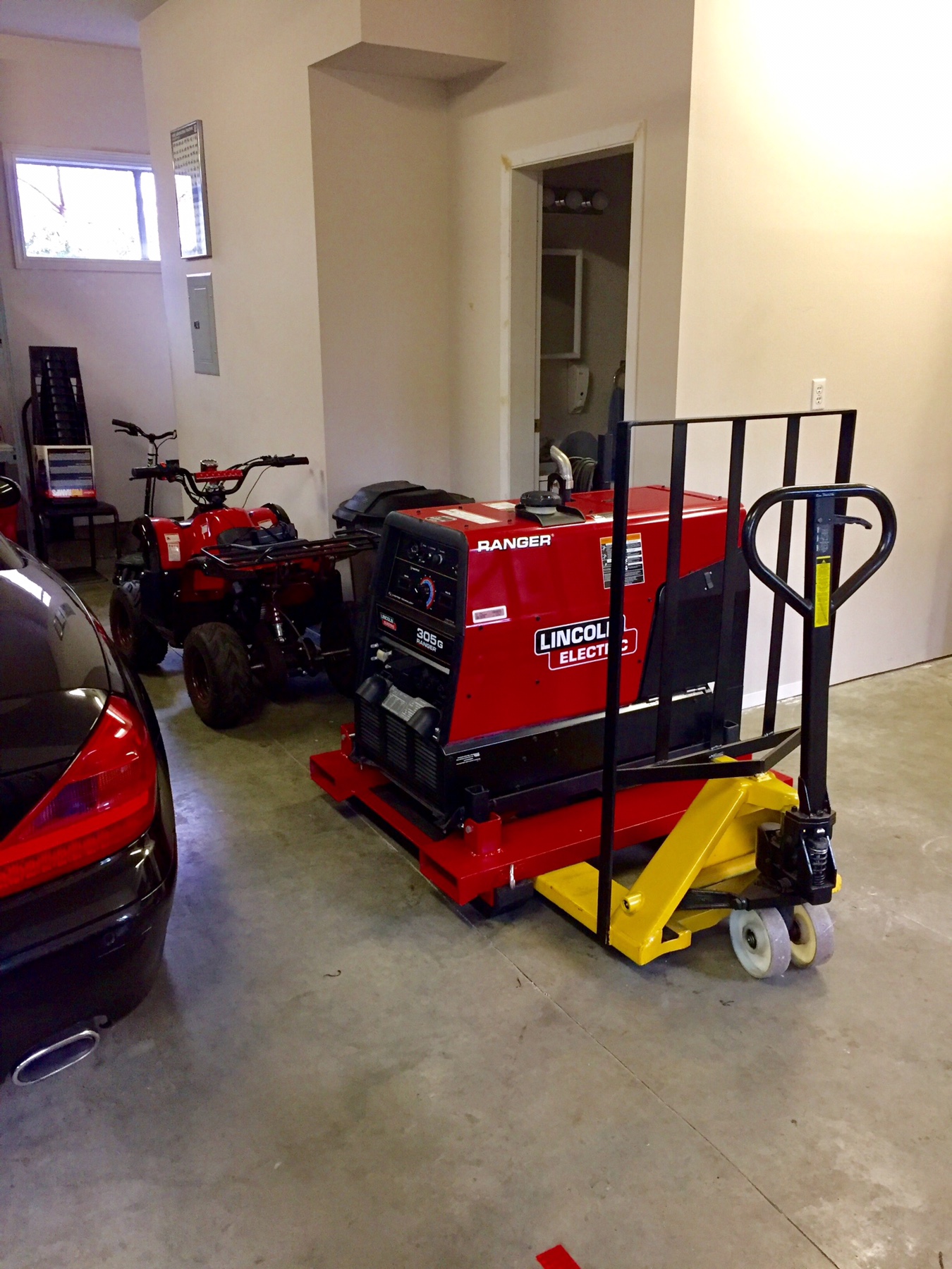

I traded an ATV for a Ranger 305G to use for my house backup power. I built a skid so it could be either forklifted onto a pickup or pallet jacked around in my garage.
Realistically, being a retired farmer, I never weld anything away from the shop anymore and I would prob be better off with a dedicated genset.

Very nice set up, Big Barn!! I should sell off some stuff as well, then I could get away with spending more. I just hate getting rid of anything! I am sure my Wife and Kids would love for me to as it is going to be a lot of cleaning when I am gone! LOL
