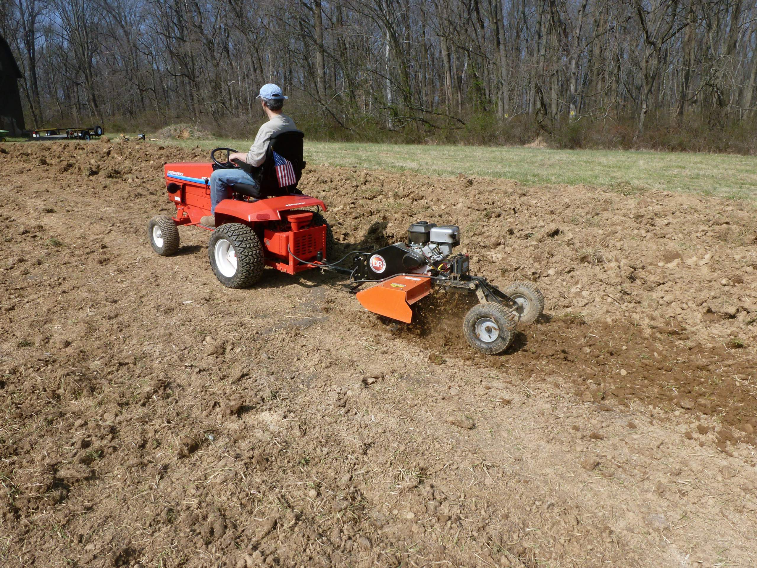

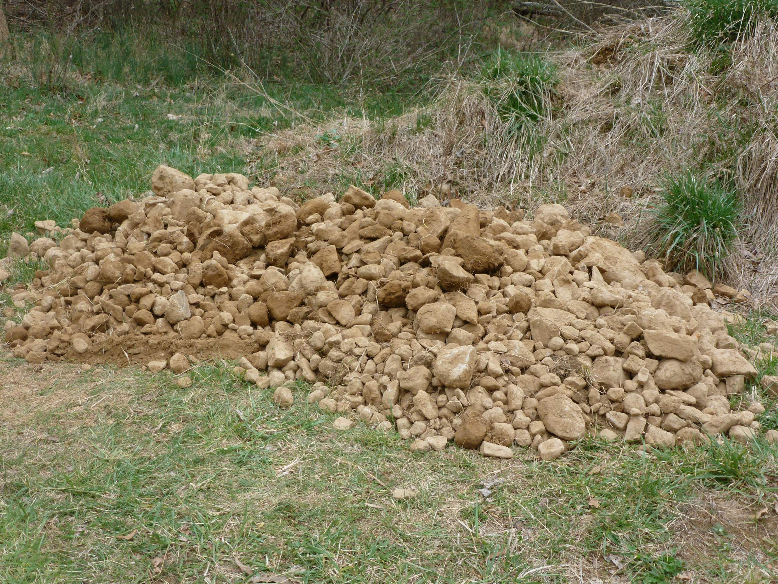

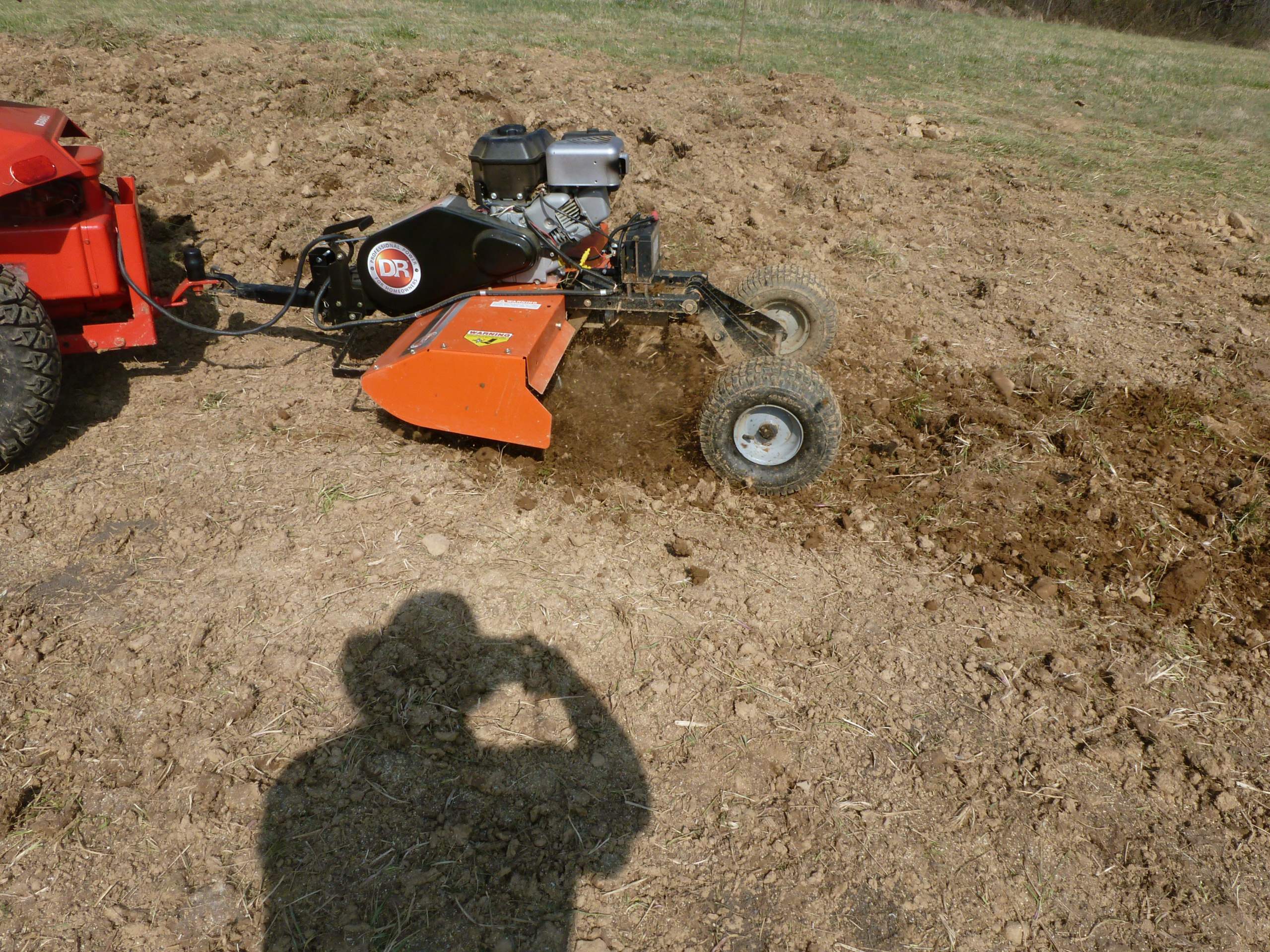

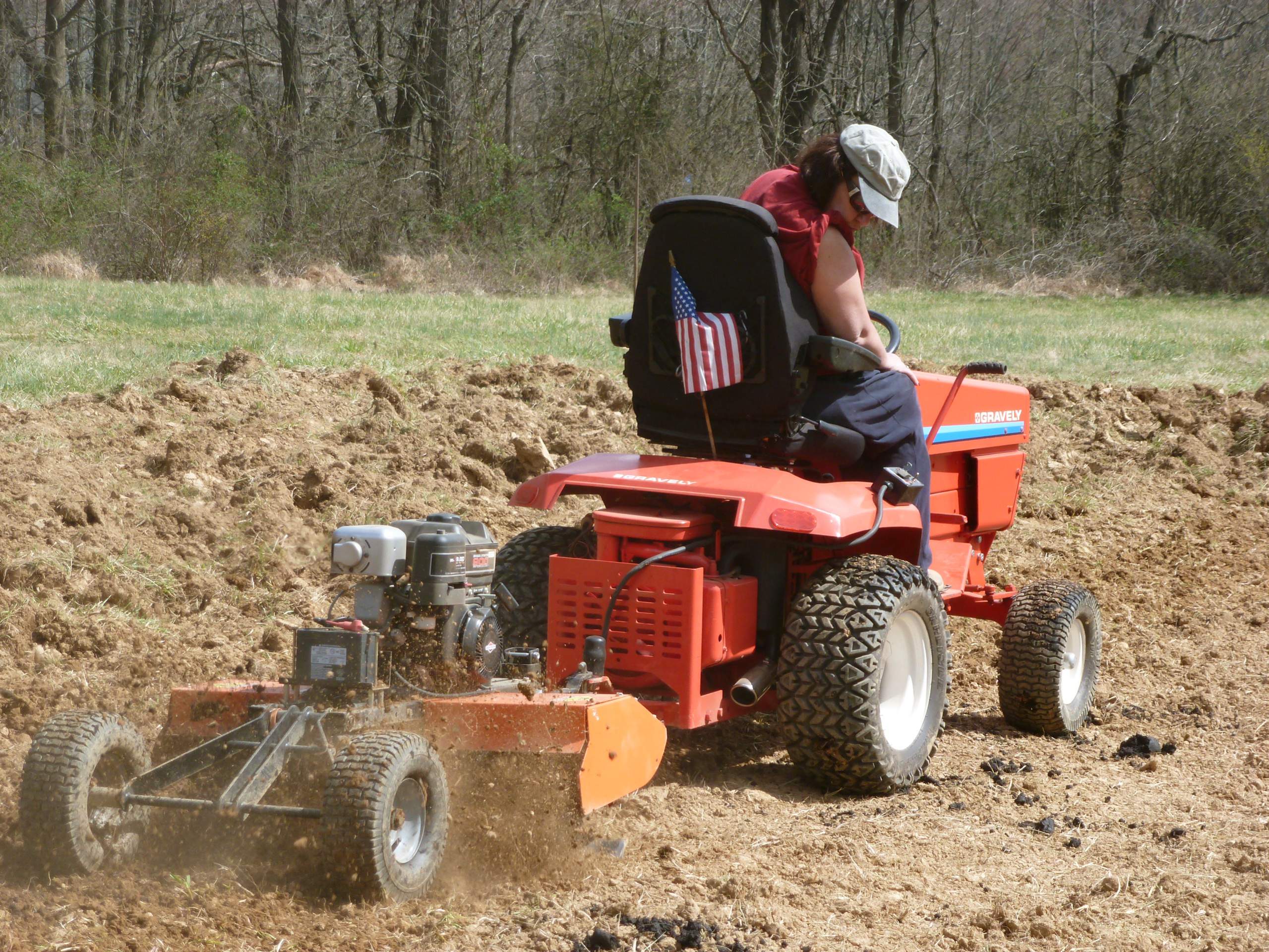

I got home today covered in dirt from head to toe, sunburned, and delighted that the DR rototiller and Gravely combination handled the rocks. At one point I looked down and there were about five or six rocks every square foot. Cart after cart of rocks picked up the hard way and the ground can be further rototilled and is becoming more friable.
I went further on one part of the garden just to give myself a break from the big rocks and of course wound up with endless small ones to pick up. Would a York Rake be a good tool to drag through the garden in the future to pick up rocks, or at least deposit them on one end? My brother in law and I looked at each other after picking rocks for an hour and wondered if we should star in a Cool Hand Luke movie, down on our hands and knees in the dirt, picking rocks.
So I have no problem justifying another implement to help out here. Suggestions please. I'm too old to do all this bending over, and I'm sure there are many, many more rocks that will come up. Thanks.

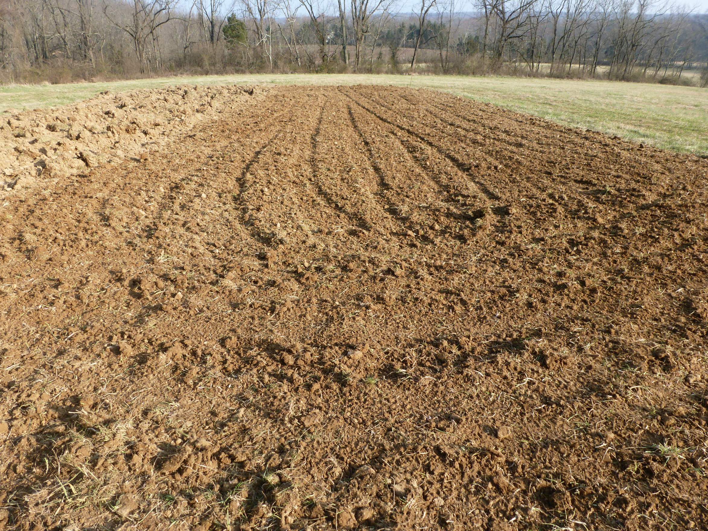

ok, this time I dropped the top link down a full inch and boy what an improvement. The dirt rolled off better, didn't dig in quite so deeply, but plenty deep to stop the tractor. As soon as I saw the dirt roll off the share like a wave, I knew things were better.
Making progress on the garden. Had my best assistant today helping me and delighted she could make it into the garden. Oh Lordy what a lot of rocks.
This pic is after a full truckload was taken away by a friend. I told him to bring a bigger truck!
Is there a three point hitch attachment, or more likely a FEL one, that will pick up rocks this size without me bending over 8 million times? Will a rear rake work or will it pull a huge amount of dirt with it? Gotta be an easier way, this is too hard for an old fart. THanks. Drew
