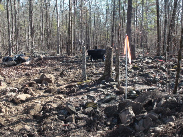

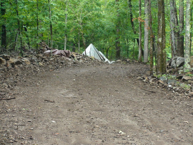

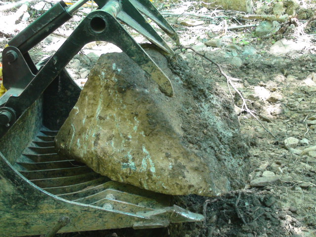

I would love to have the soil type something like that would dig in, but I am sure it would just skip across the top of my very hard clay/rock "soil". To understand what I deal with, imagine someone mixing up a few billion cubic yards of expansive clay with rocks from fist size to small boulder size and then pouring the mix onto the bedrock, and you have my property. There is no just removing the surface rocks and immediate subsurface as it is rocks all of the way through.

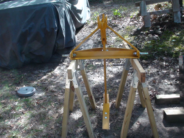

Here is my Fred Cain subsoiler, same one ETA is using in their videos. It is unused so far as I do not have the heart to even hook it up yet. I have to clear 1.5 acres of dense trees for the home site (less rocky area) and will use the subsoiler to rip through some of the stump roots to make it easier to remove the smaller stumps. Then will have a mini-x dig out the larger stumps.

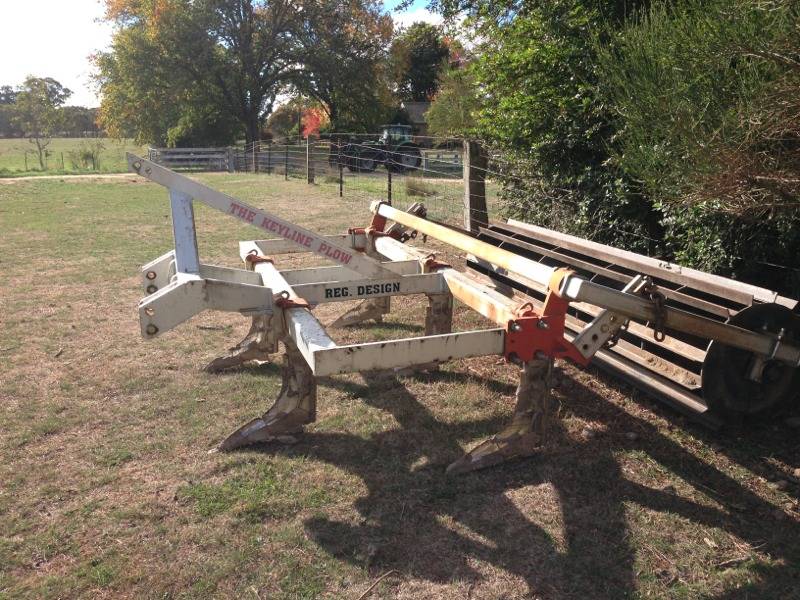

Yes a Yeomans plough is a great subsoiler but it's an expensive piece of gear that I wouldn't recommended solely for ripping out rocks
Ripping out rocks is something that usually occurs with subsoiling or chisel ploughing, regardless of whether you want to rip them out or not.
The yeomans plows main function is that of a subsoiling, but if you take a look at photos of some of the country that it has developed rocks do not present a problem.
Looking at some of the machines shown on this thread I would say that they appear to light for working in rocky going.

Your Fred Cain sub-soiler would be best for cutting roots. Maybe sharpen the leading edge so it cuts thru easier. I don't think your DK45 would have the power to pull this 5 plow ripper especially in roots or super hard soil. Maybe going multiple passes and working it down a little at a time would work. Even with fully ballasted tires, I run out of traction with my P7010 when I hit my hard clay soil area.

Agreed a Yeomans plough & most subsoilers can handle rocky country, but they're are an expensive & poor substitute for dedicated rippers - we operate a lot of gear including these implements & I wouldn't recommending using a yeomans to clear or break rocks (no unless you have $'s to burn), far cheaper & productive to use something designed for the tasks like these rippers to surface the rocks followed by a crusher to break them up :
