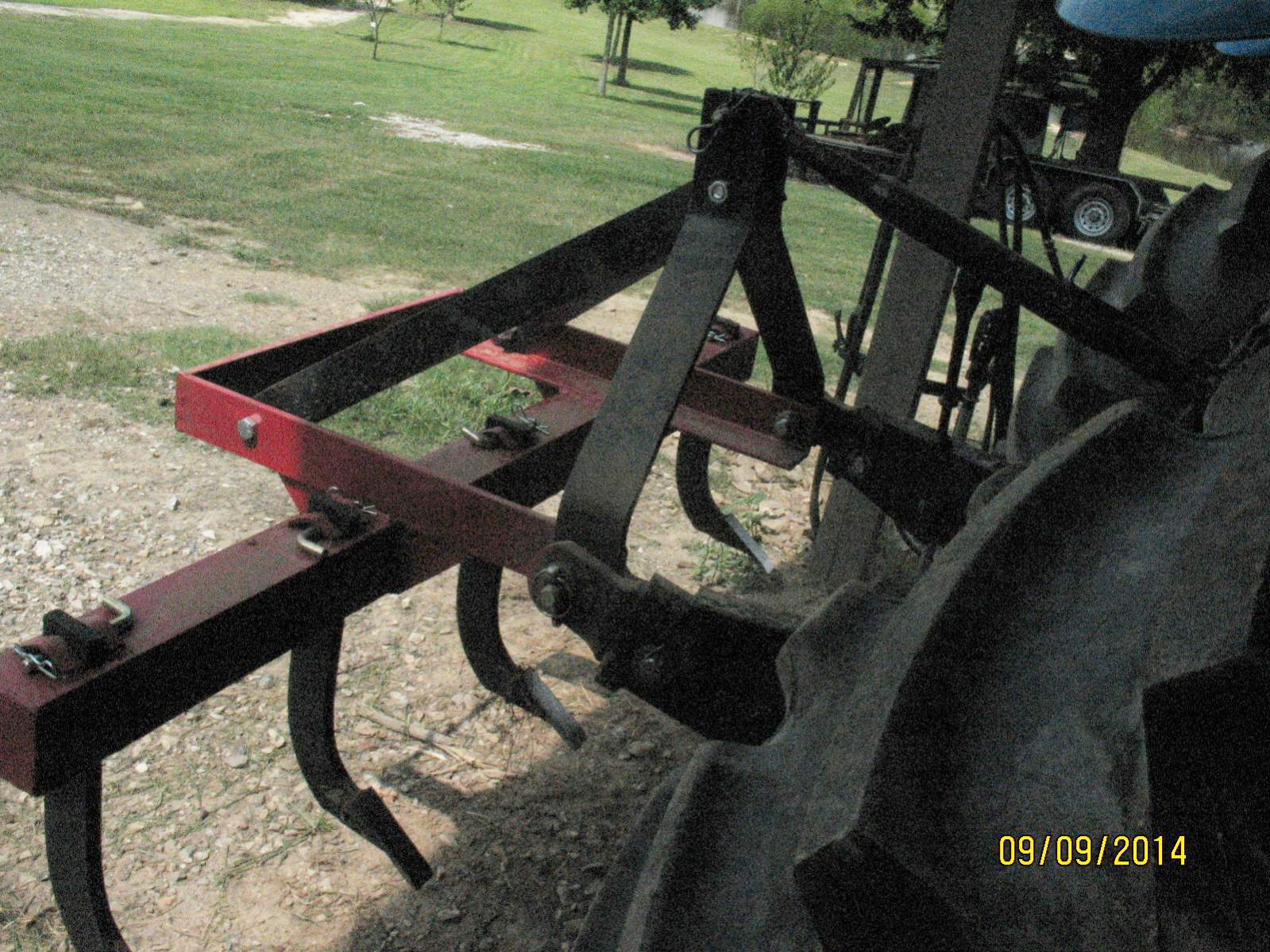

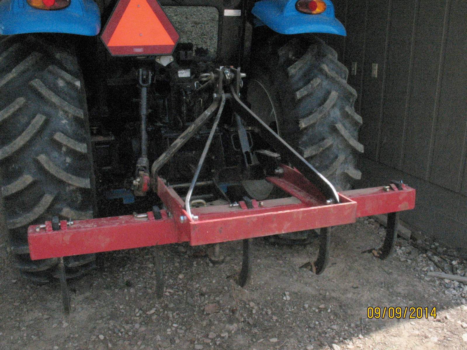

Built my own a few years ago from a converted old pull disk frame that had been originally converted to a 3 disk , then my ripper . Down hill , I can pull all 8 shanks down to the box tube they are installed in . Side hill gets a little tricky , While up hill , I don't even try ,Since I have to lift it out to much to keep the TC 30 moving .
18" Shanks , 4" in tube , 2" above . Rips right at 12" deep .
Good Find Gary !! Thing is also , You get something like that for 1 project and discover it will work for others as well !! :thumbsup:

I am surprised a TC-30 can pull this fully embedded in the ground. What is your soil type?

It takes 4-5 feet in my soil to get to the max depth that I can pull them. Some of my soil is so hard and full of rocks that even with the P7010 and only 5 rippers, it wont pull them all the way down and have to make 2 passes to get to full depth.

Soil here is mostly clay type . Extremely hard in summer now that it is dry . I mean Really hard to the point that even the 757 backhoe works to dig in it . I don't rip at all in the Summer . Only mid to late spring , moisture content in soil is still up and then again in late fall / early winter for same reason . Also TC 30 is 4 wheel drive , locked in up front and load FEL with 500 to 600 pounds of rock to keep it down . That and Gravity is on my side Helps to :thumbsup: !! At 14% + in most of the field , Tractor likes the Downhill motion .
Mine is mainly used just to break up soil for Fire Break around outside perimeter of property and again on inside of fields surrounding House area . Thought about also taking all shanks out and converting One to a pipe or electrical ripper / layer that could move to any slot along frame , But as with other projects , Having time to dream is easy , But time to implement is entirely Different !! :confused3:

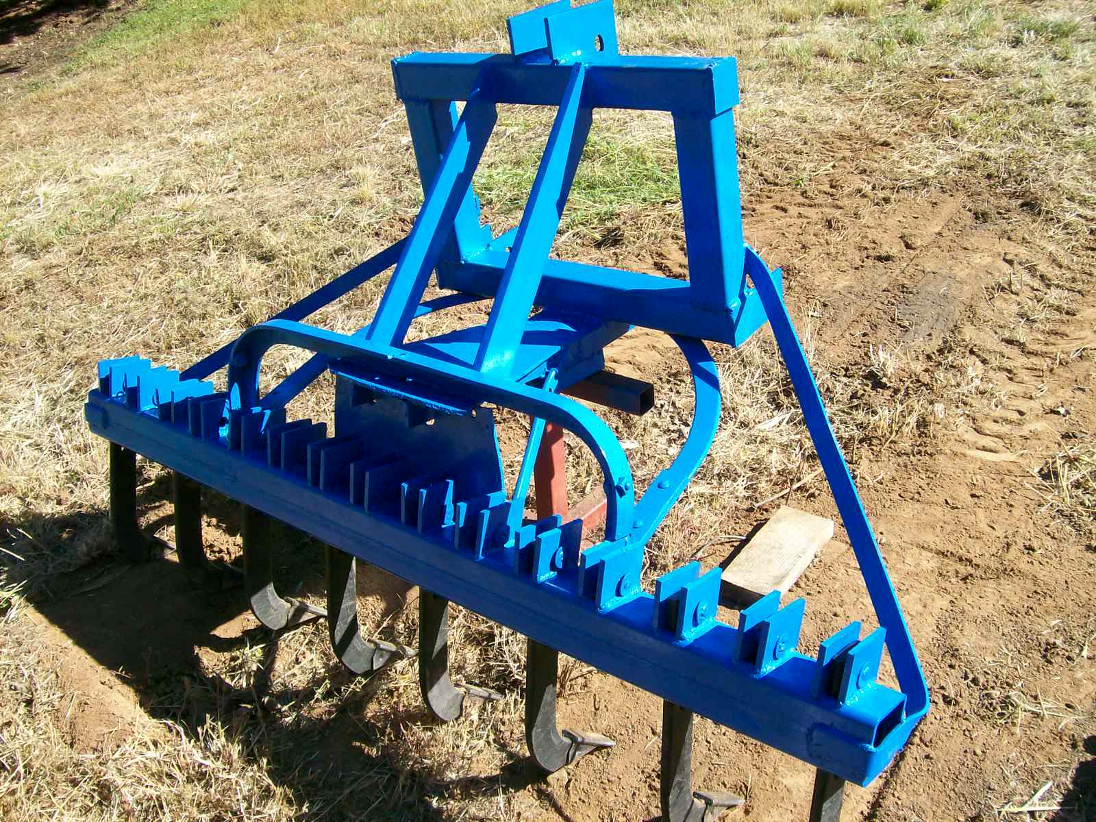

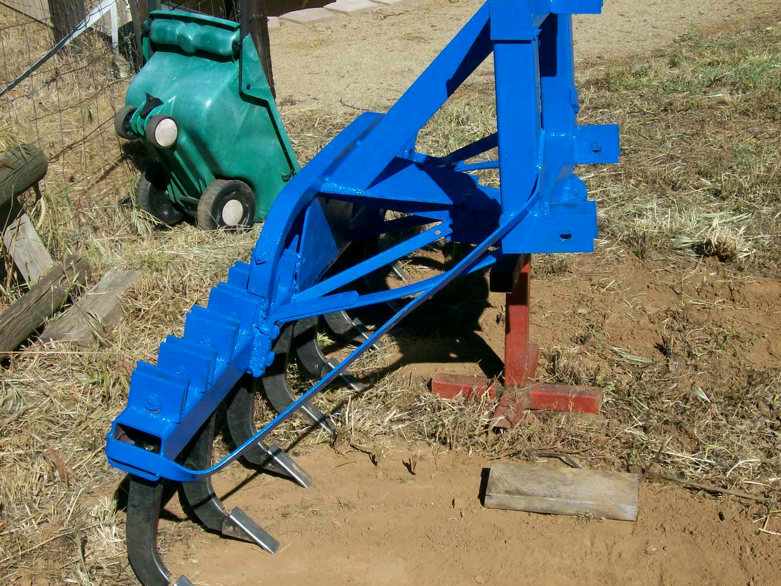

The one in the centre is an implement we build, the "wings" on the ripper shanks shatter clay substrata & flow larger rocks to the surface (the centre tyne is deliberately offset at a more acute angle to increase soil disturbance & again assists the surfacing rocks)
The 3rd yellow ripper implement is locally built, the 4x smaller ripper tynes are proprietary Caterpilar 12G Grader scarifier tynes with quick replacement points & the large single tyne is a custom unit for deep ripping & can be used as a pipelayer.
