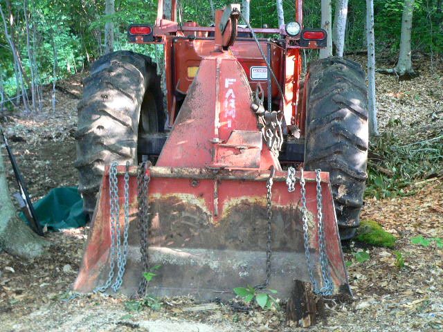

Ok, I guess I missed the fact the Farmi JL 601 is a log winch. I'm a little puzzle by Dead Horse statement, since I seen my neighbor use his to pull stumps out. His lets his dig deep into the ground which will stop the tractor from moving. :confused:
Like I said, the 601, which is a BIG winch, has a capacity of 13,200 pounds........ any stump that you can pull out with that level of force or less is easy pickings for the winch. Jake's setup is applying 28,000 pounds.
It does not matter if you wedge the big winch into a stump or use the dozer blade to do it....... 13,200 pounds of pulling force is all you are going to get.

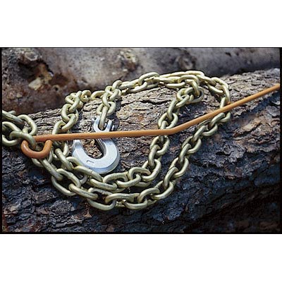

Back to business............. Jake. go get some of these at the nearest logging supply place, in grade 120......... you will not break them. I have one in square edged links on the back of my winch.......... unbreakable for the kind of loads you are playing with.
Since your statement puzzled me so, I check with my neighbor who is tree farmer and landscaper. He also has a 601. He told me when using a log winch you need to set the 3-point hitch to float to allow the the winch bottom to dig in. He stated the only time he has had any issues with dragging the tractor is when the ground is frozen. During the winter he will brace it against a stump or some other ground irregularity to get it to dig it. Digging the winch bottom into the ground creates such a good anchor he has be careful not to break the cable when pulling really large log bundles or stumps. Unfortunate he has done this at least 4 times, which why he uses an extra long control rope now.
He also made a point to be very careful winching up hill. He said he almost flip his tractor over once, which I believe is 90 hp JD, when winching a bundle of logs up a hill. There was so much force on the winch it lifted all 4 wheels of the tractor off the ground. Lucky one of his helper hollered at him and he release the winch just as the rear wheels lifted!
Jake98, I still think some kind of 3-point hitch winch frame will simplify your stump removal task.
I understand all about digging the dozer blade in........:thumbsup: I also understand that by running the cable down to the stump, through a block and back to the winch, I can double the pulling power.......... got it.
I use block and tackle for several things around my farm and understand the principle... Sorry I was not clear on the matter.....I was focused on the stuff Jake is doing here and also did not think that small winch pictured earlier in the thread would be much use for pulling stumps, at all.......
My tractor's weight exceeds the clutch capacity of my JL 601, so before the tractor comes off the ground, the clutch slips....(with a single wire pull) and a guy who breaks a cable repeatedly on a 601, is not paying attention.........:eek::eek:
