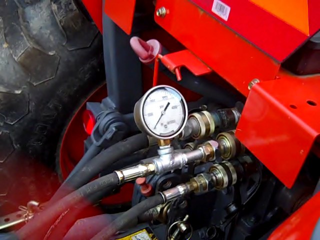

wanted to try to keep the pressure at 1000lbs. but a little shakey on the controls, first time out. need more practice at that. video link of 8" cut this fall comming out.
(at full pressure.)
www.jakemateer.com/SpecialPics/VID00038.MP4
   / stump speech
#110
this confirmed the pressure, it was either 2400 or 2600, I have to check again, but holding 1000lbs. steady didn't seem likely, there was too much going on.
