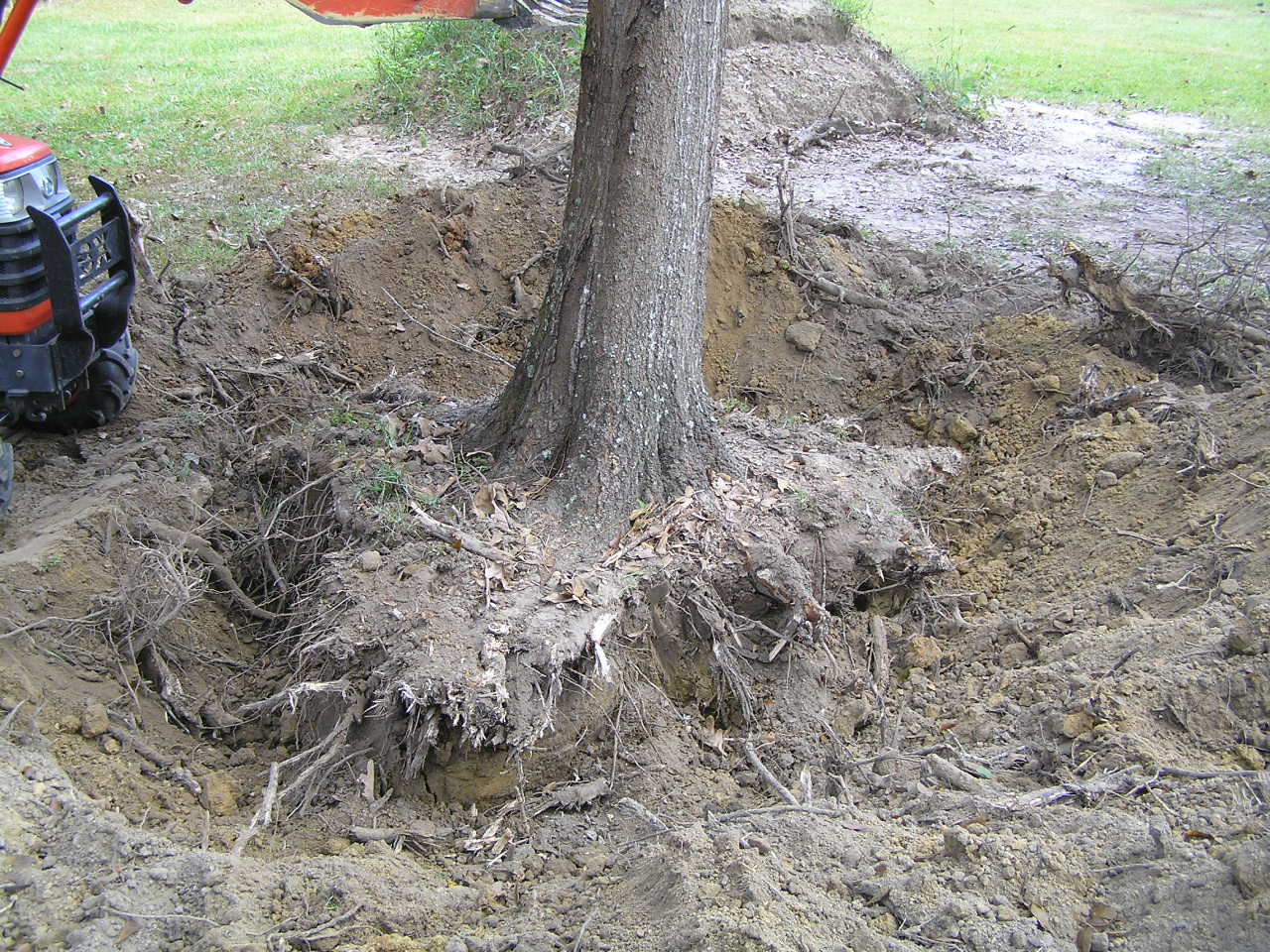

The ripper tooth arrived last Saturday and took 5-10 minutes to install. I went right to work on the stump. It took a little while to figure out the best approach using the ripper. The BX24 being a small machine is something that you cannot overcome with any gadget so you are always limited in how much you can lift or move. I was able to quickly start getting a trench started around the stump. The small roots were easily broken and the 3-4" roots once weakened by picking away with the ripper tooth also were broken. This learning curve took a little while to learn just how much of a bite you could take with the tooth and rip away the root a little at a time. Once I had a perimiter cleared with the ripper I put the bucket back on and began clearing away some of the dirt and getting a trench cleared around the stump. Then back with the ripper to clean up any roots that were missed.
Here is where I ended up after several hours. This took a little longer than normal as swapping attachments and hauling all the dirt away took away time from just ripping into the root mass. The full diameter of the "hole" is roughly 8' to put the pictures to scale.

The DST kicks in and there is no day light to work in the evenings. So the amount of work getting done in the evenings is very limited. Any work getting completed is with the aux. lights added to the BX24. I have spent maybe an hour on it so far this week using nothing but the ripper tooth. I have gotten to the point where I feel its usefulness is really starting to payoff. Using the ripper tooth like a wood chisel with a whole lot of force is letting me pare away at the largest of roots and dissect the intertwined mass of roots. I should also mention that I did sharpen the tooth after the first day and apply a slight concave grind to help keep it from slipping off the smaller roots.
As you can see in this image I have ripped away a large amount of the roots on this side of the stump. The other side had even more ripped away.

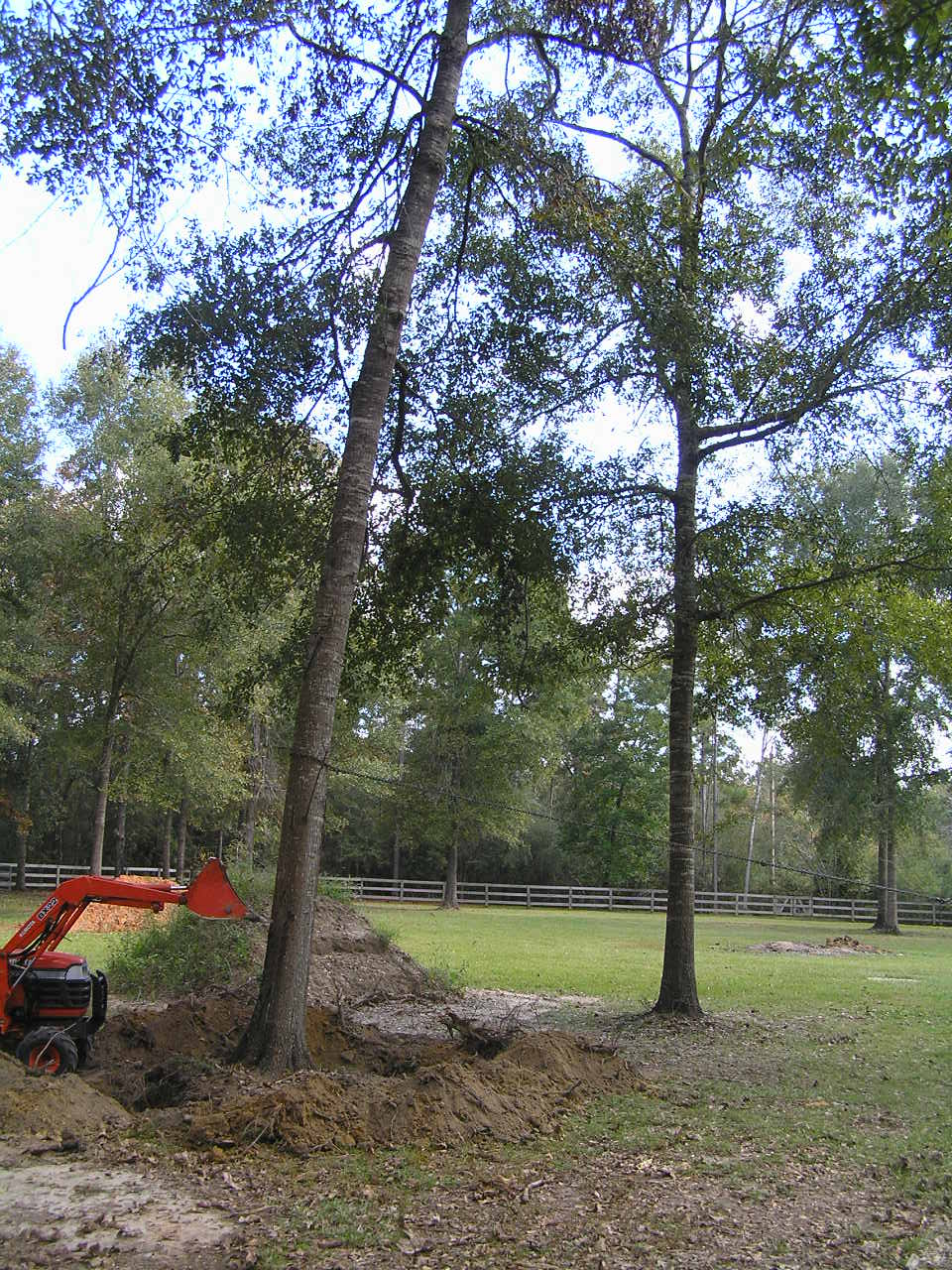

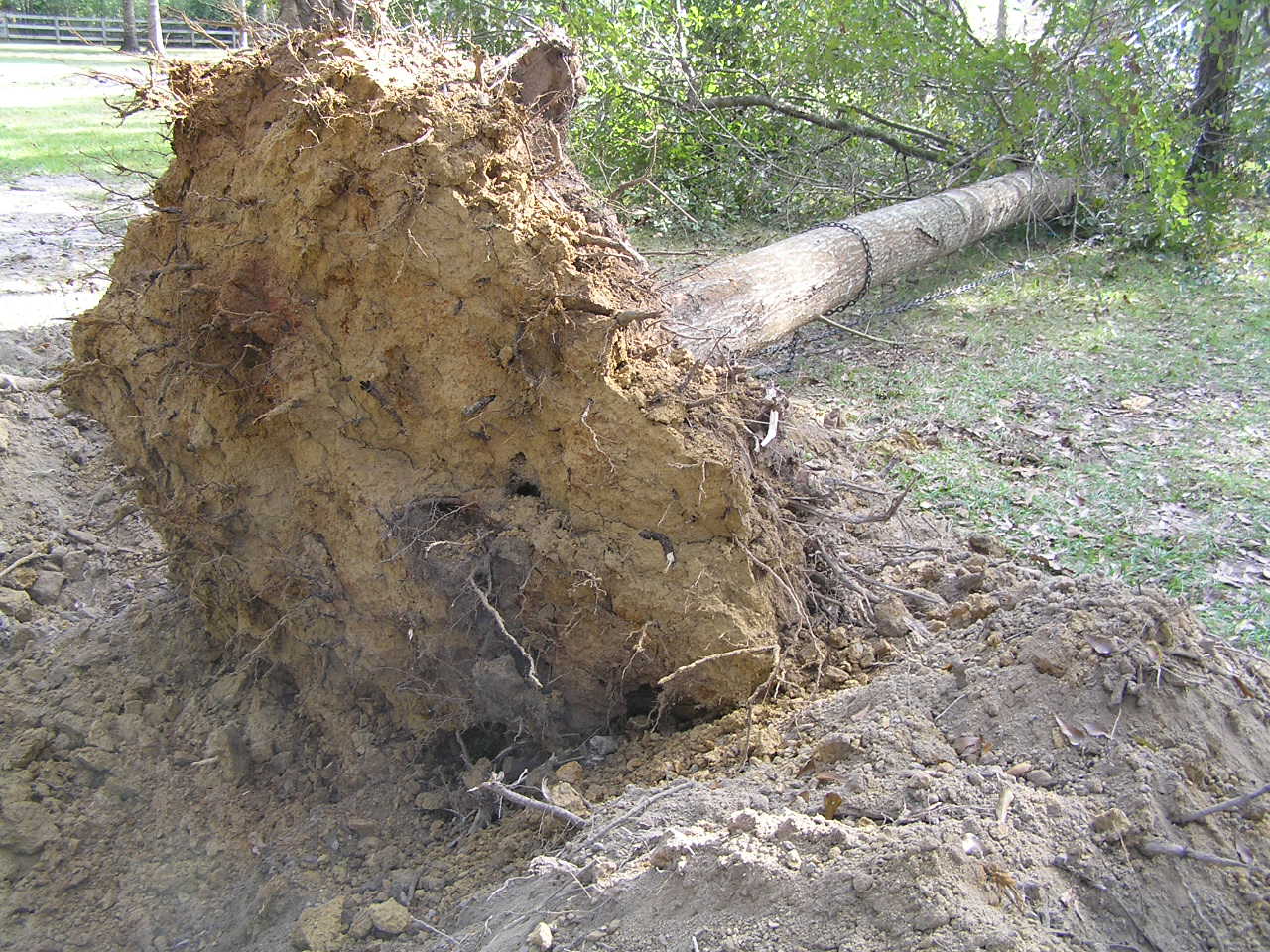

That ripper tooth looks interesting. I've dug up several trees. In fact I just did one this week. It is/was a red oak, about 16-18" diameter & about 75' tall. I took some pictures - - attached. My total dig time was about 8 or nine hours. Once I had severed the roots all the way around I found it would not budge when my powerful BX-22 pushed on it. So, I used a come-a-long to another tree near by. That pulled the sucker over, with quite a bit of dirt/clay attached, as you can see. I'm wondering if the ripper tooth would have saved any time? Oaks would seem to be likely candidates, with their shallow roots.
Now, if the tractor could just cut it into 16" lengths & dispose of all the left over debris. At least, it is next year's firewood. I'm waiting for cooler weather to get out the chain saw to begin cutting it into lengths.
Jack
