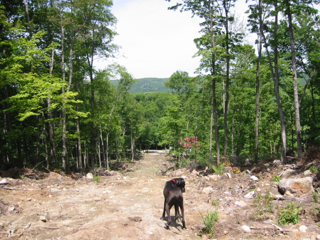

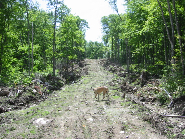

I had some 24" - 28" diameter silver maple stumps which were about 8 ft in total height with a root ball that was 8-10 ft in diameter, some of those weigh in excess of 20,000 lbs. My CAT 225 with manual thumb could not pick them up, as that machine can only lift 16,000 lbs close in.
Great information;) No wonder big trees can stay upright through the worst storms.
I had a trail put through the middle of my forest (up a very steep hill) a few years ago-see pictures. The man brought in small dozer and a mid-sized Link Belt excavator. He used the excavator to knock over every huge yellow birch and maple in his way and then piled them up so I could cut them up for firewood. He later smoothed the road with the dozer.
I have watched the CAT excavators make logging roads all around my property and I am always amazed at what they can do and how fast they can do it.
