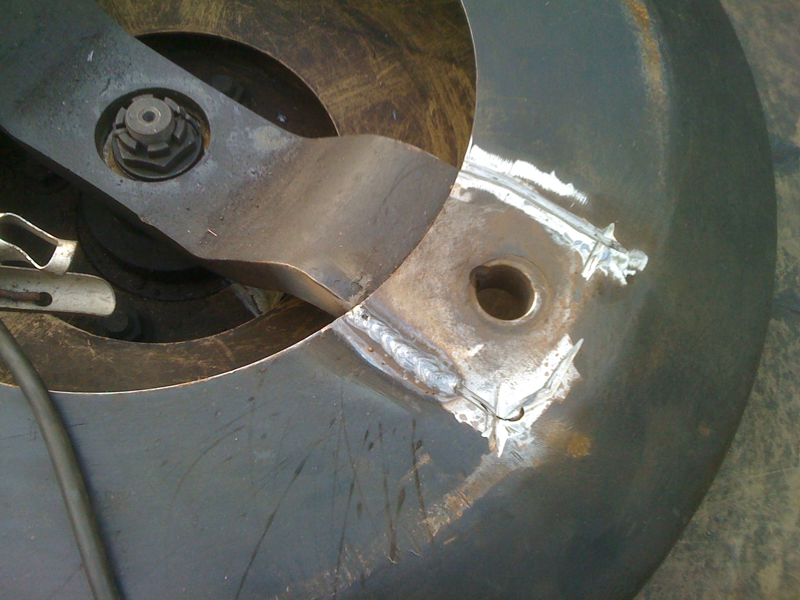

The stump jumper is trying to be difficult to get off but I still have a couple of tricks left before applying heat to it as I did not want to have to change the seal, but we will see as the day goes on.
I agree that welding the stump jumper is no huge deal, like LD 1 said it is not what is retaining the blades on the unit anyway, and the cost for that jumper is $600 I don't know where you buy that particular jumper for &100 or so, if that was the case I would buy 2 and have a spare.
I touch up my blades on a regular basis and I am going to keep a good watch on it.

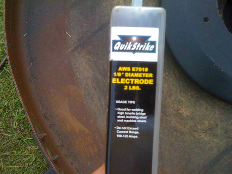

The 7018 rods that I used came in a sealed plastic container which I opened less than five minutes before using , I know that the Fl humidity is bad but they where fresh rods, I used to work for a commercial refrigeration outfit that did large ammonia systems and I labored under a few different welders cleaning welds and preparing stuff to be welded so I am not completely ignorant in that respect it has been back in the 70's though since I worked with them but I weld from time to time on my own stuff
I didn't really expect to get rave reviews from welders anyway because most of them don't like each other so thanks for the input it has made for some good reading, my only original need was advice on which rod was best for the job!
And by the way it did crack right next to original welds and stitching the weld on the repair was good advice I believe and so is drilling a hole at end of crack. Thanks for the advice and I will keep y'all posted on the progress

Well I got the stump jumper off by using a top portion of a jackstand to drive the jumper straight down off the shaft, I used the blade nut access hole and placed the solid metal piece of the jackstand top part down so the wide flange rested on the blade retainer and took a sledgehammer and knocked it loose, on the second hit it fell right off, I'm sure all the PB Blaster and white lithium grease spray over the last couple of days had to help also.
So now I'll take some pics before I prep it to be welded, I will take advice and drill holes at end of cracks and use some new 6011 rods on it, and stitch the welds in, so far so good!

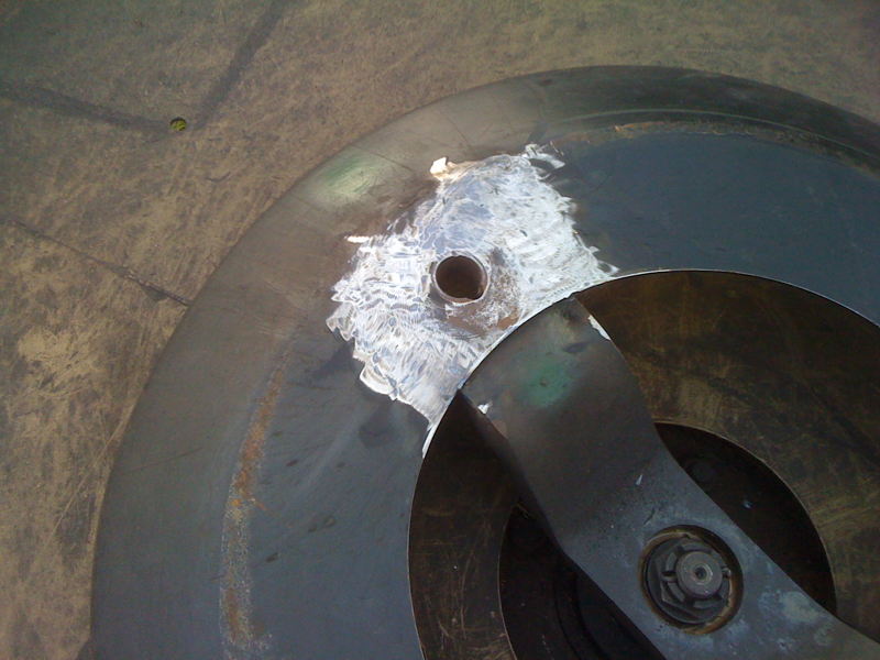

flip it over and weld the backside . i would use 1/8 6011 for all or at least first pass then 7018 .no need to drill if its welded right.
/ Stump jumper welding
#32

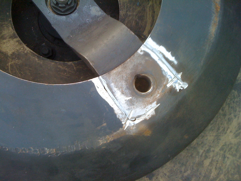

I welded the other side after cleaning up real well and I cut another 'v' drilled holes at end of cracks and welded with new box of 6011, I tried to download some pics but I am doing it from my phone and it is not working at the moment it keeps cutting off part way thru the loading process.
Anyway I stitched it in and let it cool slowly, and I put it back together with out the blades on it and ran it at 540 rpm and it ran smooth as silk. I was glad to have no balance issues, then I bolted on new blades with new bolts and nuts spun it again and it was still smooth.
I will keep a eye on it as I touch up the blades on a regular basis being I mow several hours a week and it is a lot of Bahia which is very tough grass.

Well I have been using the cutter again for about three weeks in some pretty tough conditions and so far the welds are holding up real well, I check it after each job and so far so good

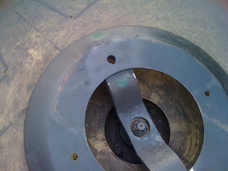

I just wanted to do an update, the stump jumper finally gave up the ghost. It has been 2 years and 3 months since I welded it and I have gave it **** with some of the stuff I cut. I found a jumper on line complete w/ blades and bolts w/ nuts sold as a whole assembly sent directly from Landpride thru a company in Indiana for $318.00 plus $28 for shipping! I was amazed at the good deal because buying it locally was $420 plus tax and shipping which would put it close to $500 with no blades or bolts.
Thank god for the Internet and some research!! I put a pic of the stump jumper and some of the stuff I have cut with it. I am sure when cutting large stuff,3" or so that when the material gets hung up between the top of the stump jumper and the bottom of the mowing deck, that is what tears up the jumper. I have made a lot of money with that Landpride cutter and will be happy to put on another stump jumper especially at such a good price. I look toward to getting another few years service from it.
