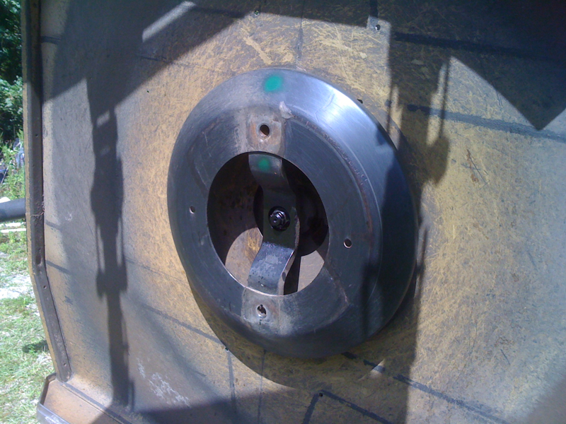

I added a pic, you can see small cracks on either side of yoke on both sides of unit, they do not extend all the way across, I have 'v' cot along the cracks since this pic, I plan on welding the ' v' full and grinding it back flat so blades can swivel like designed. Then I will remove jumper and weld on other side. What I was trying to find out is which grade rod to use for this application

I would use 7018, welding in short sections to reduce the heat affected zone and mitigate weld shrinkage. Your plan sounds okay. Take some pics so we can see how it turns out.

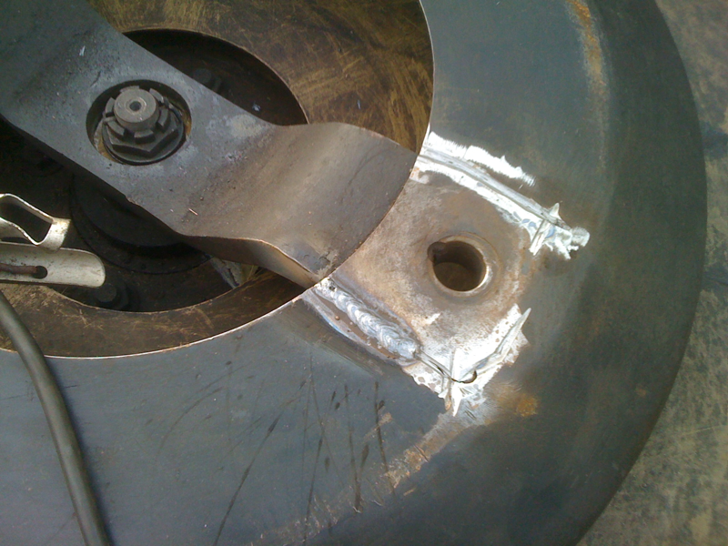

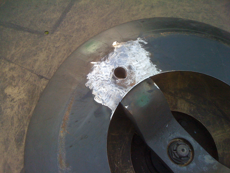

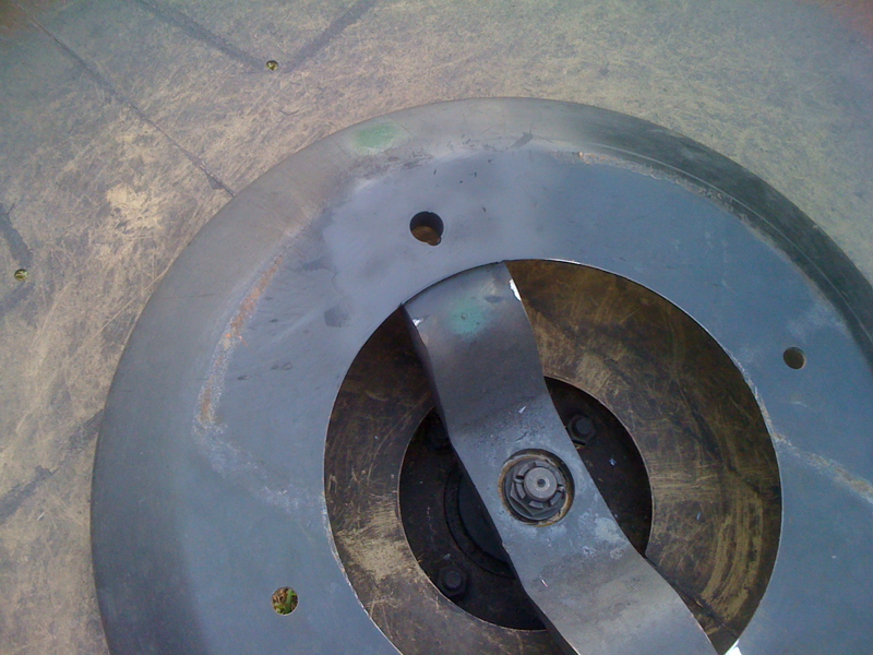

This is some pics of repair, one shows it prepped with it 'v' cut, the next is stitching the weld, then grinding flat and then painting also is a pic of the rods I used at 105 setting on machine
Tomorrow I will pull it off and weld the other side

Looks good. You will probably find that the cracks were on the edge of the original weld holding the disk to the blade carrier.

I see cracks extending past where you have been welding.
#1 Drill a hole at the end of each crack.
Forget 7018 unless your are a real welder, can keep it hot and dry. A good weld with 6011, 6013, or 7914 is better than a poor weld with 7918.
Best of all get a new one. Second best take it to welding shop. 3rd Best you are already doing.
/ Stump jumper welding #14
It looks like a pretty good repair to me. Hard to tell but did you always weld to the middle and not leave your craters at the edges? I would just look at it regularly and make sure you don't see any new cracks.
