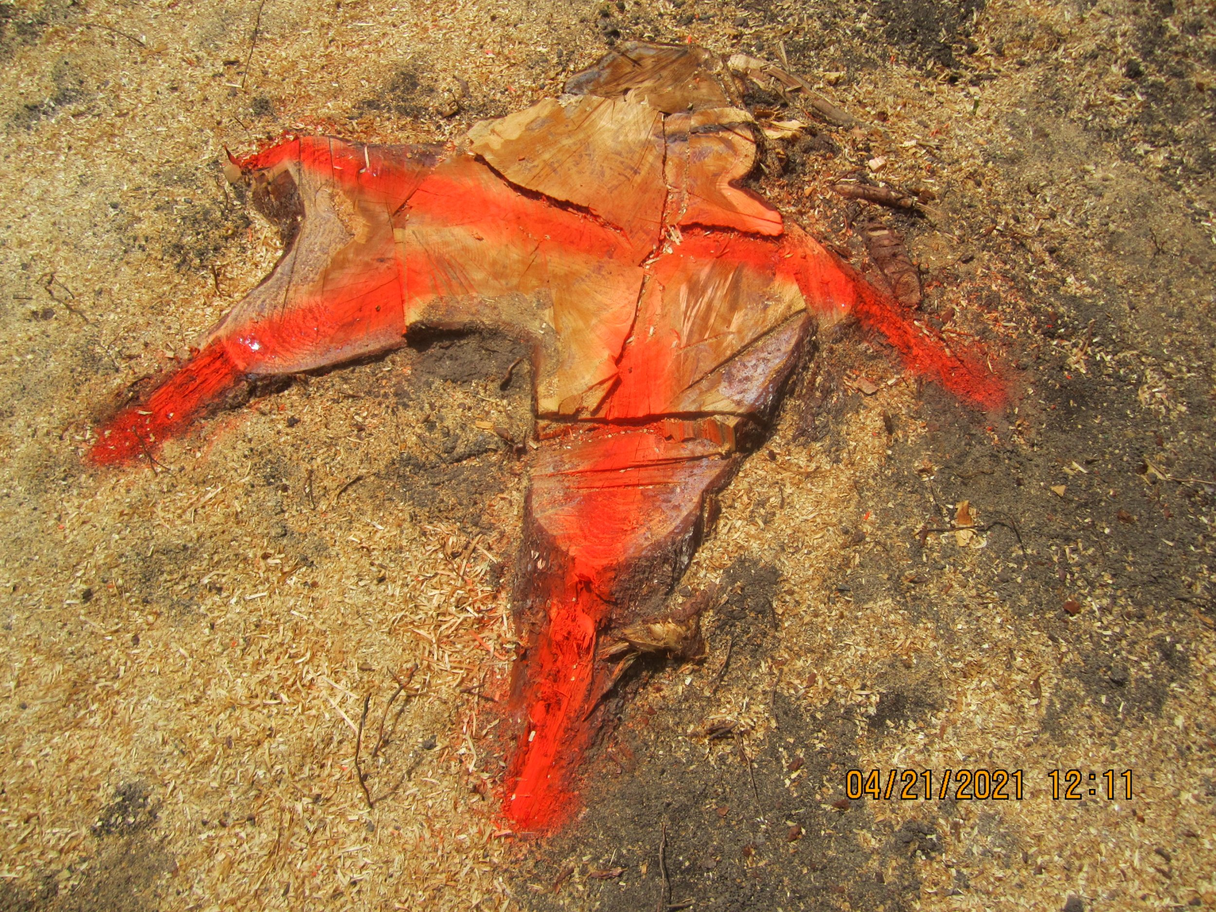

Here's the first stump I ground the day I picked up my Woods grinder about 10 years ago:
I have probably ground close to 500 stumps with it now and it still goes strong. I was being real gentle on it on that first stump. Today I could probably have done that stump in 2 minutes or less.
