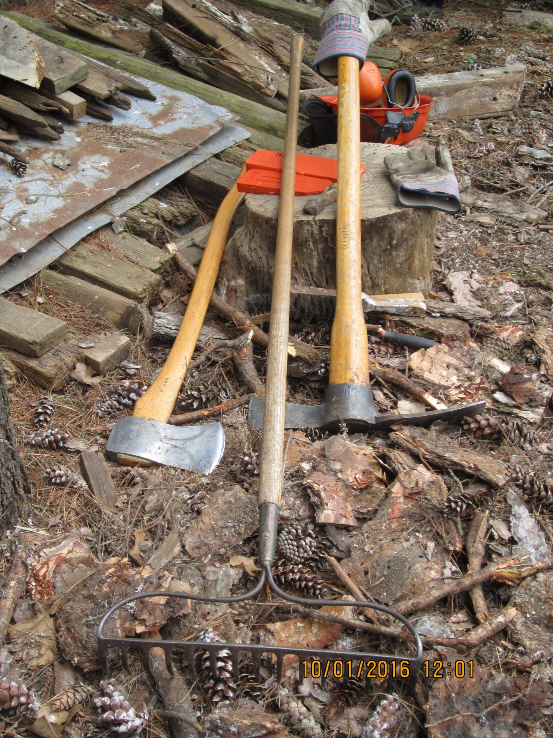

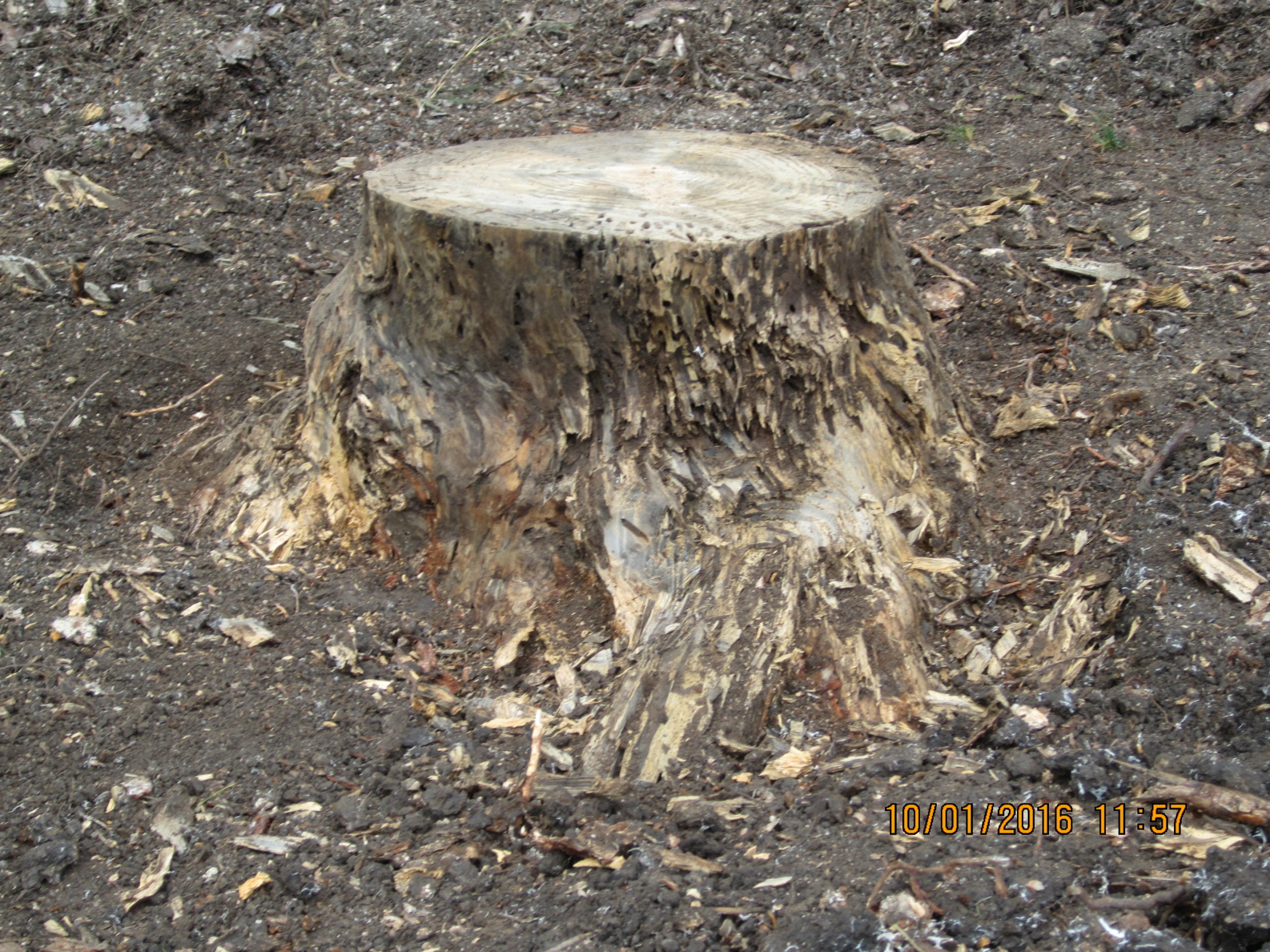

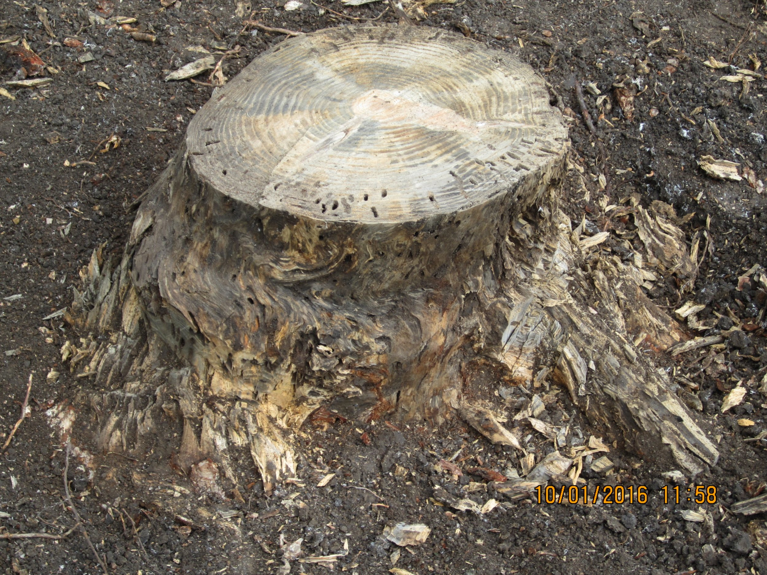

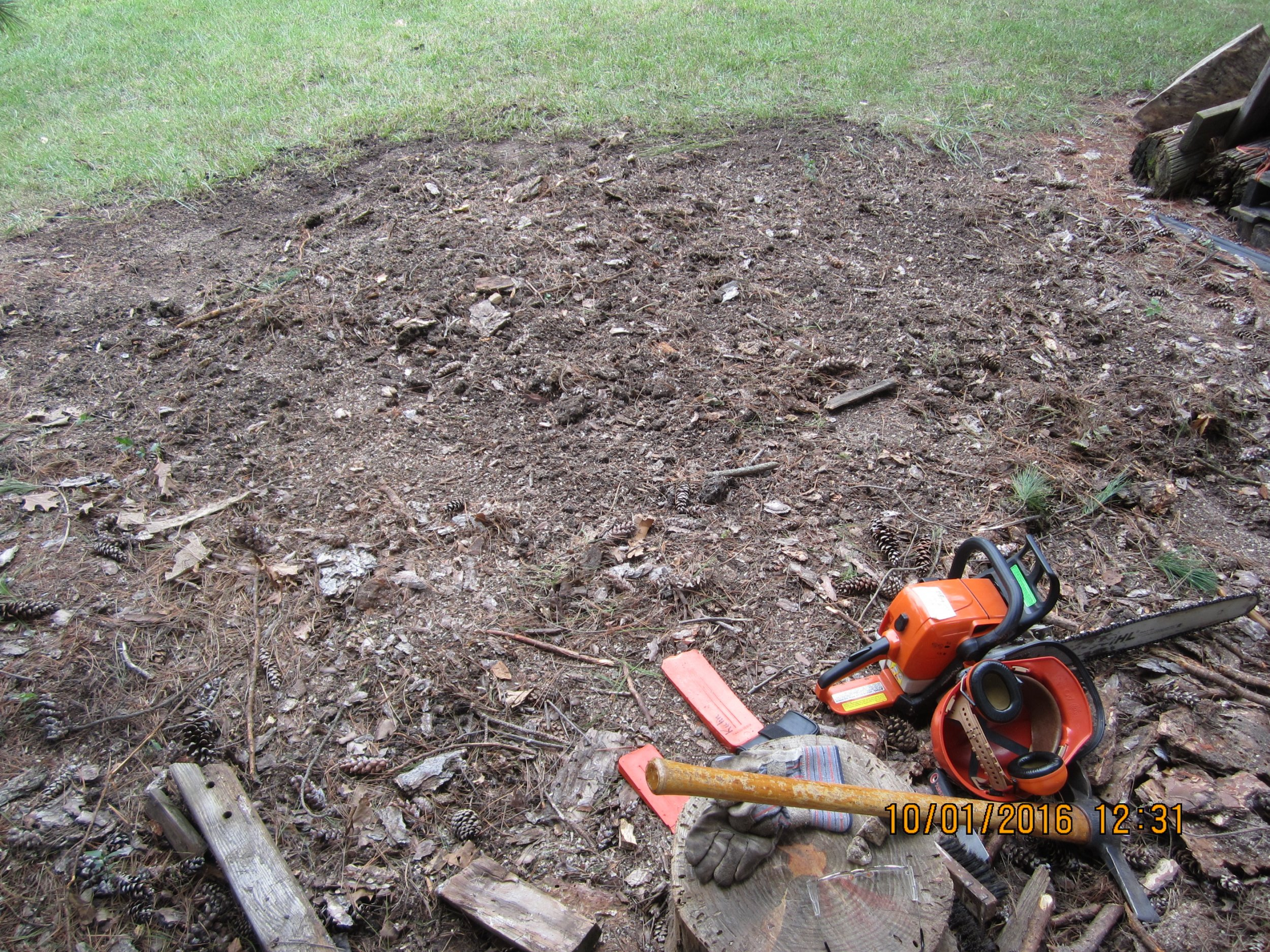

My wife is el cheapo. She says we can sharpen/replace chains on chain saw many times for price of a stump grinder. She's just digging around every stump and then cutting to ground level with the chain saw.

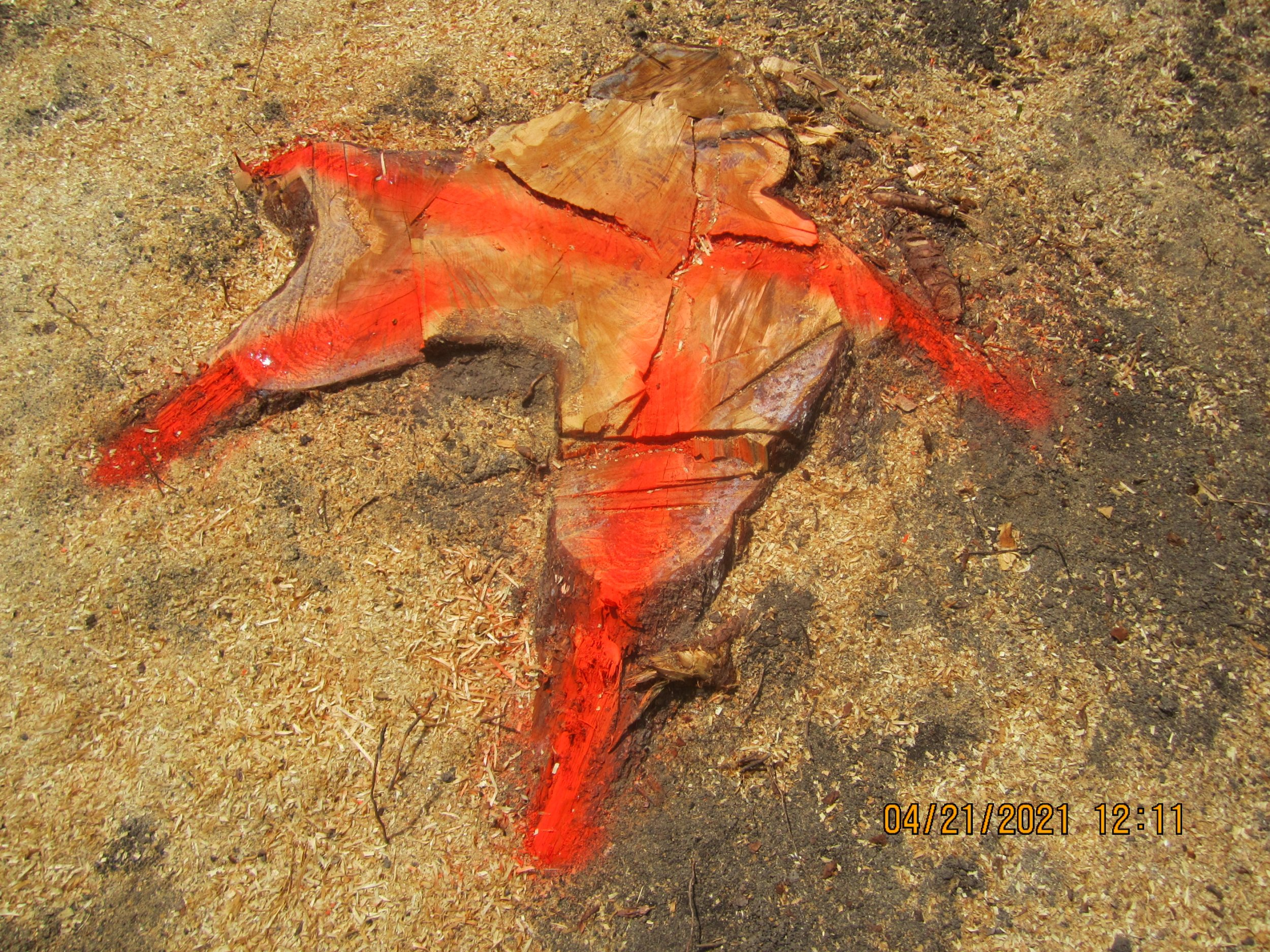

My WG24 is used on the B2620 with a Landpride QH15 (with bushings) and on the B2650 with the PAT"S easy hitch. Both have about 19 HP at the PTO. And both tractors perform well for me......just don't take too big a bite. So far I have ground over 30 stumps on my property and helped some neighbors too (for free). I use marking spray paint to highlight some stumps especially the lateral surface roots.
