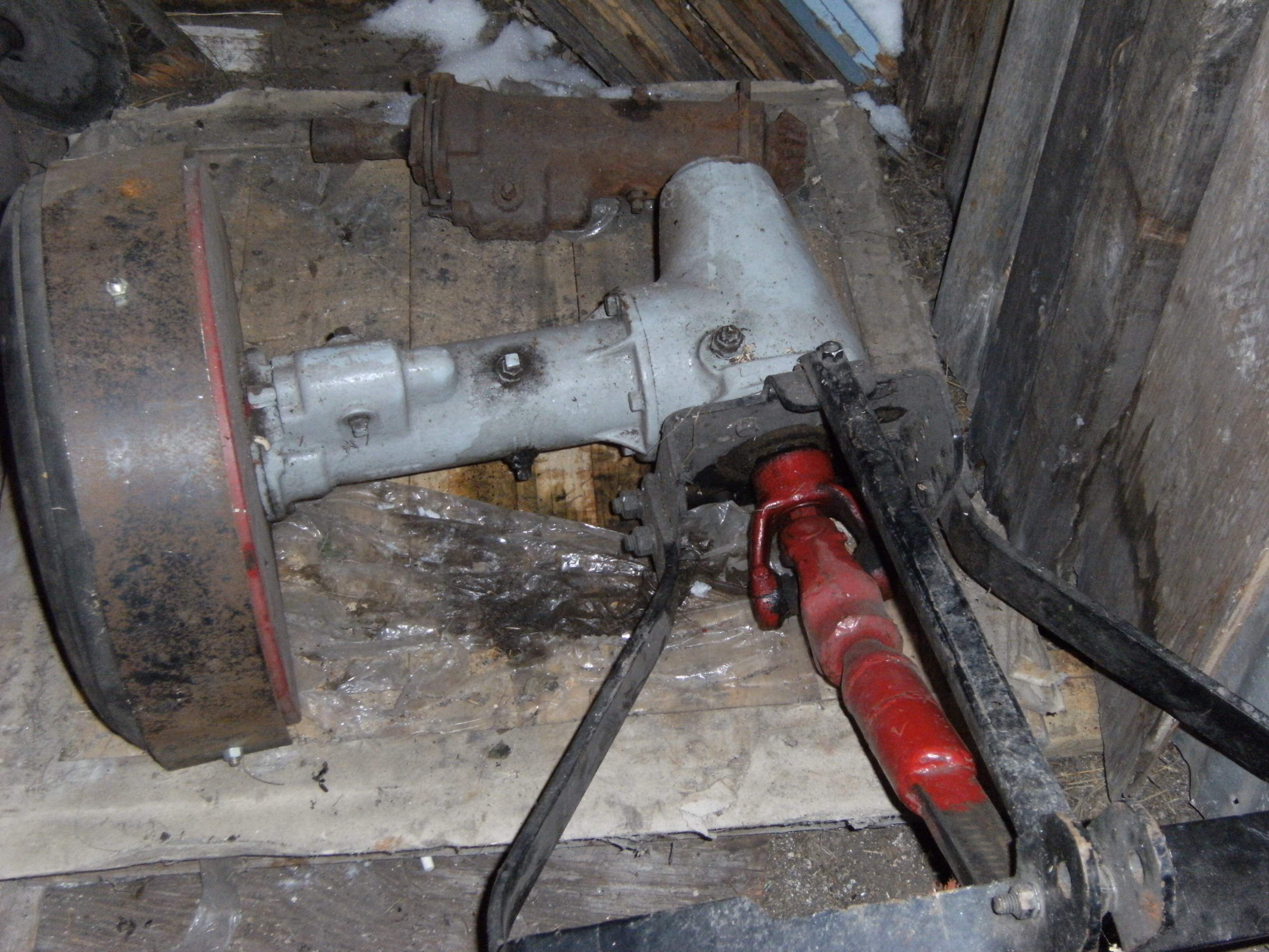

I've built one about 6-7 yrs ago.It's got a gear box off some sort of old implement,Not sure what it's off as my neighbour had it laying around and gave me a bunch of stuff when he was cleaning up his yard.Anyway I made it fit onto the back of my MF 1655 3 pth with pto rpm of 1800. I think it's about a 2-1 ratio so it whips the blade pretty good.For the bale I used one 3/8" x 12" round plate and one 1/4" x 12" round plate. I then sandwich 6 carbide lathe bits between the plate's. I need to use 3 right and 3 left bit's. Leave two straigth,bend two one way and two the other way. They are also not only sandwished between the two plates there also sandwiched between two 1/2" square rods on each side which keeps them in place,There's a 1/2" hole drill thu both plates and part way thu the bit as well like a notch in the bit to keep it from flying out. Have a guard build right around the wheel as well for protection. Have used it on hundreds of stumps over the yrs'. It's moved by tractor movement back and forth as well sideways and lower and raise on the 3pth. Going to change it this spring going to mount it onto the front my my MF gc2300 going to make a side shift so that all I'll need to do is move the tractor back or forth and use the side shift for side to side and with it being mounted on the front quick hitch that'll raise and lower it.I haven't any pictures of it but once it warms up and I get to it I'll start taking and posting.Larry:D

It wasn't to cold of a day so moved some stuff out of the way and took a couple pictures.This gear case as you can see I have a spare piece for it.Whats unique about this is that it has a over run clutch built right into it.If you look close near the guard you can see a rod sticking out that at one time must have had some kinda of linkage to shift it into netural of drive.I have the guard holding the shifter in gear all the time.But that doesn't affect the over run clutch so in away it's pretty good to have.I can idle the tractor right down and the over clutch takes over and lets the cutting wheel slow down on it's own,not affecting the tractor at all.No idea what this gear box was off[maybe some sort of old hay binder] all I know is that it works excelent.The person who had it before me had tried making a 3pth post hole auger.He had welded two different size fligthing onto each of the long pieces,I've cut them off and used one for the stump grinder.I do know when I put it onto the tractor[when it was still a auger] that thing turned like crazy.Bet thats why it was never used for post hole digging.It's something like 1 1/2 times faster on the output then the input shaft.So for a stump grinder it works just fine.Anyone have any idea as to what this gear box is off of??? It's got MH cast right into the cast housing.So its pretty heavy even with it grinding it doesn't bounce hardly at all.It's not something you want to try and lift and put into the truck to often. Sorry about not showing the wheel and teeth but you can't really see them with the guard in place I used a old air plane tire for the side guard its sandwiched between 2 plates of 1/8" steel.Don't want anything flying out and hitting me the operator while it's being used.Using the tire allows the wheel to be completely covered in from the side yet still flexable to give and be out of the way while grinding.Haven't had any problems.Had to change the teeth only once since making it.I have lots of stones etc: and sometimes the stump is grown into a stone so all in all I'd say its stood up pretty good.By the way its ground out 200 plus stumps over the last few years,now its getting used less as I only need to grind out stumps when we lose tree's. Larry

Massey Driver,
Thank you for taking the extra effort to post pictures of your machine.
It is not quite what I expected, but it sounds like quite a unit. Especially after chewing up over 200 tree stumps.
