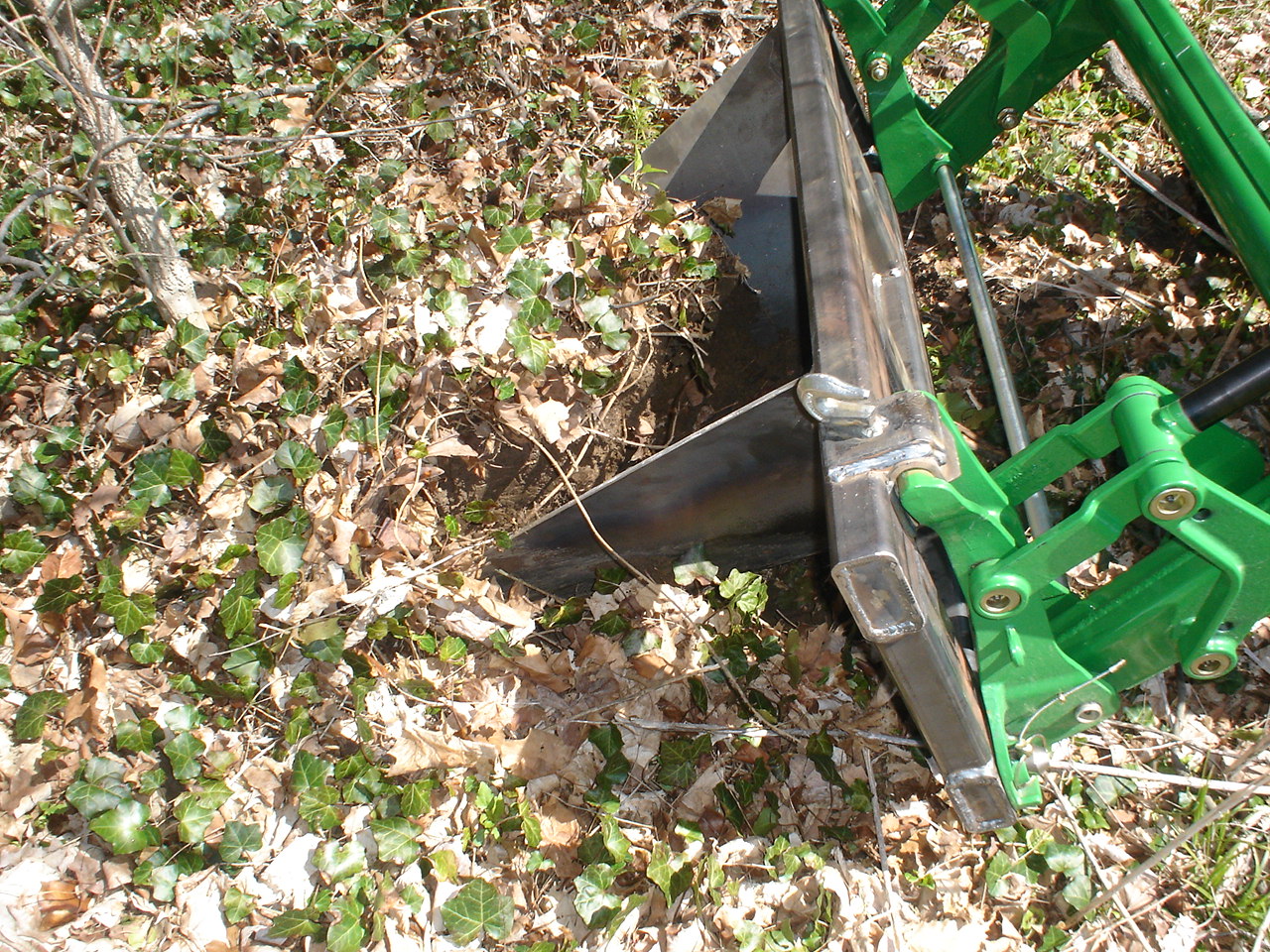

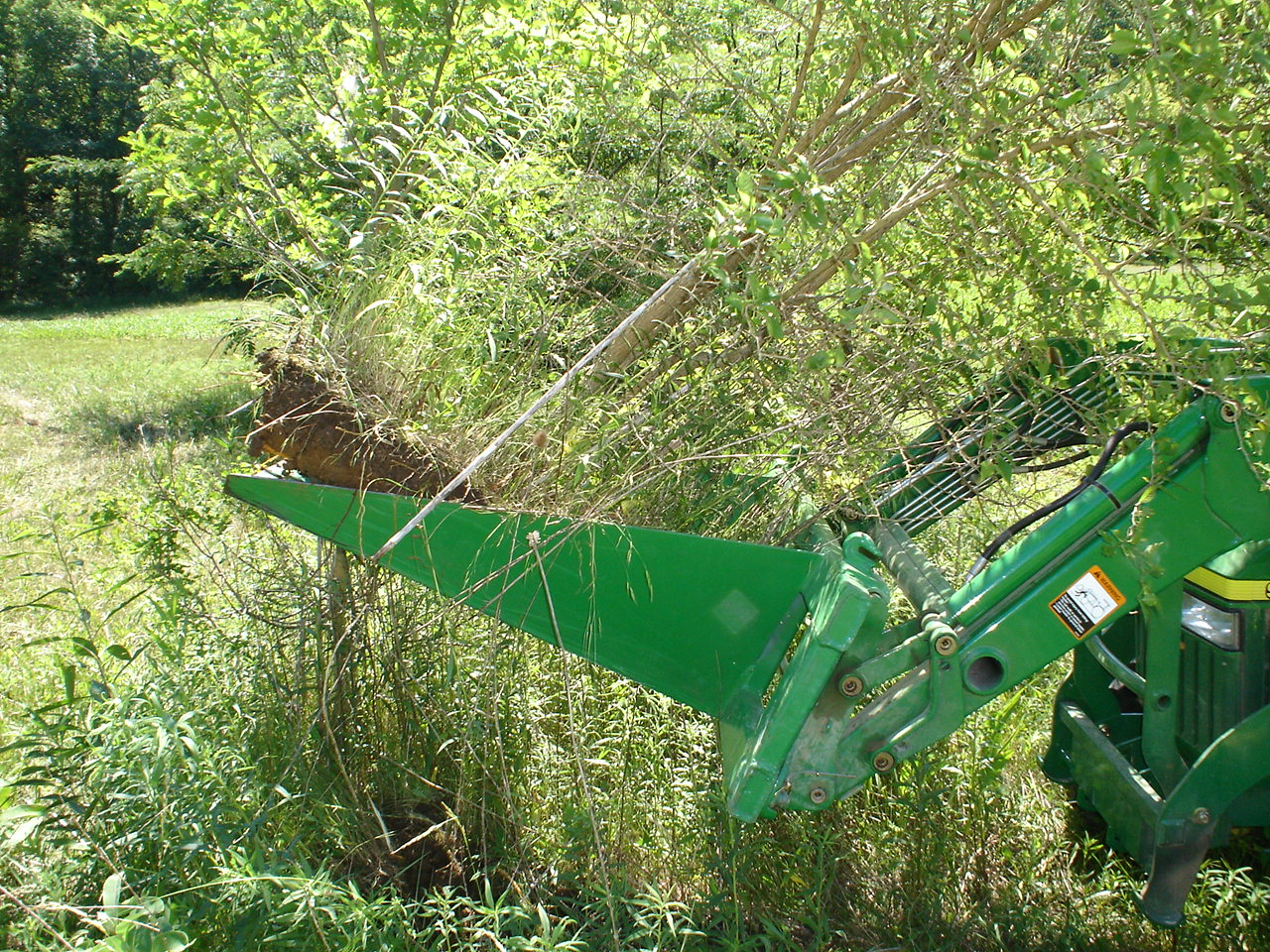

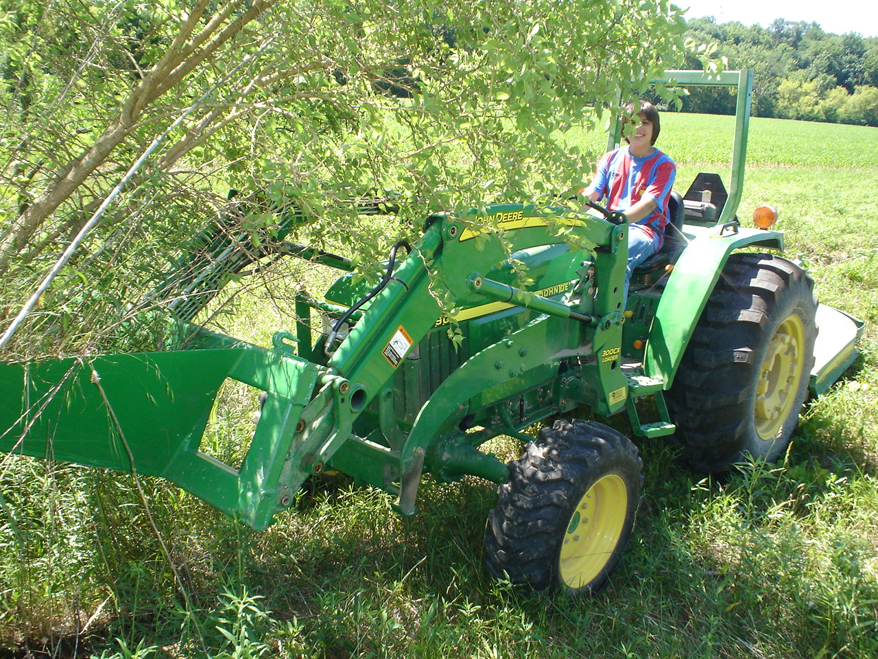

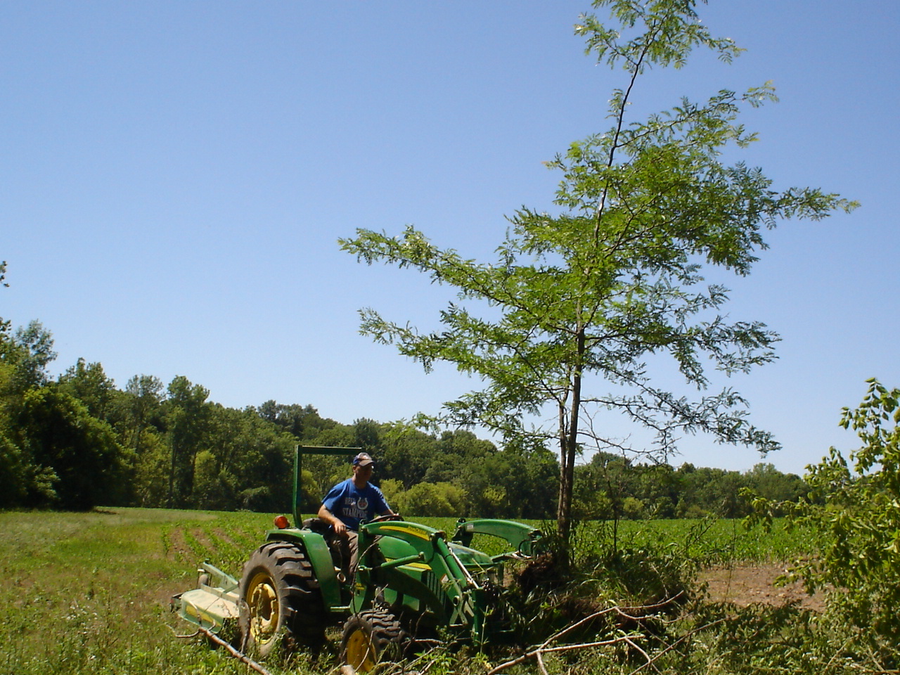

Here's some pic's of my stump bucket......using it to remove some thorney Locust trees.

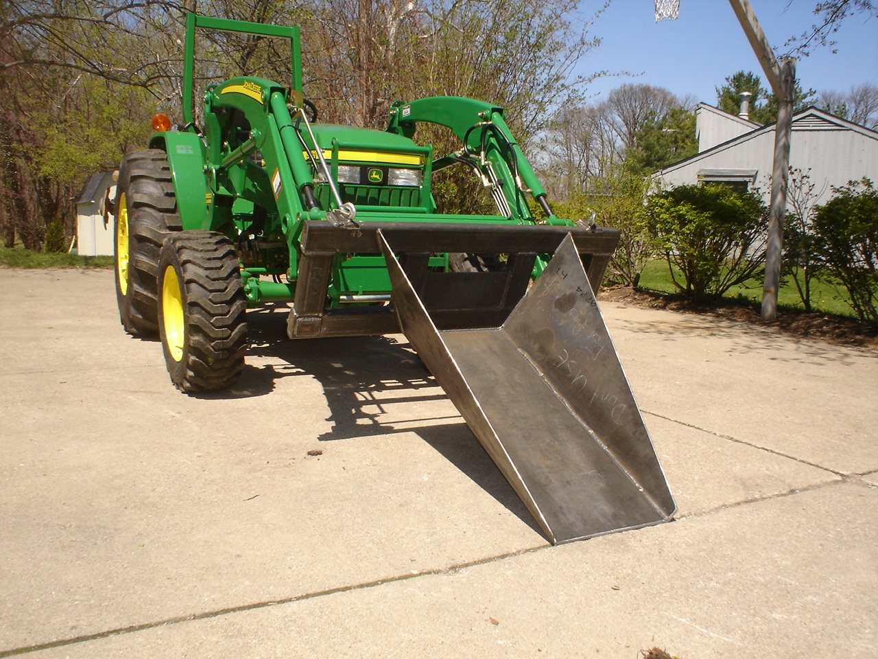

And some more pics...... and the design file for how it was built. I am still debating whether to add teeth to the bucket or not.

I like the shape. I would be most concerned about those unreinforced top edges. Perhaps you have favorable soil and work conditions that spare the stress I would expect sometimes.
I was looking at your loader in the pics. It looks as tho the curl cyls are as big as the lifters. Is that a fact??
larry
   / Stump Bucket? #15
I haven't had to worry about the stress on the sides due to how I use the bucket. I always plunge it straight (forward) into the ground to avoid side loading those members and prefer a shallow cutting and slicing action versus the backhoe digging approach. On most of the trees I've ended up using the curl while nugging the tractor forward to lift and cut at the same time. On long tap root trees I end up slicing the root off below grade then lifting - on shallow roots they're pulled up with the whole trunk.
Can't really say if the curl cylinders are exactly the same size as the lifters but they're really close. The JD990 is perfect for me.

I've already transplanted a couple of cedars on my property line. Only difference is for those I made a deeper cuts from 3 sides of the tree prior to taking the lift/plunge approach so that I could also get a decent sized root ball. For straight removal I was only hitting the tree from one side and not worrying about damage to roots or taking a large amount of dirt with it.
And don't forget to dig the receiving hole FIRST! Lesson learned here after I got the first one out and had no place to drop it other than on the ground so I could dig the new hole - dumb huh?

I noticed you welded chain hooks to the bucket edges. That's a useful feature. I also welded a chain hook on mine...in the center. It helps at times to use a chain when doing a removal.
