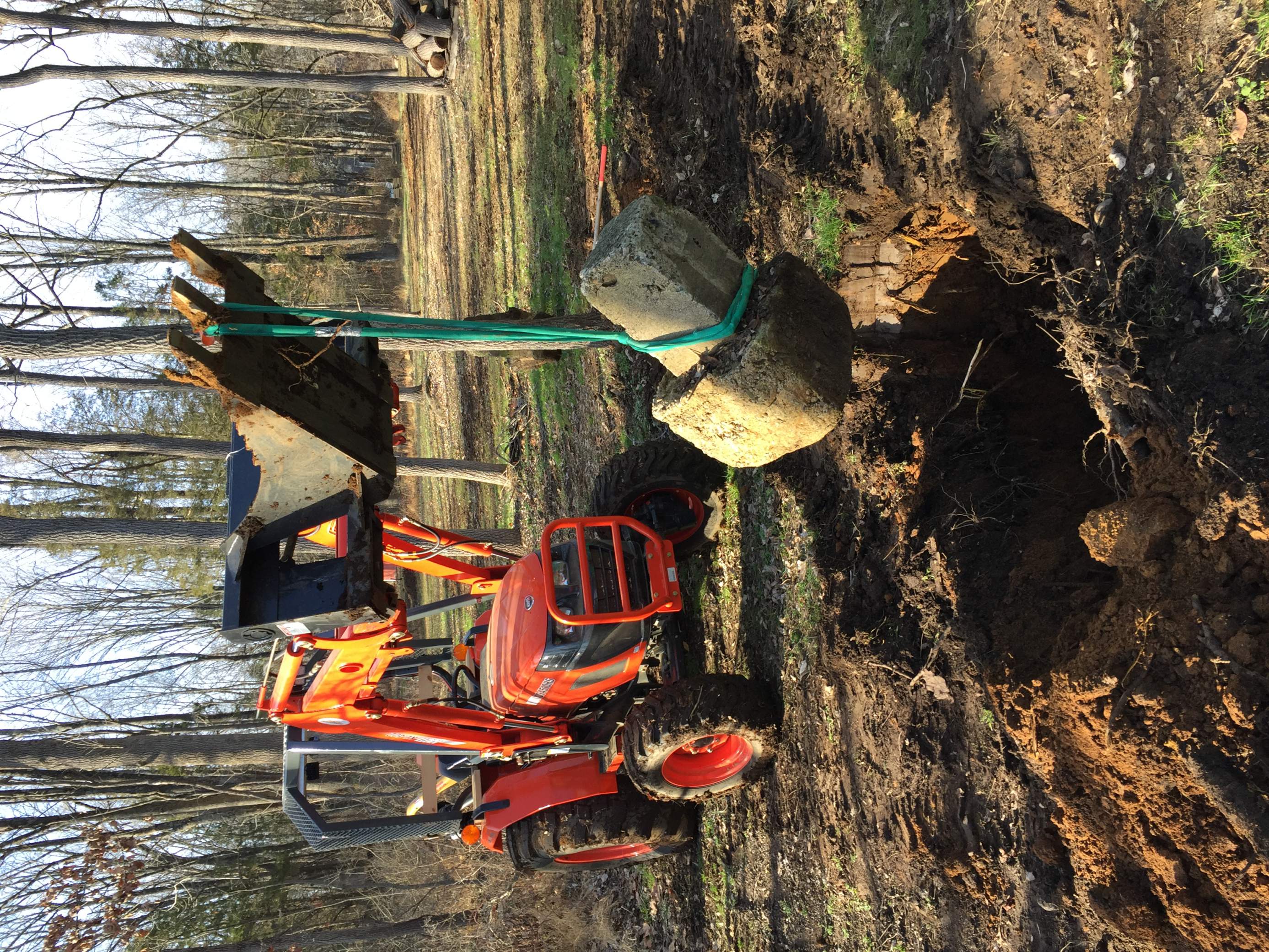

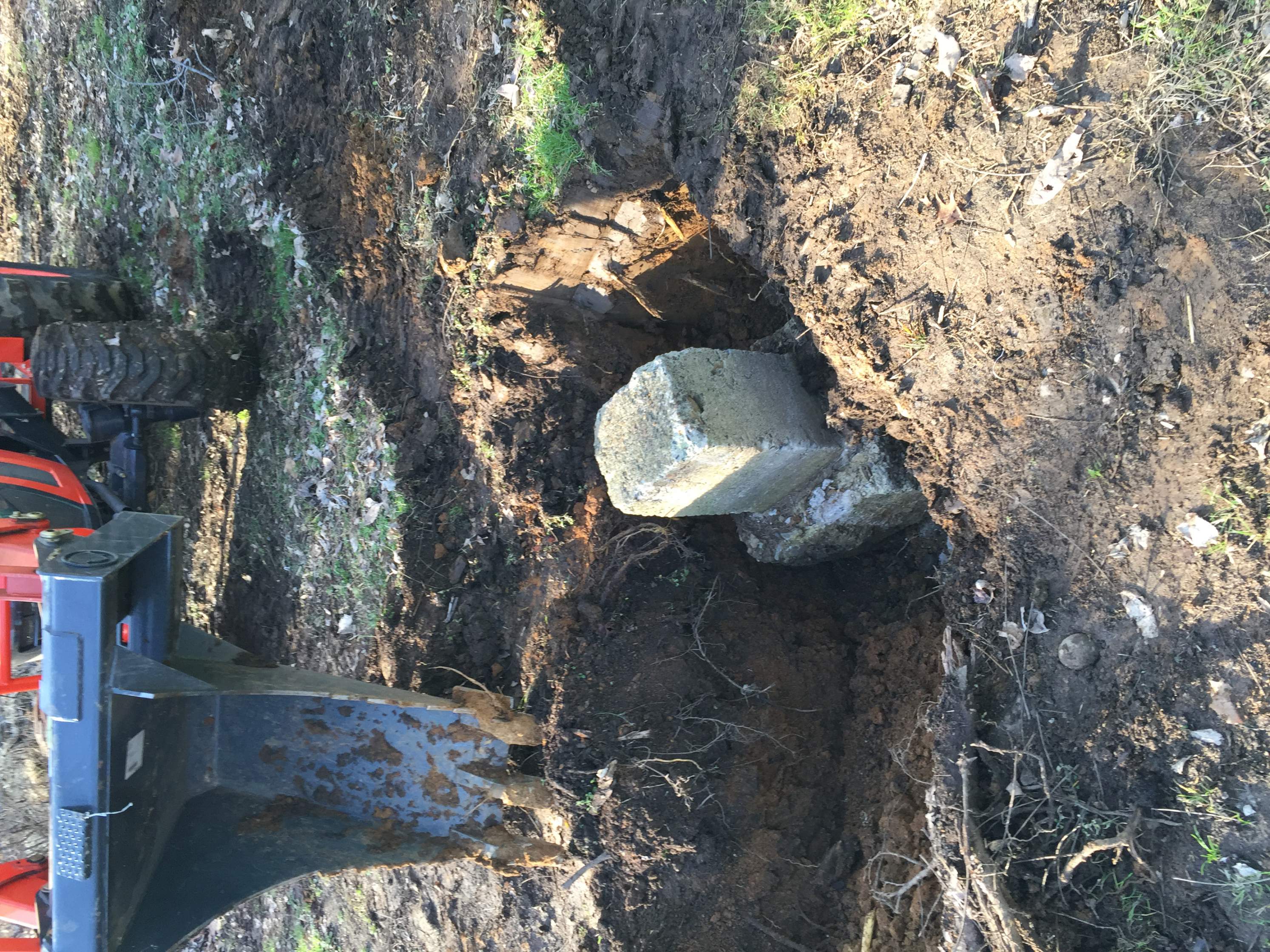

Found a use for the old barn footer/piers that I dug up previously. Stump bucket efficiently dug 36" holes and dropped in the old piers to support the post for the shed roof that I'm adding to the barn.
