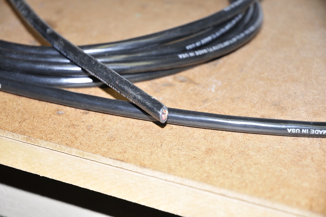

I used heavy duty trailer wire for my runs underneath the tractor. It was nice because there are 4 wires inside the single strand. I used 2 wires for the power, and the other for the sync and mode switching. I soldered & shrink-tubed all connections. There was one major "gotcha" that I ran into where i was kicking myself tho. As i said, the strobes have 2 extra wires. 1 serves as a sync wire so that all the flashes will be synchronized. The other serves as a mode change so that you can switch between various flash patterns. I had gotten all my wires ran and all connections made however I had forgotten to get the modes set between each light so that they were all on the same flash pattern together!!! So when pressing the mode change button, they would all advance to the next pattern, but not the same one. This meant that I had to undo my connections that I had just got done soldering and shrinking in order to disconnect 1 light and advance thru the patterns on the other until they were on same one. So moral of the story- before you even install them, hook them up to a 12v source and get them all on the same pattern first! You may also notice in the video that the front and back lights are not sync'd with each other. I didn't bother with that, as I figured as long as each pair was in sync that was fine. However, be careful to make sure that all 4 strobes are on same mode!

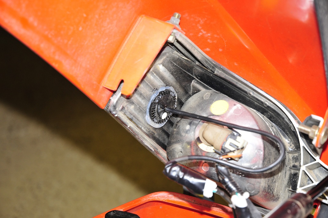

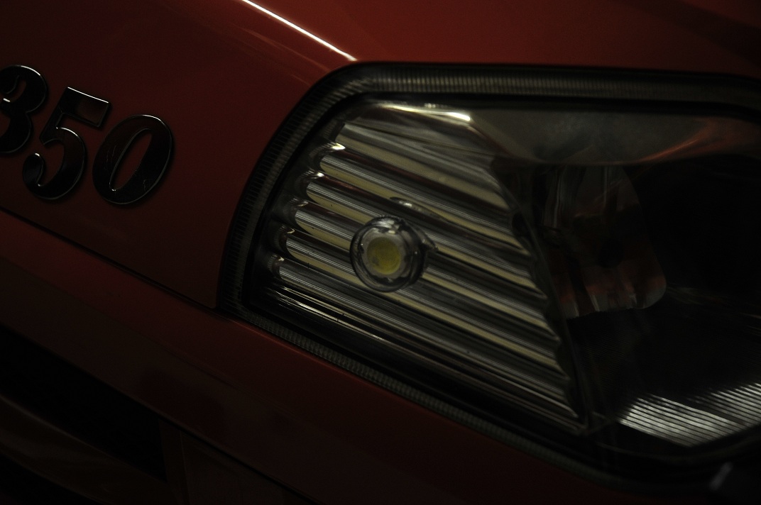

I finished my beer, so i have no fear, so I just used a 1" wood bit and drilled into and open area behind each light. On the headlights, i ended up with a bunch of black plastic shavings inside the lens. I used an air hose & nozzle to blow them out. It took a minute or two to get them all out. Here are a couple of pictures that give you an idea how they mount.

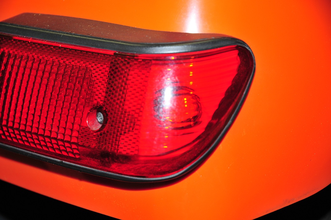

I used silicon adhesive around the bezel of each strobe and simply pressed them thru the hole i drilled. The taillight was easy as the entire lens assy comes right off the tractor. So I drilled thru the fender making sure i was lined up properly so the hole would be in the right place under the lens. Under the hood, I tried to be mindful of where to best run the wire so that it would be protected from heat and I used this 16ga bundled 4-wire which was probably overkill:

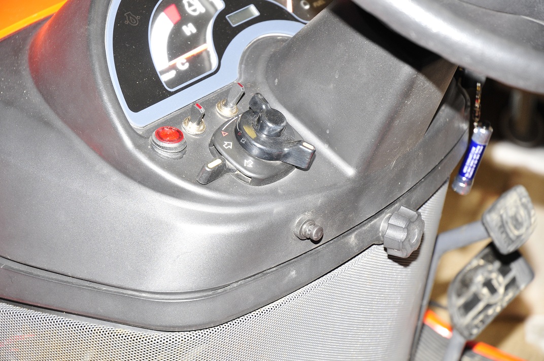

_KMH4239.JPG It took me awhile to figure out the best way to mount the toggle switches so that they were easy to access from behind the dash. Also they are lighted toggles which is nice. I think i bought the round one from TractorSupply but it could have been RadioShack._KMH4238.JPG
Notice in the picture there is a black push button by itself.. I use this for switching between strobe modes. I think i got it from TSC.
