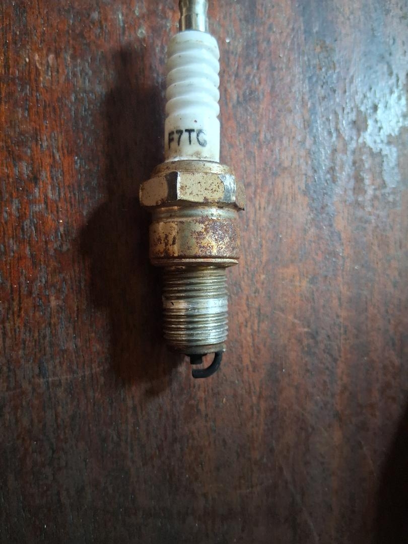

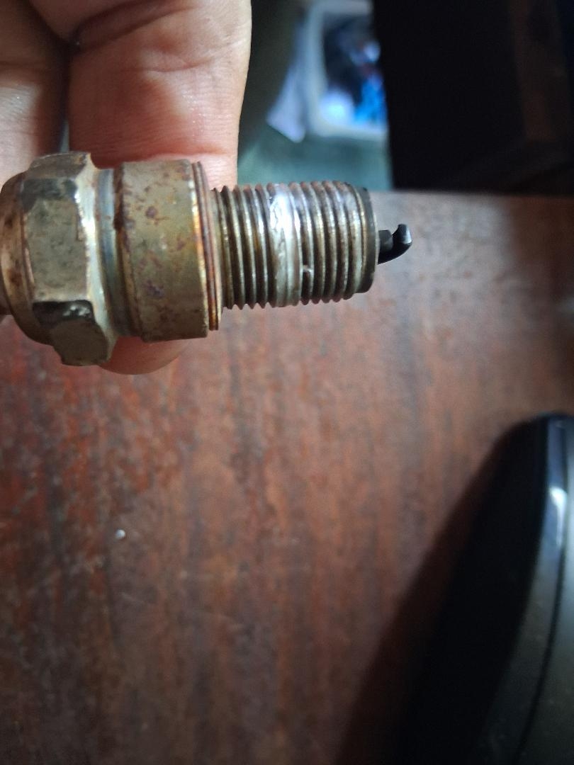

Removed this plug and found this, going to chase it with 14mm tool, does this look that bad? Looks like I can save it without using helicoil.
Kohler 25hp twin, sux because I just took them out last week and it was fine, wtf?
Replacing with Champion 71/RC12YC

Always apply a small amount of never sieze to the plug threada no matter what engine they go in..Prpblem with chasing the threads with the head installed is you will get swarf in the combustion chamber and that is not a good thing.
/ Strip spark plug #3
I never use anti-seize on spark plugs, and never will. If you feel the need, make sure you compensate on torque values, and make sure it’s an electrically conductive version
/ Strip spark plug #5
It it is damaged beyond use the threaded inserts (not a helicoil) work pretty well.
/ Strip spark plug #6
I always find warming the motor up before a plug change helps. You can use a penetrant, make sure around the area is clean before you pull the plug . The biggest thing is do NOT over tighten then . Also check your gap. I personally wouldn’t use champion , but that’s a personal preference.

Thats aluminum right?
Take a new or unaffected plug and see if it will thread in by hand at least a thread or two. If you get resistance wiggle it a little and see if that will allow a good start and/or a little more progress. If you are successful in getting a couple turns by hand it is threading correctly. Take it out and do it again. Same? Good.
Now remove it and clean everything -- WD40 and airblast. Apply anti seize to the plug and try it again. Same or better? Good. Put a little anti seize at the head thread entrance and redo hand threading. Maybe turn it with a wrench another turn. Remove and repeat. It should feel better and go further. At that point you could probably just screw it on in.
I intentionally avoid chasing because a full thread will find its correct registration better vs a tap accidentally cutting a new registration. Also a tap, even starting right, will remove some aluminum material that is still useful. Whereas the steel plug thread with antiseize will just form it back into position.

All you have to do to chase those threads is put some good old axle grease on your tap - and even if you were to get a tiny bit of aluminum in the cylinder, it will be gone quickly right out the exhaust valve.
Many years ago I bought a 1962 Olds F85 with the all aluminum 215 c.i. V8 for $25 because it had a rear stripped spark plug hole. It used the conventional 14mm plug like most GM. I took an 18mm tap, greased it up good and re-tapped the hole to accept the 18mm plug that Ford used in so many of their engines of the time and drove that car for the next many years before selling it.
I ALWAYS put a little anti-seize on spark plug threads, helps avoid gaulding like you have there on that spark plug.

Looks like you over torqued them two weeks ago.
The remedies or a combination of them suggested should work for you.
Stuff like this is what mechanics not parts changers do.
/ Strip spark plug #10
People always tend to over torque spark plugs and install them with dry threads which is an invitation to galling or cross threading.
If the spark plug has a crush washer on it, 1/2 turn past contact is always enough and if it's a tapered seat, that also applies but again always use never sieze on any plug, not a lot, just a bit on the end of the threaded portion as the end of the treaded portion will distribute the never sieze as you screw it in. Makes removal much easier as well. I've never stripped threads in a spark plug hole in my life and I'm 76 years old.

Particularly necessary in aluminum heads. The Al/Fe differential expansion "works" the joint. A little piece of aluminum cracks loose from fatigue and follows the plug out, mashing and galling as it goes. Copper bearing antiseize is the best insurance I know of to prevent any Al from bonding to the plug.
/ Strip spark plug #13
Repaired dozens of stripped sparkplug hole threads back in the 1970's while working at an independent Volkswagen repair shop. First you need to set the piston and valve timing so that the exhaust valve is open and the piston is below where the thread repair tool can reach. You sometime can just run a sparkplug thread chaser tool down the threads and clean them up. Blow compressed air into the sparkplug hole. This will make any aluminum fines go out pass the open exhaust valve. I also second the use of grease to collect the thread shavings, although it can interfere with the Time-Sert installation. Sometimes this works finds and sometimes the sparkplug will blowout after a time. Then you have to use the new thread cutter tap and the new full Time-Sert installation. We used to red Loctite the new Time-Sert into the freshly cut new aluminum threads so it would never come out upon next spark plug change.
When replacing sparkplugs, I put a bit of oil or grease on the threads. Even though it will cook off it still creates an interface between the metals which resists them seizing together. I think the older school lead anti seize is a good idea also. I had read that anti seize can cause the spark plug to run hotter. Never saw any real data on that with before and after temperature reading.

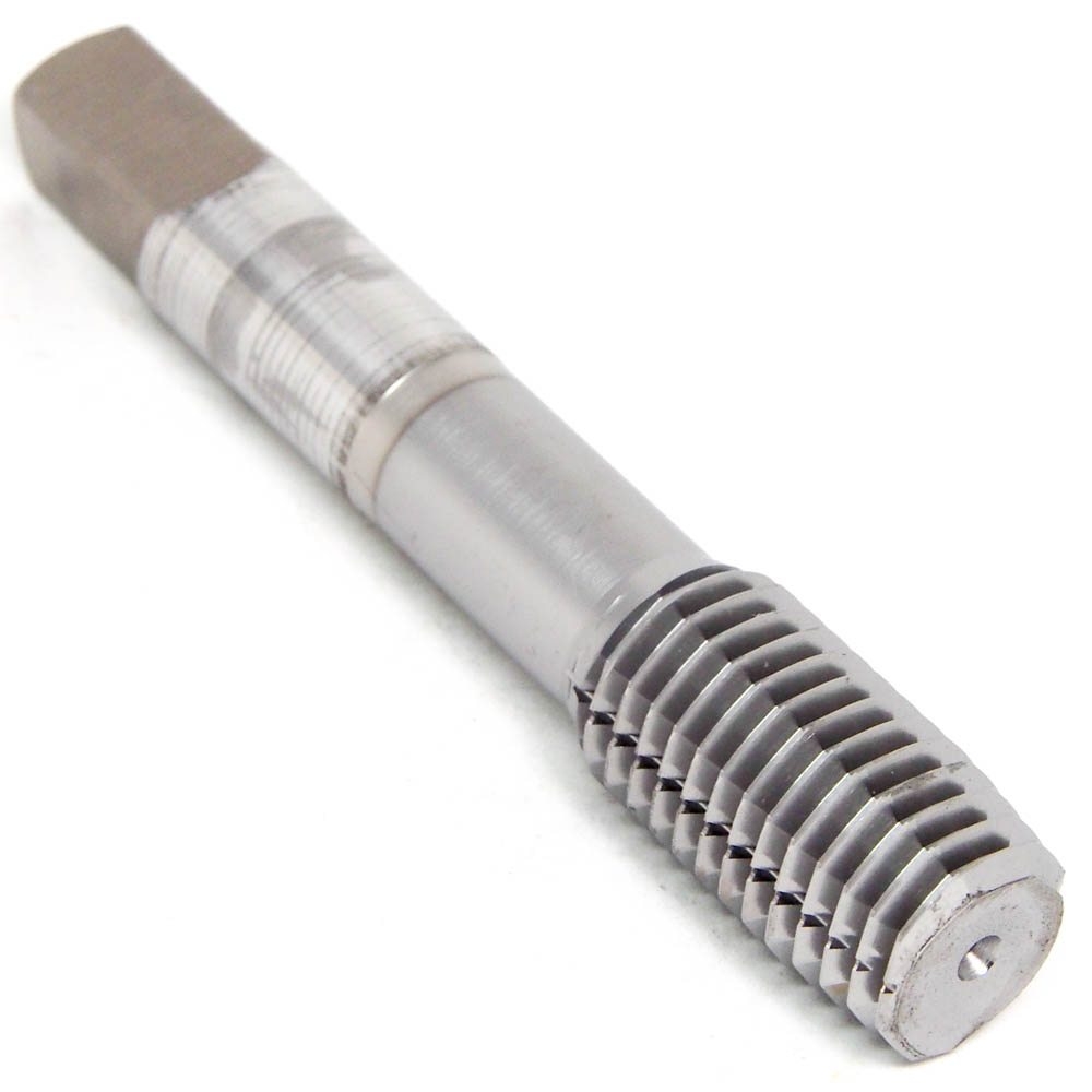

DO NOT use a standard cutting tap! Instead use a thread-forming plug tap with an appropriate lubricant. It does not cut, but instead reforms the threads to original. These taps have 4-6 rounded corners instead of being exactly round.
I've always wanted a set of thread forming taps - SAE and metric. Not necessarily for new threads but for chasing.

There are several designs, be sure to buy a set like the picture. You can feel the "corners" on them. Some have a straight cut in them, which can cut misshapen threads away.
