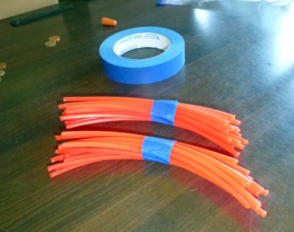

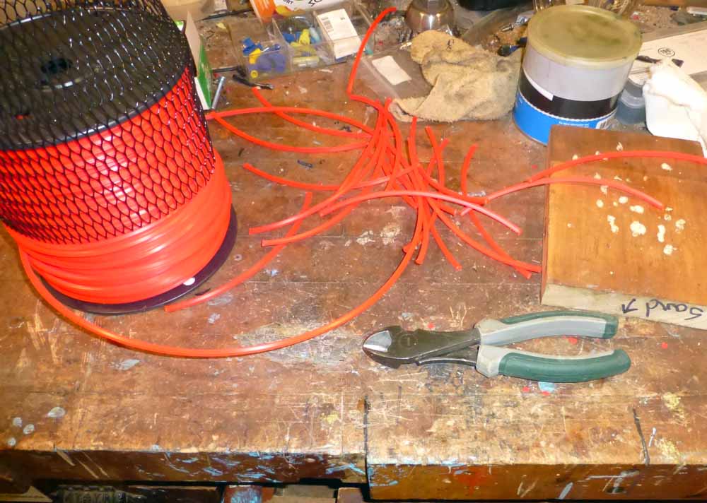

Maybe you know this but the larger string is not reel loaded. Its to stiff for that and requires a cam-lock head that holds onto individual pieces of string. There are other heads that aren't cam-lock but we found them to be worthless.
Ooopps! I sure didn't know that a cam-lock head was required. I doubt that'll be available for the little Husqvarna 128LD, but I'll check. If not available, it's probably for a good reason. Thanks for the heads-up.
   / String Trimmer Tricks? #35
The cam-lock heads used to be made by Oregon and came with universal parts to supposedly fit anything. They might still make them today. The good thing about these heads is you cut your string as long as you like. But the longer they are, they'll slow down your head speed and not cut worth a hoot. There used to be 2 string versions but I'm not sure if they are available more.
Today Stihl and Echo make a version of cam-lock heads but I'd guess that other manufacturers are offering them.

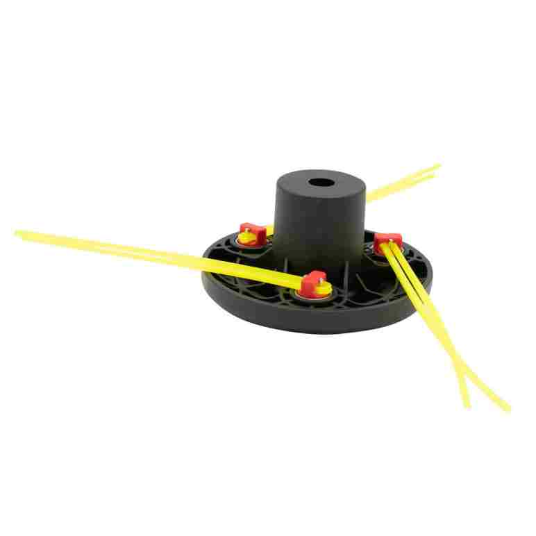

First thing I do when ever i get a new trimmer, is swap out the bump feed head for a fixed line head. Much more versatile. For light duty, you can put in long thin line. For thick areas you can put in shorter thick line or even line with a wire center. The tall grass wrapping issue, as other's have mentioned, is really a matter of technique. Start at the top and work down. For the grass to wrap, it needs to be at least 7 inches. So make each sweep 6 inches from the top so that no strand is long enough to wrap. For truly difficult patches, such as Blackberry, I have found no commercially available blades or heads that work, so I created my own design, which I will not share here, since its somewhat unsafe unless you're wearing heavy duty protective gear and can guarantee no other people are around. As to the fixed line heads, I'm liking this design.

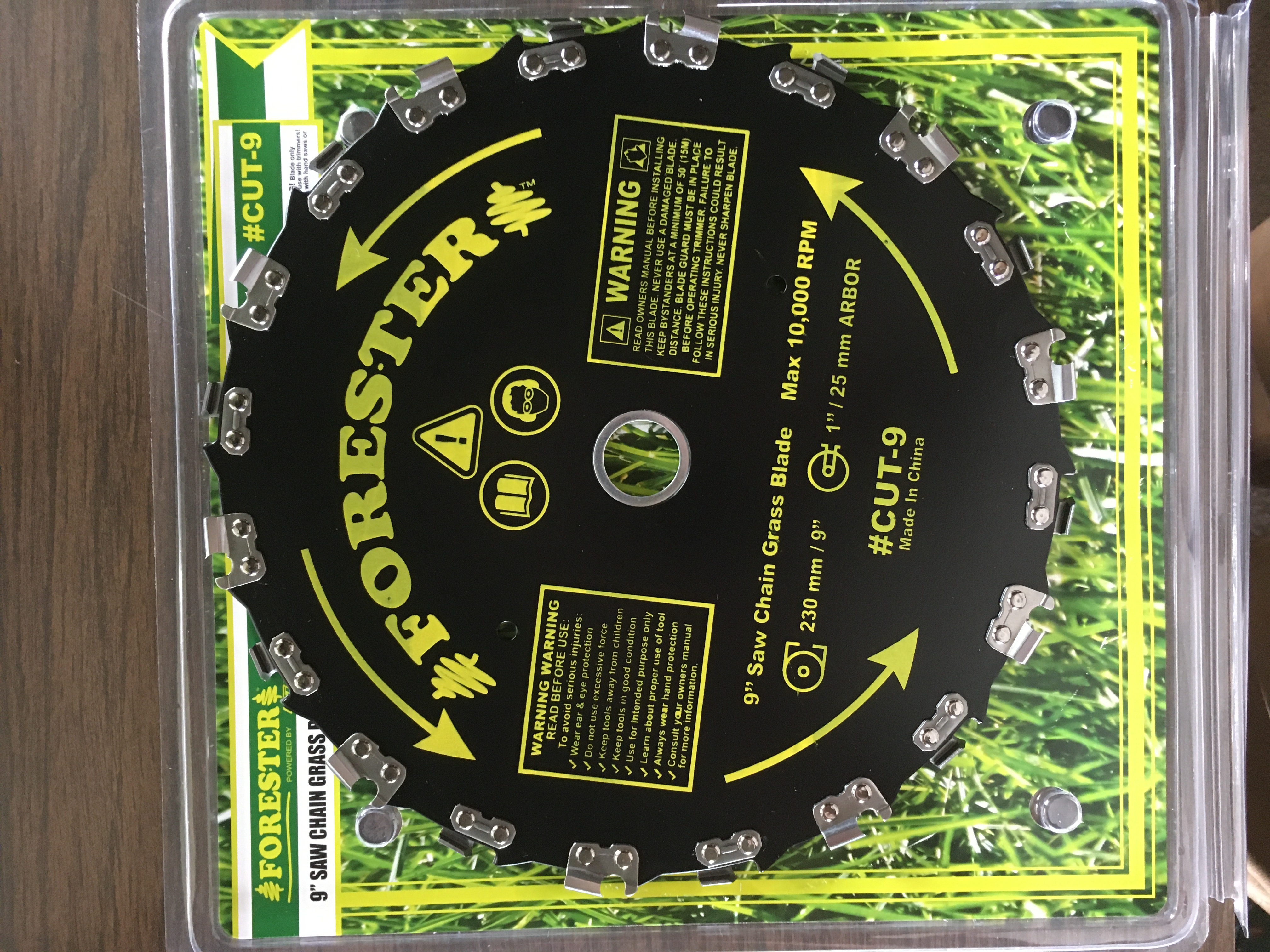

I plan to try this out real soon.
Got one with my Stihl new and it wasn't made in China either. German manufacture. I used it a couple times to remove saplings. Thats it. Just remember, they don't work with anything but a straight, solid drive shaft trimmer. One of those trimmers with the wire driveshaft will unwind inside. Cannot take the torque load.
   / String Trimmer Tricks? #39
Thanks for the reminder. I’ve got a Stihl that will run it. I’m interested in the blade you have and what brand it is.
Very first trimmer I bought over 30 years ago was a straight shaft. Wasn’t long until I had a saw tooth blade on it cutting saplings on a lot i was reworking for rental mobile home spaces. My brother chided me into getting this blade but I’m always looking.
   / String Trimmer Tricks? #40
Did you learn that the hard way? I imagine that a blade like that would impart significant shock-loads to the cable as well. Makes sense
that the cable can not take it. The ring/pinion gears on a straight-shaft trimmer may not last, either.
