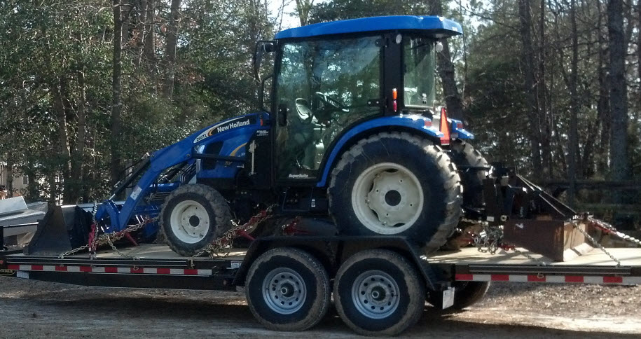

As promised, here are some photos, (if the link works) of the secured tractor. I took all the advice and combined it the best I could, the only thing I wasn't able to do was cross the chains, this was simply due to the configuration of the trailer and tractor combined, and the implements on it. However, I was able to get my hands on some 1 3/4" old fire hose and lined the chains. I also purchase grade 70 chains and ratcheting chain binders, with folding handles. These binders where very easy to use and were rated at 7100 Lbs. Finally, to secure any additional chain (20 foot 5/16") from falling off the trailer and dragging about the road, I purchased some heavy duty zip ties and just zipped the chain to itself.

IMHO, by looking at your photo's, I would shift the tractor a little more towards the front of the trailer to transfer a little more weight to the tongue, it looks like it may be a little "tail heavy" which could lead to handling problems while on the road.

Those jack stands would not fly around here. Have you tried backing the tractor on?

Jack stands have to go. Also your strap over the loader will chaff and break around the sharp edge of the bucket. I never run an unprotected strap around anything not round. The wind buffeting the straps and the road vibrations will cut a strap very quickly. Just trying to save you some money.

anythin i have with sharp angles or corners gets a piece of old carped as a buffer.. or run thru old fire hose. ( i use that for chain.. etc... protects paint. the carpet is for straps.. etc.

I'll third the comment about straps and cuts on sharp corners. I cut one fairly deep once on a very short drive. Lesson learned.

Sit the front bucket down flat and chain off of the brush guard going forward over the bucket and you won't need the strap on the bucket. The chains will hold the bucket and the tractor.
I might would consider chaining or strapping the BH bucket down rather than forward. Not sure it would be any more stable though.

+1 on the tongue weight. I drive mine forward on the trailer until the rear of my truck drops at least 2-3". If you don't have tongue weight, the trailer will drive you and accidents become more and more likely. You will be very jack-knife proned. My loader bucket is usually completely forward of the squared off section, basically overhanging 2' of the tongue to where I have to watch how sharp I turn the trailer to avoid hitting my truck tailgate with the bucket. I have a 16' bed on my trailer and probably 4 or 5' of tongue to the ball. I usually have a box blade or tiller on the rear, not a backhoe, which is much heavier, so your weight should probably be even more forward than mine.
Your tie downs look good. With my loader bucket forward of the front bar, my chains never interfere with my loader. I seriously want a 20' foot trailer to have more room to do it right, but I'm well under my weight limit and have never had to turn so sharp as to put a loader tooth into my tailgate yet; just not ideal.
You may want to hook the trailer to your truck and then load the tractor both forward and backward to see what gives you the best combination of tongue weight and situation on the trailer space.
