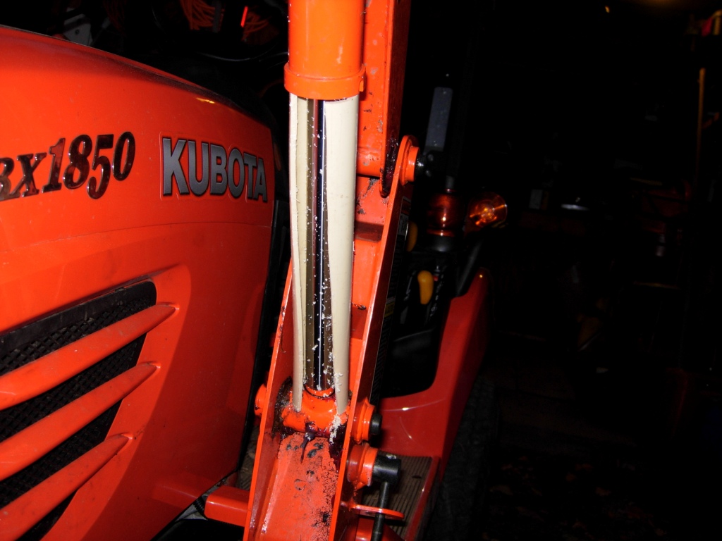

I just mounted the Kubota ballast box to my BX1850. The tractor shed is just shy of 12 feet long. With the Ballast Box installed the only way to fit the tractor all the way in is to raise the bucket almost all the way to the roof.
In the past when I had to do this I placed a 4x4 post cut just the right, length under the bucket, in case it leaked down.
I mentioned this to a friend and when he is working under anything with a hydraulic cylinder he will place a large piece of angle iron wrapped with duct tape on top of the exposed cylinder, so it cannot close down on him.
I liked the idea but I had no angle iron around. Instead I used a couple of pieces of Schedule 40 PVC pipe. I cut out a piece of the pipe lengthwise about an one and one half inches thick. These I can slide over the cylinder rods to keep the loader from lowering as the fluid leaks down.
I am concerned that the pipe is not strong enough. Especially when it goes down to minus 20 F. I did install them and then put the loader valve in float position. It seems to hold things up OK. I will probably try this overnight but with the tractor outside so there is not an accident if the pipes fail.
Do any of you have an opinion on how strong this PVC set-up is? Does anyone else have a suggestion on a light weight way to hold the loader up from the cylinder?

I notice that tractor dealers and repair garages often park units with loaders up high. For smaller machines I think your sched 40 pvc pipe crutches are a good idea. I'd leave the valve in the center position - so if they fail the bucket won't move down quickly - it will just revert to leaking down slowly as it did without them. They probably won't fail - they may get brittle when cold - but not weak. More likely they'll bow or bend in hot weather. Of course if there's any chance of children being around the tractor the safest place for the FEL and 3ph attachments is usually flat on the ground.

Scott, It's probably as strong as a new born kitten.
At -20 the PVC will get VERY brittle and will shatter. The shards can be painful if they hit you and expensive if they hit something else.
I would go to the store and get the angle iron. Actually, I would park where the bucket dropping wouldn't harm anything. Better would be parking with the bucket on the ground. Especially if you have any little ones that like to play farmer. Tractors are "attractive nuisances" like a pool.

I couldn't/wouldn't trust plastic either-I would always doubt it and it would bud the crap out of me.
Get the angle iron and use zip ties to hold it on-you will sleep better.

I use angle iron and have a couple of lengths cut for various situations. I personally would have very little confidence in the PVC.
Once I place the angle iron on the exposed ram, I turn off the engine and very slowly lower the loader until it fully contacts and is supported by it. Same concept built into skid loaders - at least Gehl.

How about some steel sch 40 pipe and cut it similiar to the PVC pipe? Thats should work,If needed make the legnth cuts with a metal cutting wheel and circular saw. Wal Mart has the wheels for around 5 dollars .

We use angle iron and a hose clamp in the shop. There is almost never a time when you won't see a tractor setup like this.
