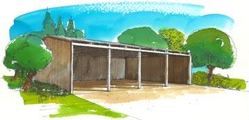

I have just traded my L2850 for a new L5030 and purchased several new attachments. I wanted to take better care of attachments this time as they are now all new and top of the line HD models.
Question: What kind of ideas are out their for storing them?
The tractor will stay in the barn and so will the backhoe attachment, but I have a 6' BH, 90"FM, 6' BB, 6' Scrape Blade, Wood Chipper, Fertilizer Spreader, and 6' Grapple. I really don't want to put these out in the open and let the weeds grow up through them. I was thinking about a small low pole barn with all four sides available. This way the tractor can back up and put each item away without having to move anything.
The pole barn would only cost a little of my time and some gravel as I have the wood and poles from timber I cut off the property. I would also use Locust trees for the poles, I have lots of them. I would have to purchase the tin for the roof.
Any thoughts or PICTURES of how you solved the problem

It may be a climate issue, but up here we build them with 3 sizes and a roof. The long closed side is virtually always facing west. Two short closed sides are on the north and the south. The buildings are open on the east side, prevailing winds come from the west, so keeping any driving rain (and in our case sleet, snow & ice) off the implements is accomplished with the closed west wall.

I've got the same sort of 3 sided setup as well, with the exception that the 'long enlosed wall' is the east side of the pole barn. So if you've already got a barn, then really all you need do is attatch the 2 short walls and build a roof. We've always called these structures "lean to's".
...Tony
/ Storing attachments
Bob, nice drawing, that's what I was thinking. Just not sure if it was an overkill. Now all I need to know is which way the winds usually blow.

Around here they are pretty much the same except no peaked roof. About 9'high in front to 6' in the rear, 10 or 12' deep.
