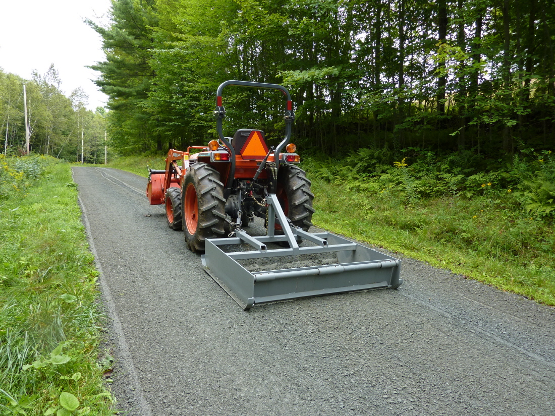

If you have 6" of stone already why add more ? Is the felt because you have a water/mud problem ? If not I would just go over it with a grader/land plane. It will remix the stone and look like new gravel. The road topping in the picture is 5 years old.

If you have 6" of stone already why add more ? Is the felt because you have a water/mud problem ? If not I would just go over it with a grader/land plane. It will remix the stone and look like new gravel. /QUOTE]
Consider that option carefully. It should be the first thing done anyway if you plan to add more gravel. Grade it well and see how that works out before committing to more expenses.:thumbsup:
