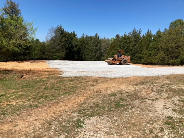

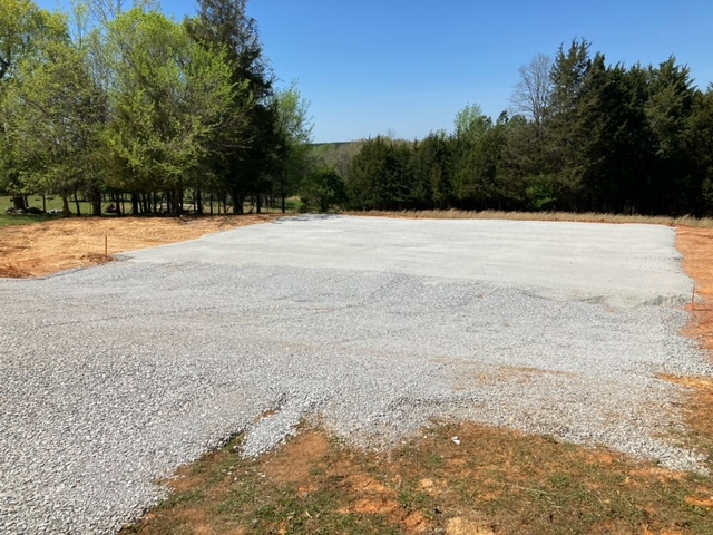

Tractor shed site finished. 4" of crusher run was rolled. It feels very firm. Area at front of site has 57's that were rolled. Also very firm. I think it will hold up well.
Refresh my memory, what type of building are you getting?
   / Any Excavation Professionals Feel Like Giving Advice? #124
Tractor shed, 48' wide, 35' deep. Center section is 24' wide and 12' tall, with 12' lean to's on either side. Lean to's are 9' tall. Outside and back of lean to's are enclosed. All other sides are open. Will be used for 4 tractors, attachments, ATV, riding lawn mower, etc. Ordered it today. Lead time is 4 - 6 weeks.
   / Any Excavation Professionals Feel Like Giving Advice? #125
Pole barn?
