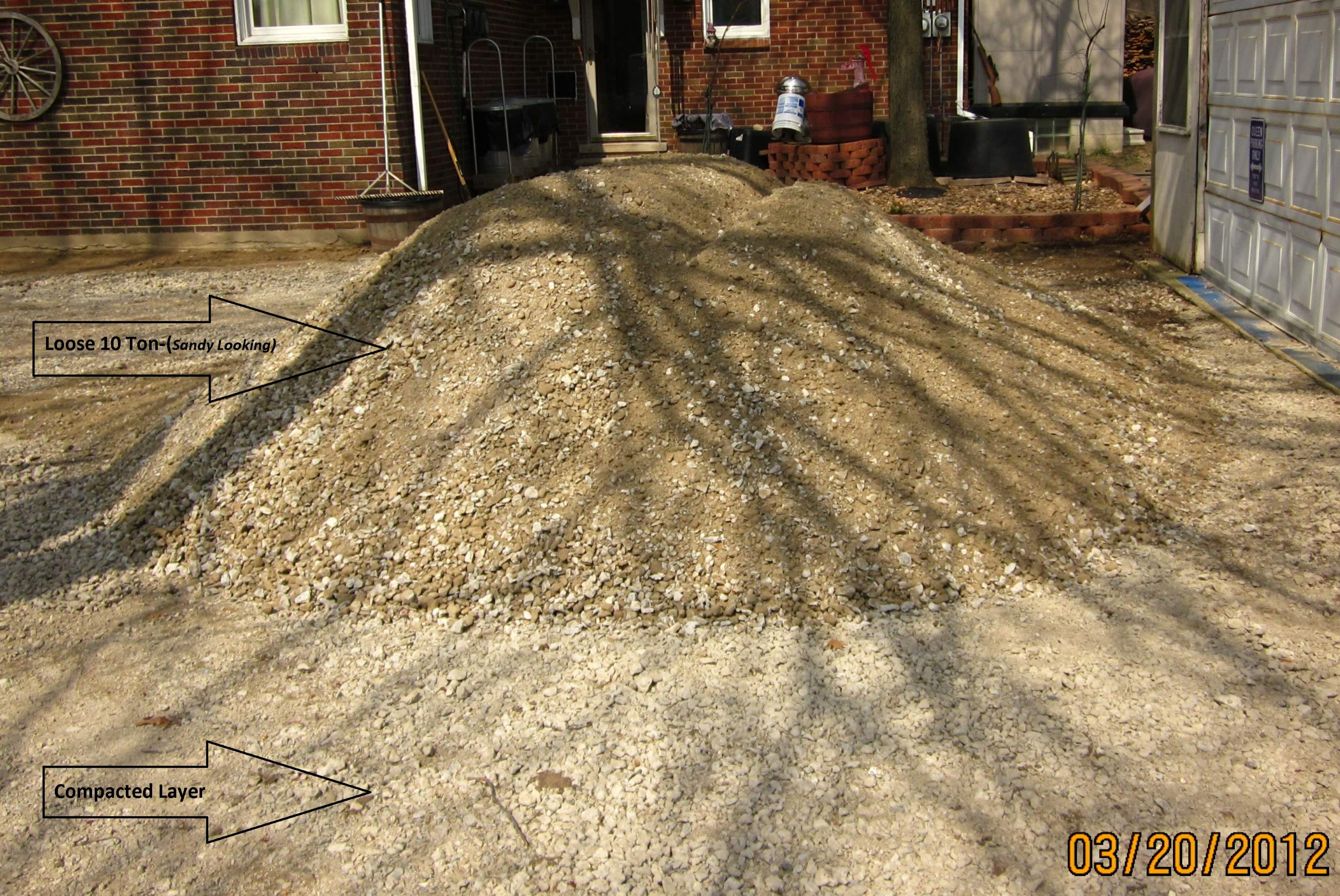

I would leave that up to the concrete companies and just invest in truckloads of crushed concrete from one of them. Not from landscapers that may mix concrete with clay but powdered and crushed concrete (like coarse sand and concrete pieces). Cheapest structural stone that will not get pushed in the wet roadway very easily. Once it gets packed down (sharp edges and cindered pieces lock together) water has a tougher time undermining the larger pieces and the driveway will become pretty hard even during rain and yet drains or runs off to ditches well. The expense will be in trucking to your site.
