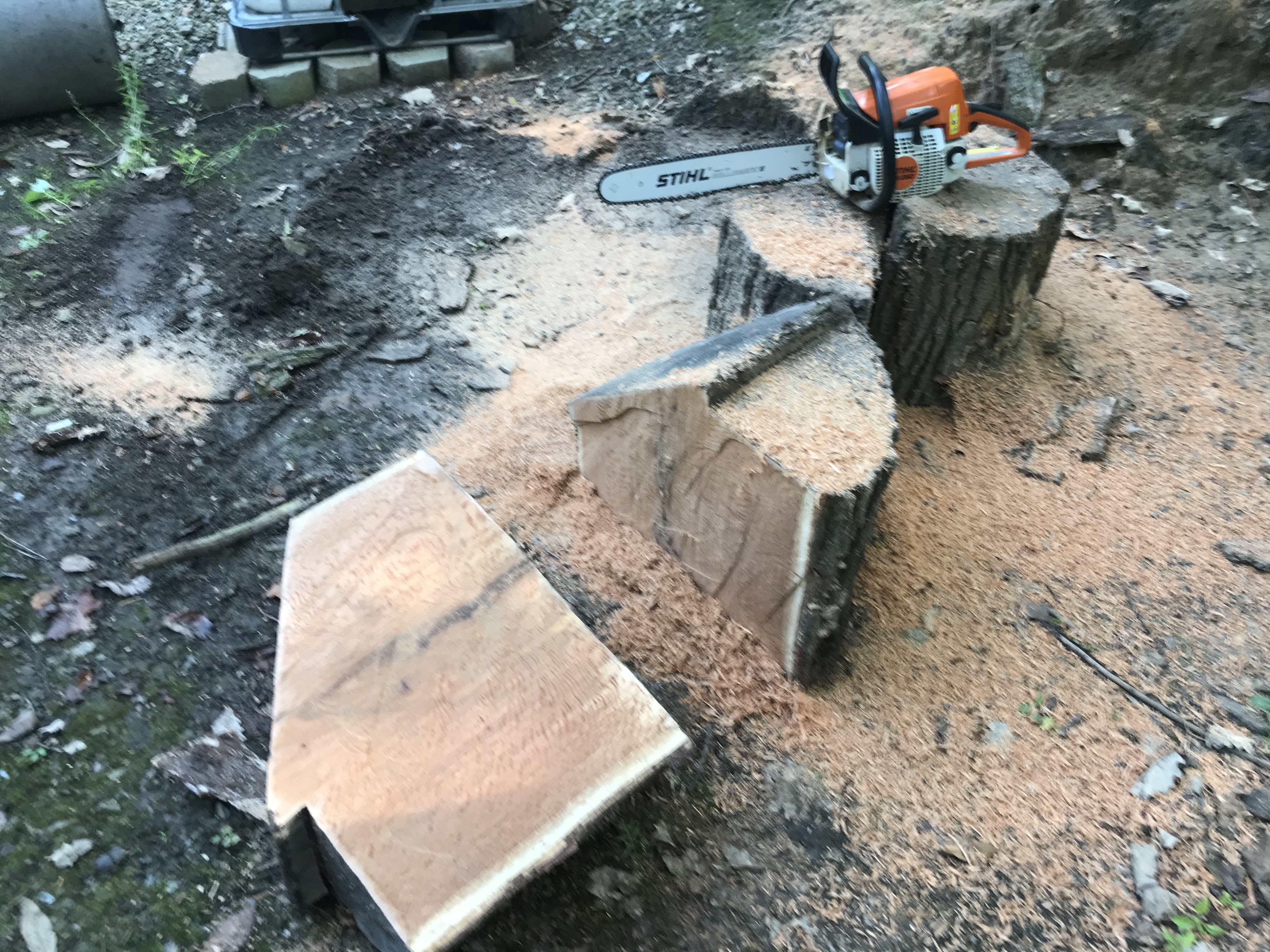

#39
So I have two chains for my 250 and put a different one on and sharpened it. It cut much better, it actually did better than I expected. In the pic the saw is sitting on the piece I cut in half yesterday and the other one I cut in half today. I think yesterday I might have hit a rock first thing and likely dulled the chain. I cut these in half so I can get them up and on my splitter and handle then easier.
