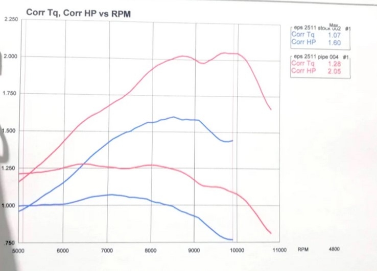

Here is a dyno of just muff mod on 261.
Nice! Looks like roughly +28% torque and +32% HP at 12k RPM. When you load it up, and RPM's drop (e.g. 8k) the margins get thinner, but still not bad. Also, RPM's are unlikely to drop as much with the higher torque up high.
Any word on how it affects operating temperature and reliability? Whenever I bring up mod's to my local saw shop, that's always their first response. I'm running some 30 and 40 year old saws every weekend, and one of them was bought off a pro that used it almost daily for most of it's life. These things last a long time in stock configuration.

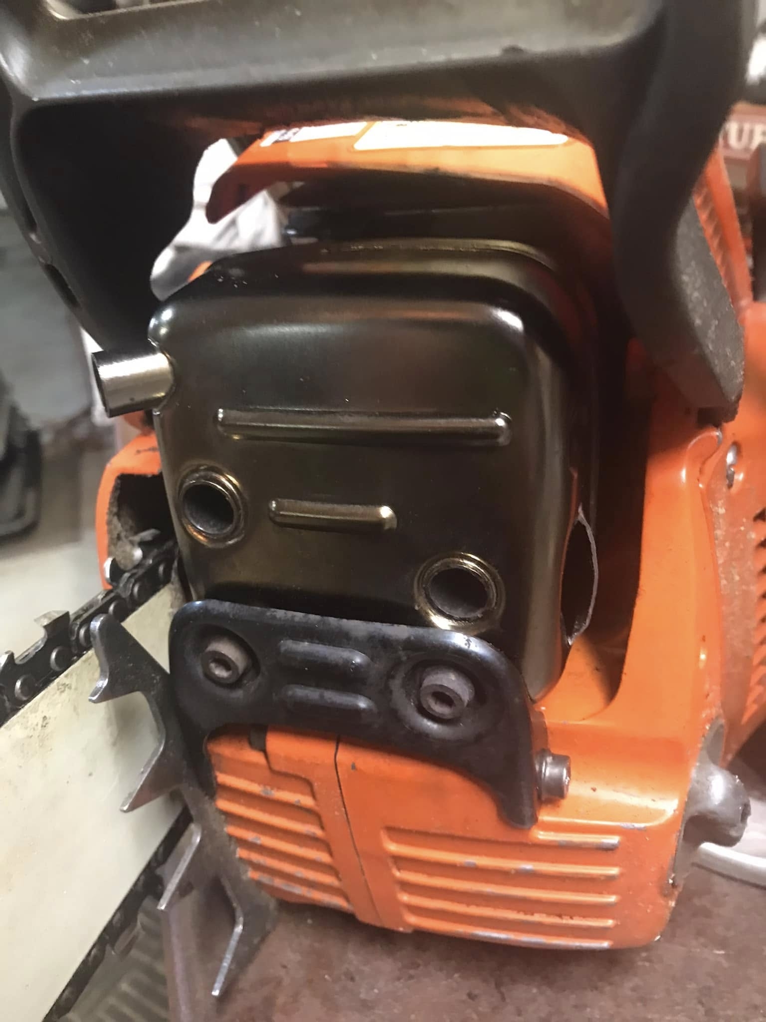

Does anyone make an exhaust like that for huskys?
I can tell ya a guy in OK that does some sweet muffler modding on huskys etc.
He did this 359 I have. I am not one to like pipes over a added deflector or a gill. But his welds is unreal.
Then my stock gasket delete 359 with just a FREE mod with gill.
Both have inner baffle opened up too. His way better then mine.

Jason's little pipe puts out more then some of these guys ported 2511 with muffler mod. The 2511 is so choked down that is where most of the gains are.
