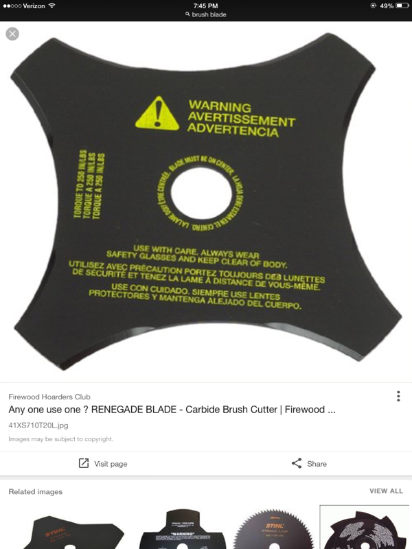

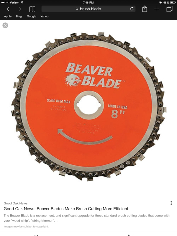

It's amazing what you can cut when you ditch the more common 4 sided blades and get something with some teeth on it. Btw you're cutting those saplings with mostly momentum instead of engine power.

Never used either of those blades. Never even considered the 4 sided one. Just didn't seem like it would work to me. I use string or a tooth blade.
Always wondered if those chain saw blades were any good.
TBS
I have one although a different brand. It worked great but didn't stay sharp very long. The dull blade still cuts briars and 1/2" brush pretty well, but it doesn't do to good on big stuff anymore.
Seems like they might be easy to touch up with a file, no?

I think my beaver blade has a regular semi chisel chain on it. It sure cuts like a saw.. I used it on gorse, hope none of you ever have gorse on your place.
Beaver blade goes on an old fs360 I think it is. But mostly it wears a 3 finger brush knife. Also have a fs38 for light duty stuff. Have used echo pruning saws and can't fault them. Better bang for your buck, as posted above.. I'd still go for a Stihl if money is no object but nothing wrong with either brand. Stihl oil is the best I believe, it's all I use
I was always of the opinion that a chain saw blade cutter would dull up the very first time that you accidently got it in the dirt, just like a chain saw. For that reason I never bothered to get one. I have used an old carbide bit skilsaw blade with good success on my Poulan weed eater. Got to keep it away from fence wire and rocks though. I keep .105 square nylon string on my Stihl weedeater and it wades thru the thickest grass and weeds without stalling.
