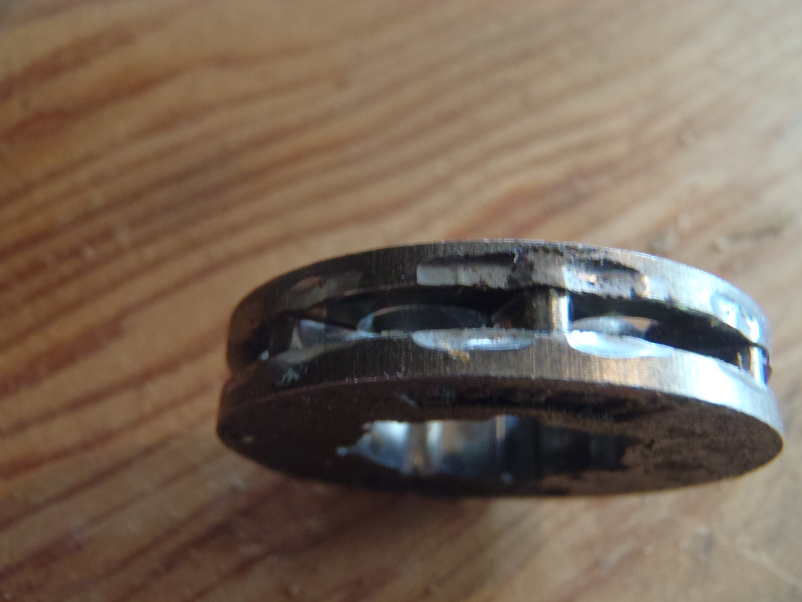

First off, it really needs a new drive sprocket - that thing looks like it must have been throwing
the chain all the time.

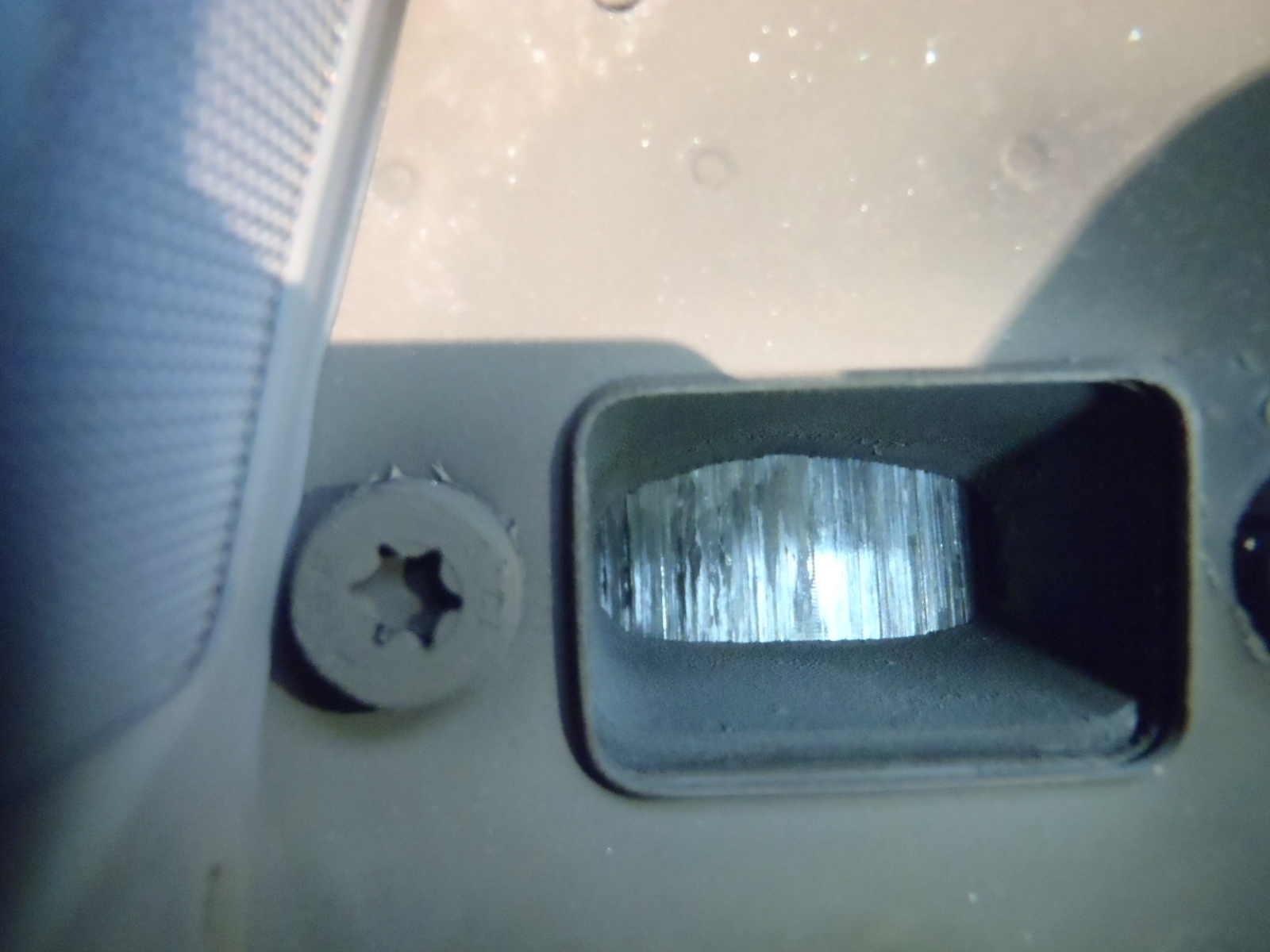

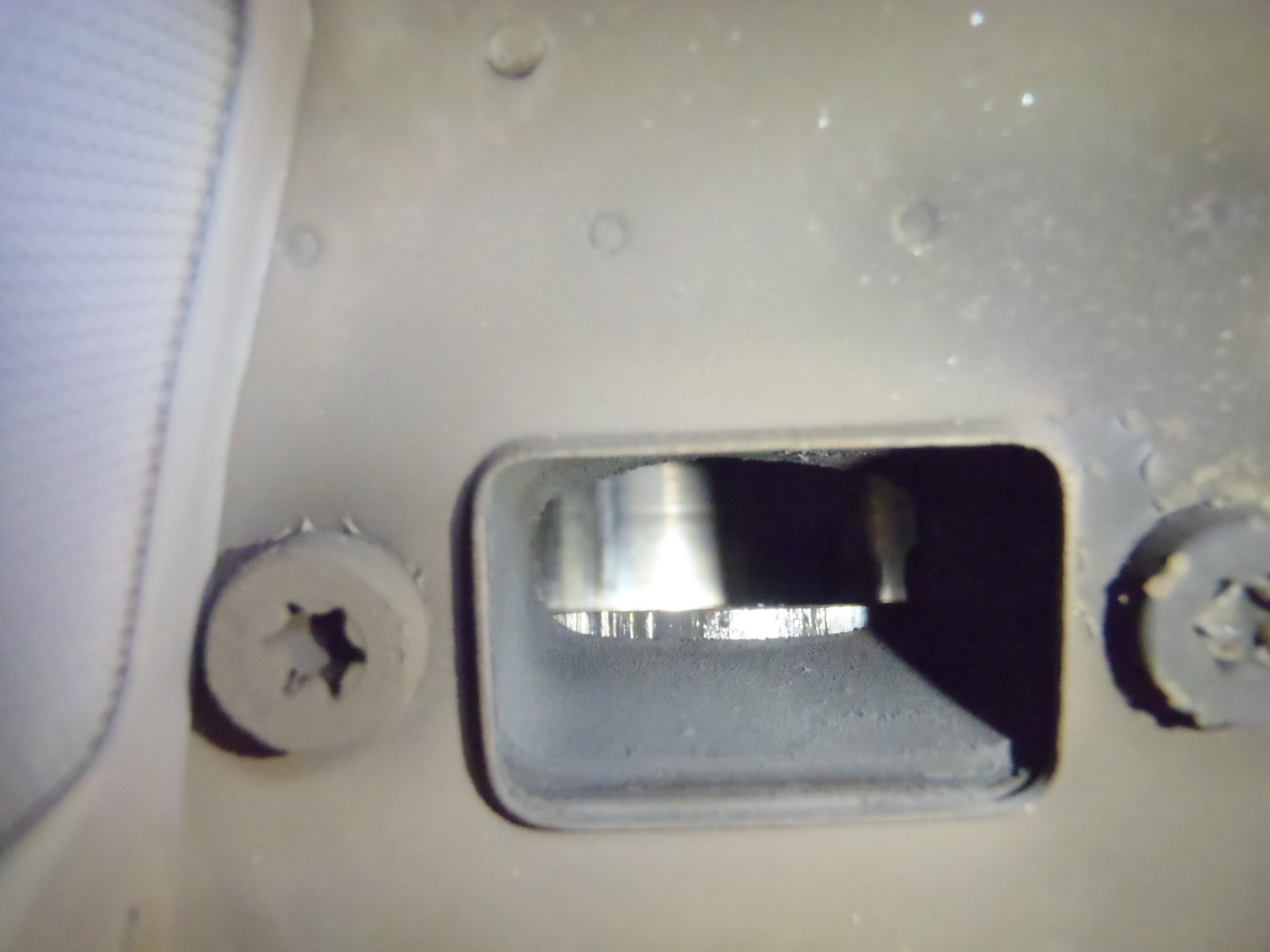

Then I decided to remove the muffler/spark arrestor(?) - the boxy black stamped sheet metal
thing on the forward end, held on with 4 torx bolts. I got a bit of a shock when I saw the piston.
Both it and the rings look pretty well scored.
But I've never had a chainsaw apart, so I'm not sure if it's toast, or just showing normal wear & tear.
Here's what I saw:
Is it time for a rebuild? It sure doesn't feel very smooth when you pull the cord.
Should I get the NWP Piston and Cylinder Assembly (48mm) for Stihl 036 from Bailey's?

Its toast. But the real question is weather the cylinder is toast too or not?? The first pic shows the cylinder on the intake I think??? And that looks good. But the most wear is always the exhaust side. So... You can either take the jug off, or you can pull the carb off and look to the back side cylinder wall.
The condition of the cylinder makes all the difference. If it just needs a piston and ring, you are looking @ a $30-$50 repair if you do it yourself and thats for a good piston. If the cylinder is toast too......well....~$130-$150 gets an aftermarket kit, and north of $300 for OEM.
Taking the cylinder off is easy, especially since you already have the top-cover off, and muffler off. All thats left is the carb, and plug wire, and 4 bolts that bolt the jug down.

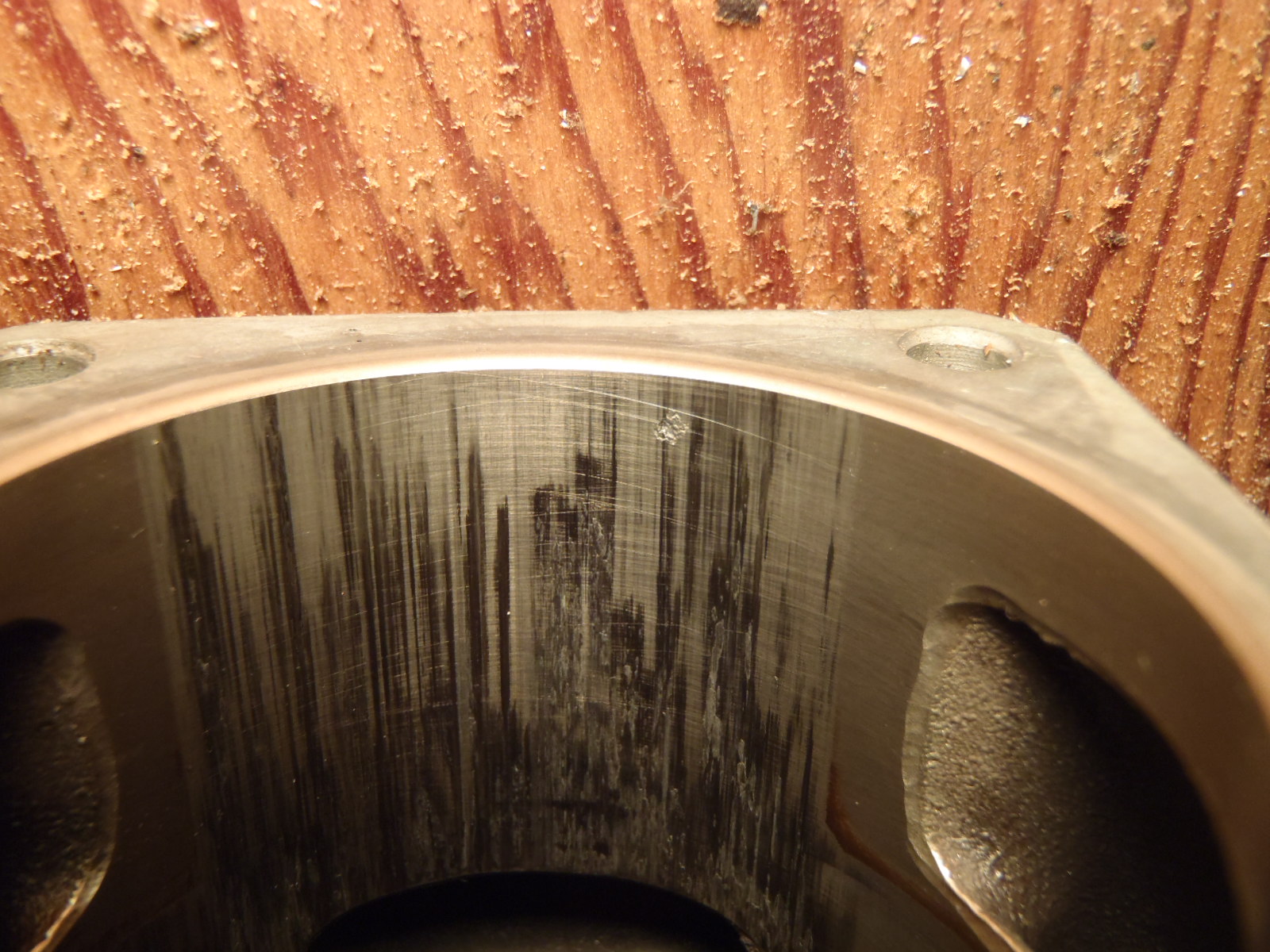

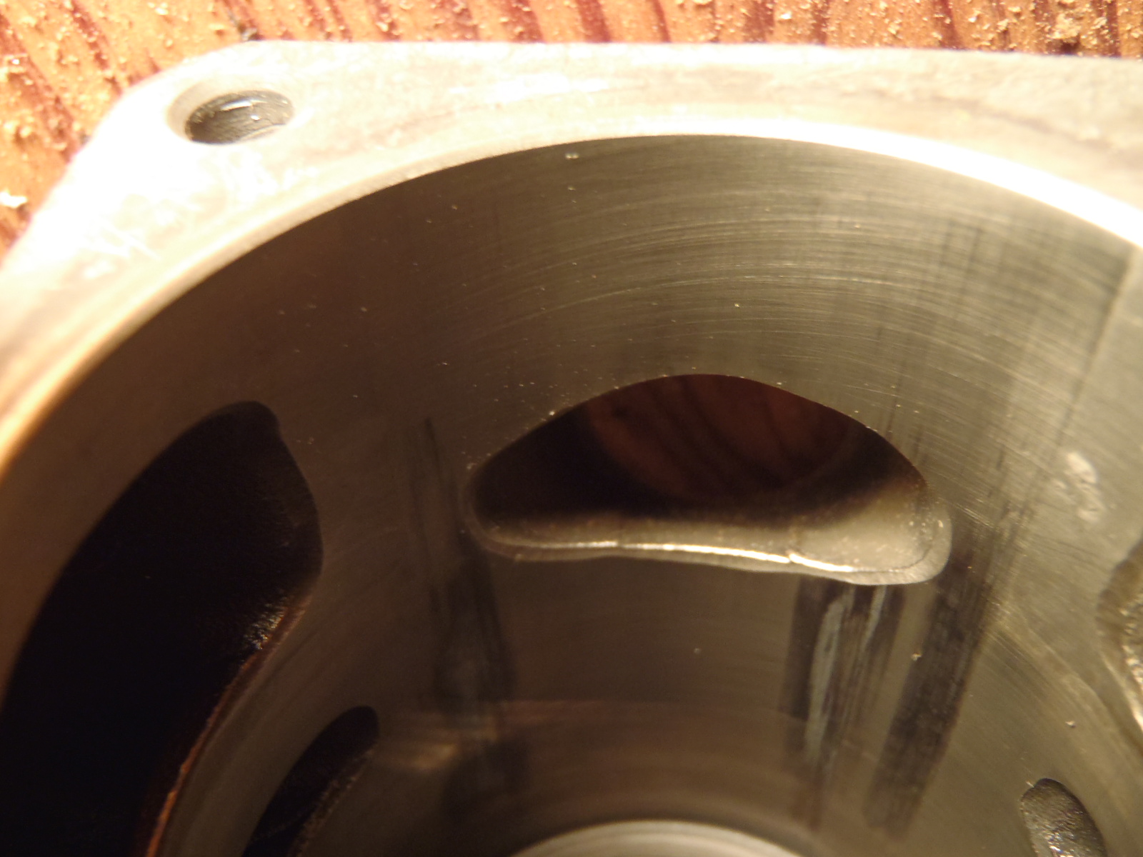

Okay, got the jug off last night after some difficulty. The long series of holes through the fins on the jug/head were misaligned with the bolts and almost exactly the same diameter as my Stihl torx scrench - so the bit wouldn't engage the bolts. Typical, shoddy German engineering! Sorry, as an American engineer, I couldn't resist...
Had to open up the holes in 2 locations with an N sized drill to seat the bit:
Wear in the jug doesn't look as bad as I was anticipating. i was thinking about trying to remove the smeared aluminum using the muriatic acid trick, but saw a good sized pit/spall started on the exhaust side, down low (near the top of the photo, close to the chamfer & flange):

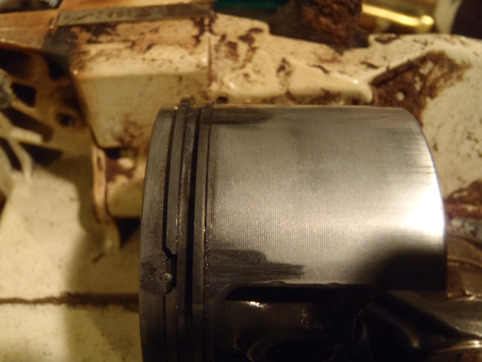

Piston & rings are toast:
Time for a new sprocket:
