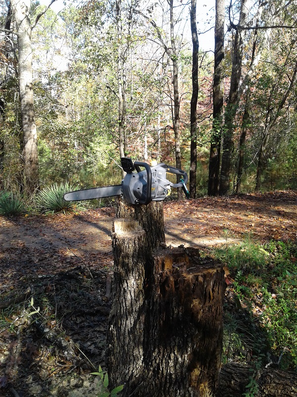

Fix it yourself, pitch it or you can go this route...View attachment 581835
Amish chainsaw.
That's a fun joke. Apparently though they are allowed to use them as long as the saw belongs to somebody else. I've been told that down in New York and Pennsylvania there are quite a few Amish woodcutters.
