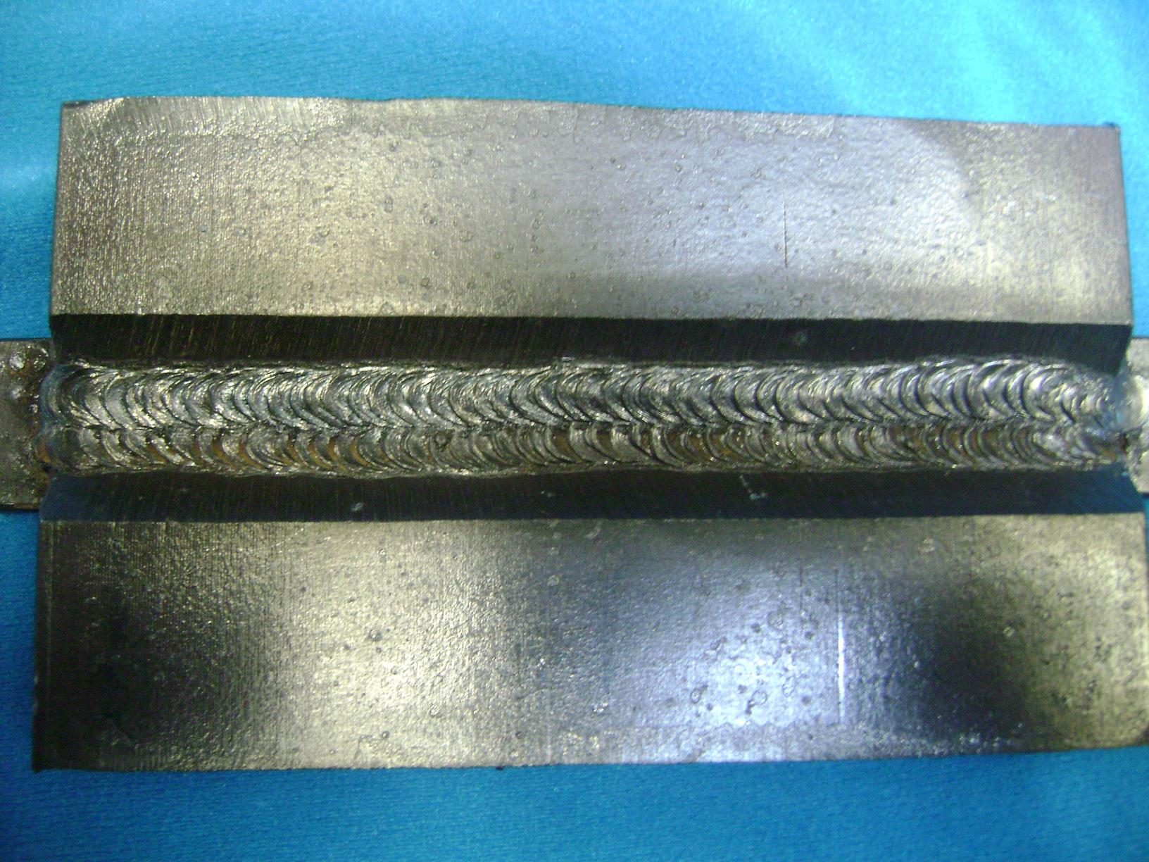

I have to giggle when people say these small inverters can't run 6010. My PA-200 runs 6010 every bit as nice as either one of my SA-200 short hoods. Now I'm no 6010 hand, but I don't think this is to bad for a small inverter. This is a 6010 weld I made when I first got my PA-200.

Yeah, story of my life! If I would have waited until you guys came out with the PA-300 I wouldn't have spent $5,000.00 on the V350-Pro.
The 300 can adjusted with the hot start so much so that no self respecting rod would dare to stick, in fear of immediate disciplinary action. lol.
