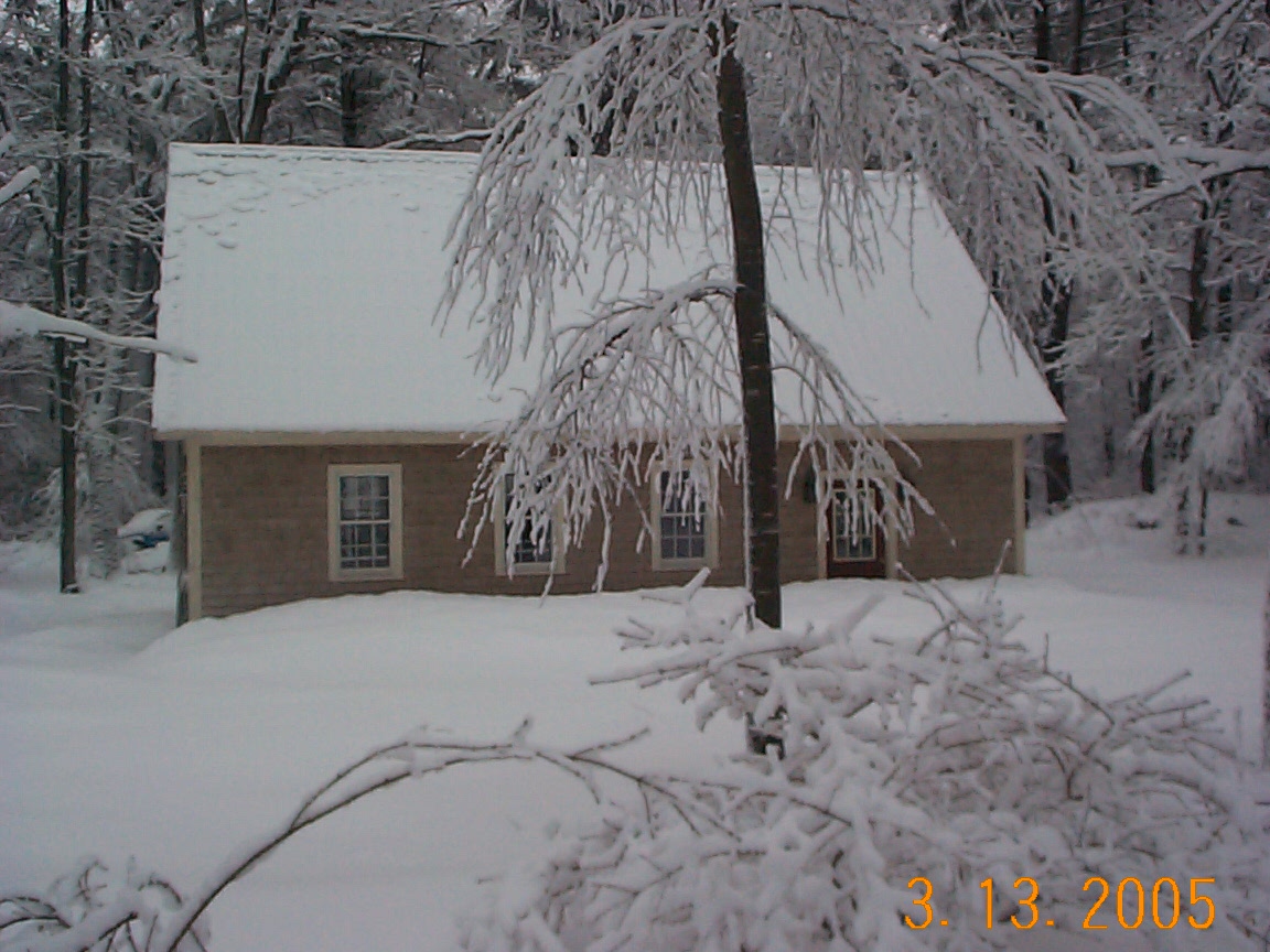

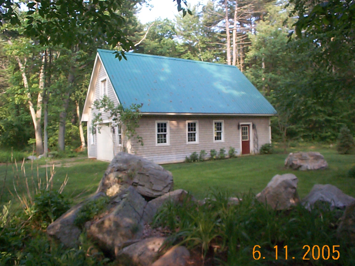

I had this 24x36 stick built in 99 - concrete slab and second floor. I didnt want any posts inside so went with 18" floor trusses - they were the most expense in the project 22 @ $85 each. Used white cedar shakes to match the house and the same bleaching oil stai, and then copper lamps to keep the lady happy..
Total square footage first floor 850, and 550 upstairs. Was $30K with foundation - no insulation and I wired it myself underground from the garage 200' away. Probably today this may be 10-20% higher.
Note: putting the door on front with a metal roof is not advised :)

Carl,
What's the pitch of your roof that's attached to your post?
Doug

Morning Doug,
Its a 12/12 pitch, 2x10 rafters, metal was ordered to length so no cutting made for a fast installation.
