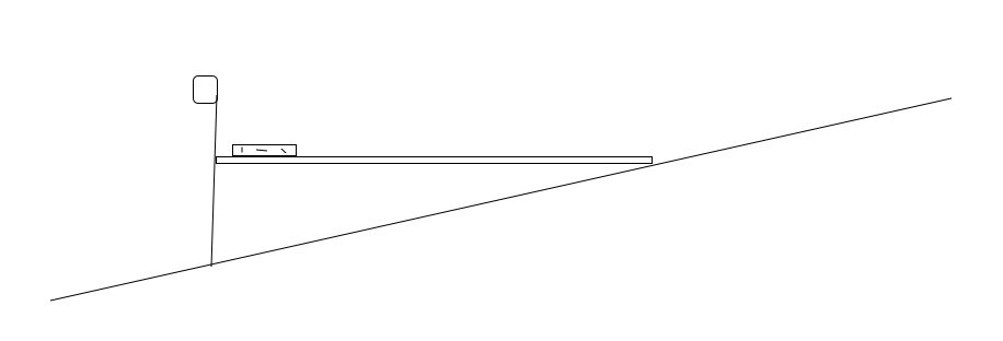

Get an 8ft. board (1x2, 2x4), a tape measure, and a small level.
Level the board on your slope. Measure the distance between the board and the ground at the high end. The height in inches will be so close to the % grade the difference won't matter. (If you want exact, make a 100 inch board) For more convenience, make a 50 inch board, then double the high end measurement.

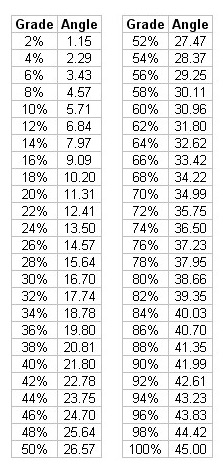

If you want degrees, save this conversion table.

In my case I am trying to determine grade over a distance of say 50ft or more. Often the area of the two points are not easily walkable. Lots of blackberries and other overgrown bush. To be able to 'sight' the distance I need to work 'above' the bushes.
Sure, you'll just have to hold the straight edge up a little above the brush and eyeball it to get it as parallel with the slope as you can. Maybe take 2 or 3 readings and do a mental average. I think that is easier to do with something around a yard long than a small board. I bought my parts this morning and will post some picts once I am happy with the gadget.
