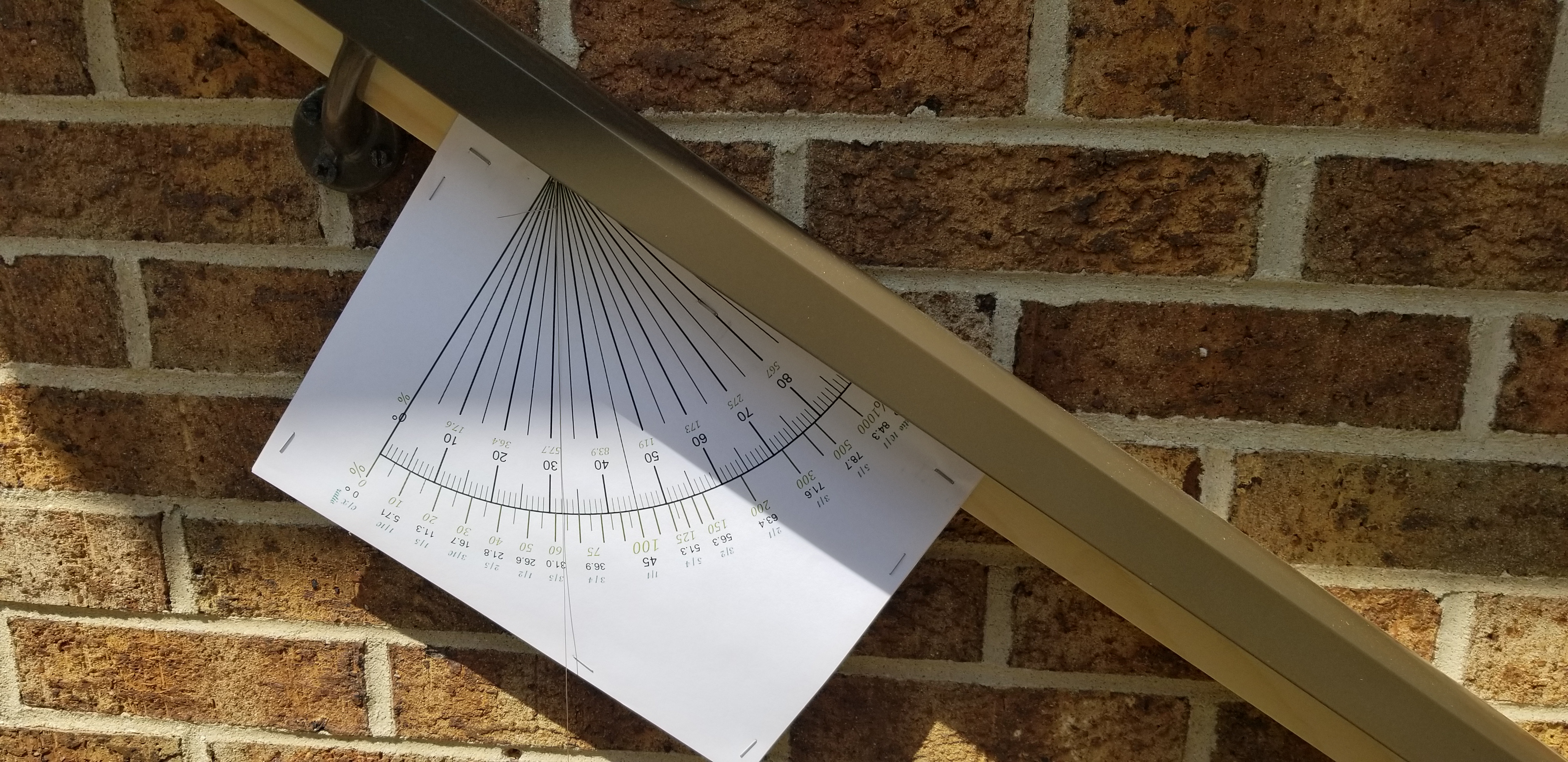

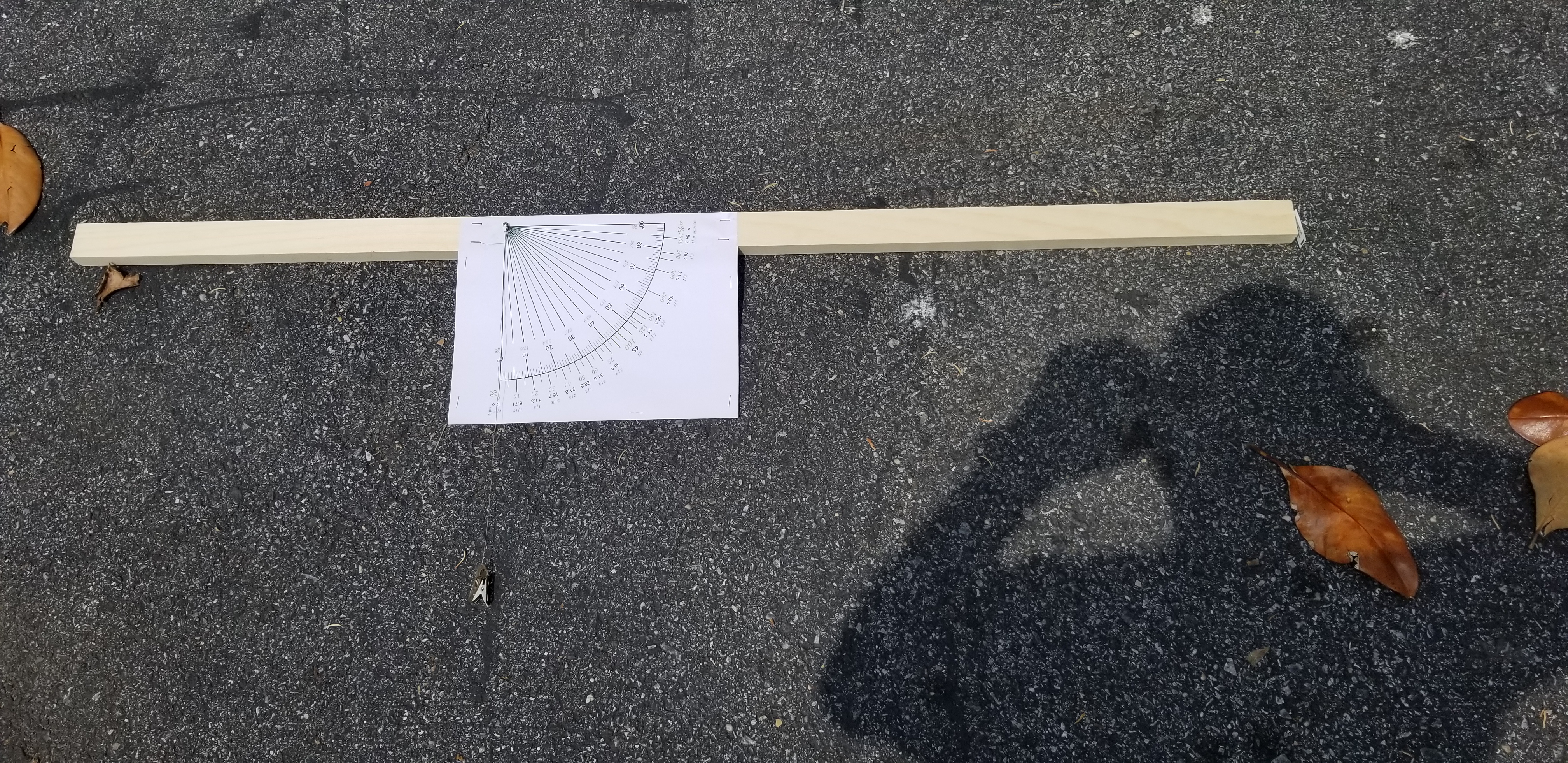

The way I did this model was:
-- Used a 1x2 four feet long
-- Stapled the printout of the angles to a stiff backing paper just to minimize wind effects, etc. and make it a little more durable.
-- Used a staple gun to staple the stiffened page to the wood. No trimming of the page with scissors is needed.
-- Placed the printout and backing on the wood roughly near the middle so there is plenty of wood both up hill and down hill from the angle page
-- Used nylon upholstery thread (because my wife had some and because it will be more durable than cotton or poly thread)
-- Used a "badge holder" clip normally used to attach a badge to your shirt pocket for the weight rather than a paperclip. I started to use a 1/4" nut for a little more weight than
a paper clip but decided on the pocket badge clip because it is plenty of weight and allows me to clip the thread and weight onto the screw so it does not get lost, accidentally pulled loose, etc.
This took 5 minutes to make. It will take you longer to get checked out at Lowes buying the 1x2 than it will to make this thing.
Note that in the test photo our outdoor steps handrail is shown to have a 32 degree slope and that is about 64% slope per the chart.
Seems to work fine for my purposes. Anxious to get back

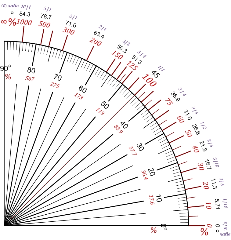

OK,I think I have the photo attachment thing working. Here are the basic angular chart and the way I use it to make a very simple inclinometer. One little added feature -- I'm drilling a 1/4" hole in each end of the 4ft wooden 1x2 so that I can use a heavy steel wire (like those used for posting roadside real estate signs) as a "leg" on each end of the wood. The idea is to push the wire leg into the ground for each end which allows the wood to stay put while you take a reading hands-off. It also allows you to adjust the angle of the wood to match the slope you are measuring.
