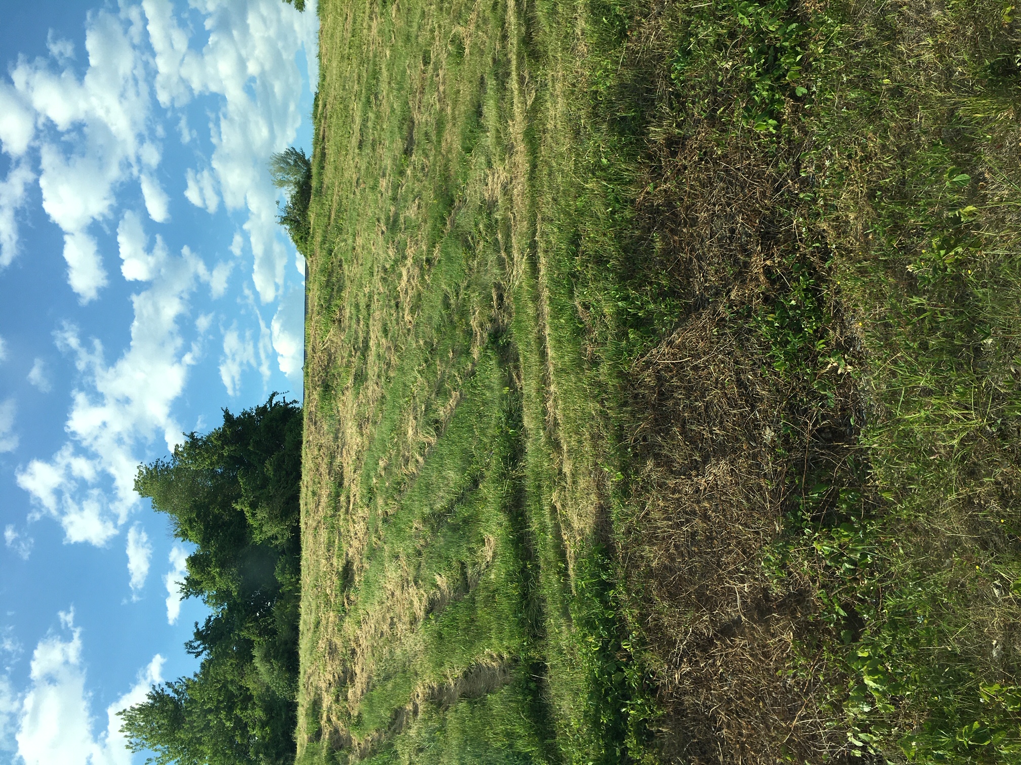

We took a ride on Friday night to the customers place. See photos. To me (and my wife, she freaked out about it), it was very steep. But the pictures make it look kind of tame. The second is the ridge I spoke of. I have a theodolite app on my phone, but didn't want to attract any attention from the neighbors, so I just quickly took these from the car. The next time I do this field I'll put the angel finder on and get accurate measurements.
Maybe I'm just being a wimp about it. i know the tractor seems to struggle with it. I bet (but didn't try) that it would not climb the slope in Medium range.
I would call that a very scary slope. Doubt if I would do it myself. Luckily I don't have any that steep that need tractoring. That's where I would call in someone with specialized equipment. Too much pucker factor & not enough safety factor.
