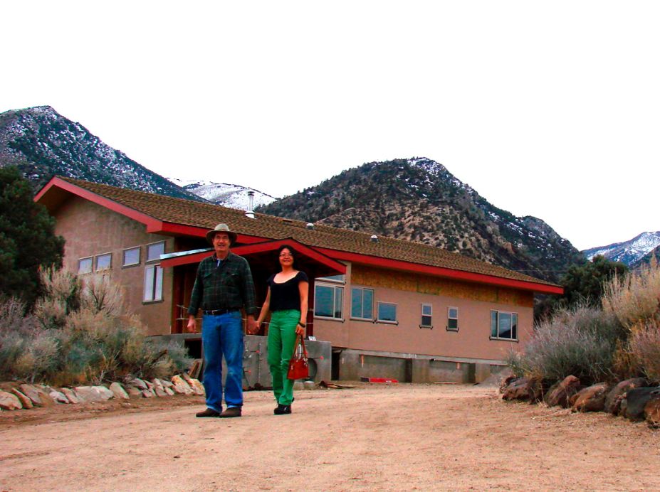

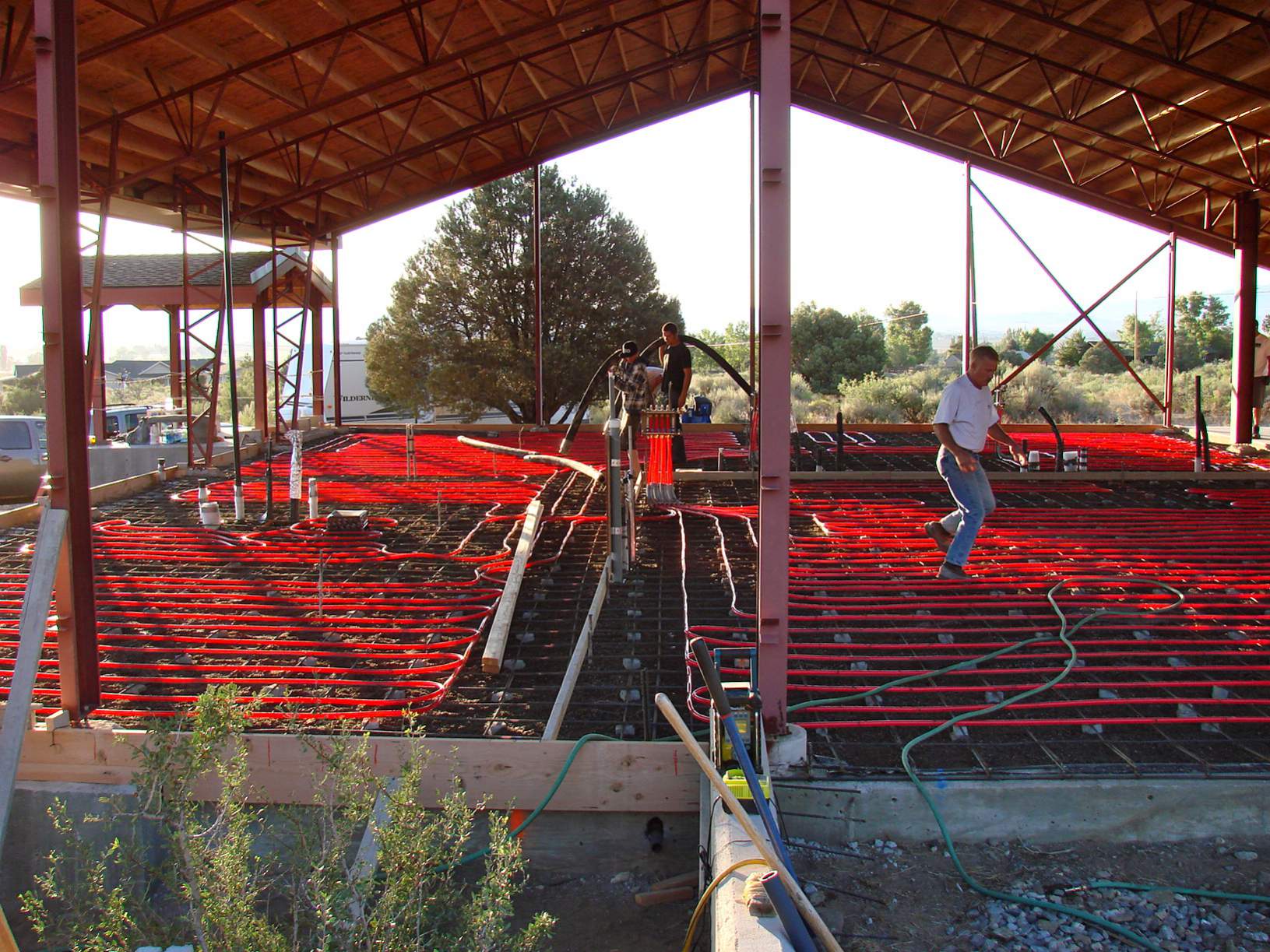

Thought I'd send a few more pictures of the recent progress on the house.
The exterior is just primed in these pix, but the concrete siding is going on now and should be done next week.
I'm currently working on the mechanical and starting the electrical, wood stove is temporarily installed and working, but the floors are so cold!
I love having the garage closed up and power to the panel, lights working and electric garage doors!!!
