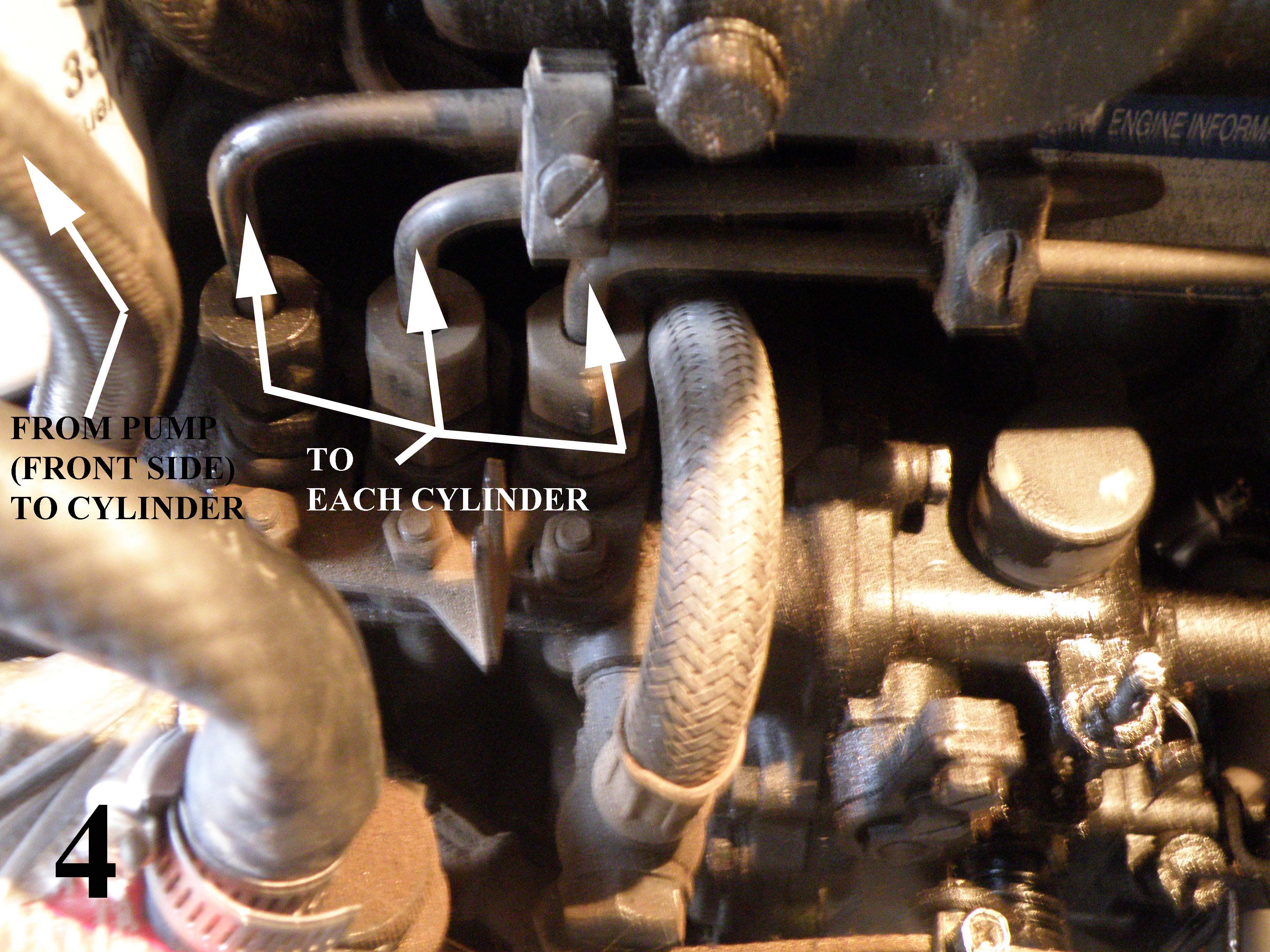

Ok. I think I'm too much visual to do that job and let me explain what I understand with five pictures.

Fourth, at extrem left (front side), there is a hose that come from the pump (injector pump?) and goes to cylinder (in serial, one after one). Also, there is three metal slot with screw that go in each cylinder. Is there those three screw at thois place (near the injector pump) that I must unsrew (3/4 turn) to bleed the air?
Five, at the botton left, it is the hose that come from pump (or injector pump) and finish its course in fuel tank, AND also, there is same type of screw as the last picture, but near the cylinder. Questions here are : do I unsrew (3/4 turn) those three screws from the injector pump? Do I unsrew other bolt (from the pump) ?
I hope picture and question are clear enough. If I am not correct, you can refered to any picture number.

finally, I bleed the air in fuel line....
