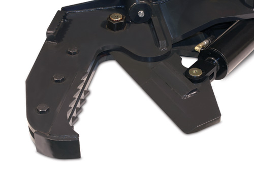

Heres a directional shear by Berlon thats built like yours is drawn up. There was also another company that made one like this and it also doubled as a puller to. Berlon: Tree Shear 5"
ALot of thinning tree shears back in pulp wooding days were built like this and the fall the trees to the side of travel.

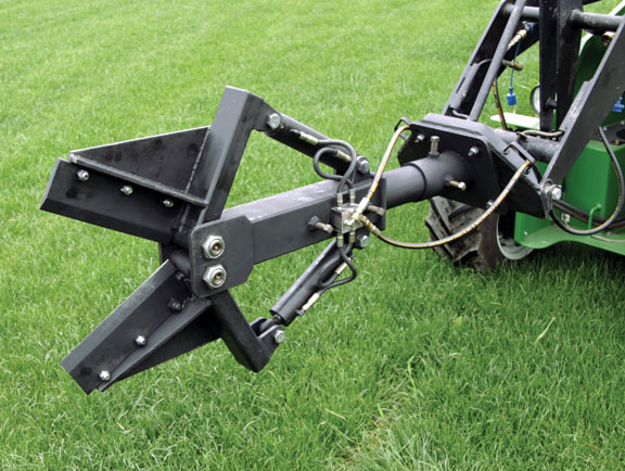

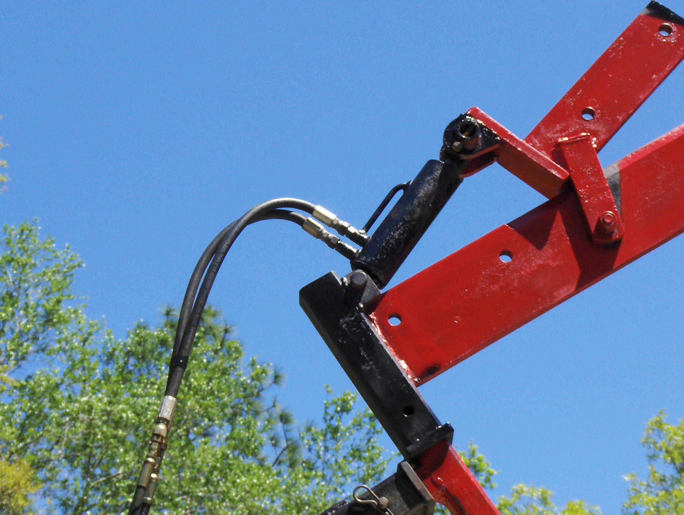

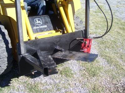

Some different cutters.
The forth cutter is a push cutter. The tree is cut as you drive through it.
