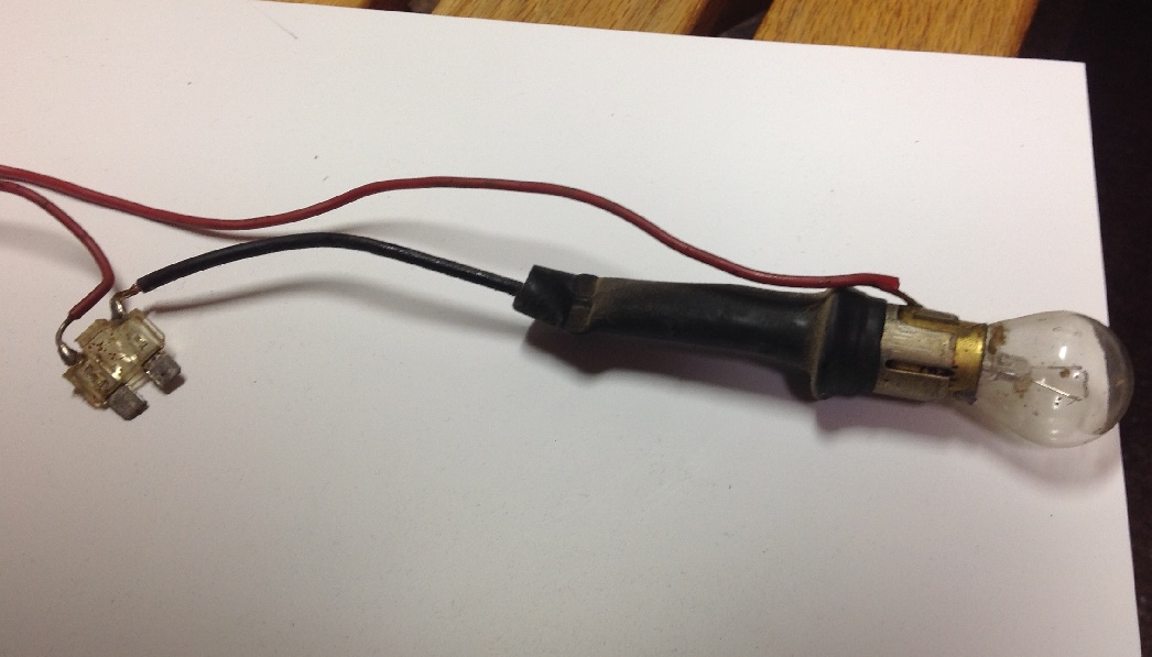

To check it out, put a 12v light bulb in the fuse slot.. as long as there is a short the light bulb will be lit. When you isolate the short.. the light will go out.
Think that will save on your fuses and help diagnose where the trouble is at.

Thanks Beenthere. Not quite sure on what you mean about the 12v bulb since the fuse slot is just a bridge of positive. I would think if I put a test light on the down stream side of the fuse and put the other end on positive terminal as long as it stays on, it is grounded somewhere, but will turn off if I find and remove the sho. I just don't know where to look and I can't seem to find the wiring diagram, and there doesn't seem to be much wiring anyway, but don't really know where to look for the short. I will ask Ag Pro tomorrow.

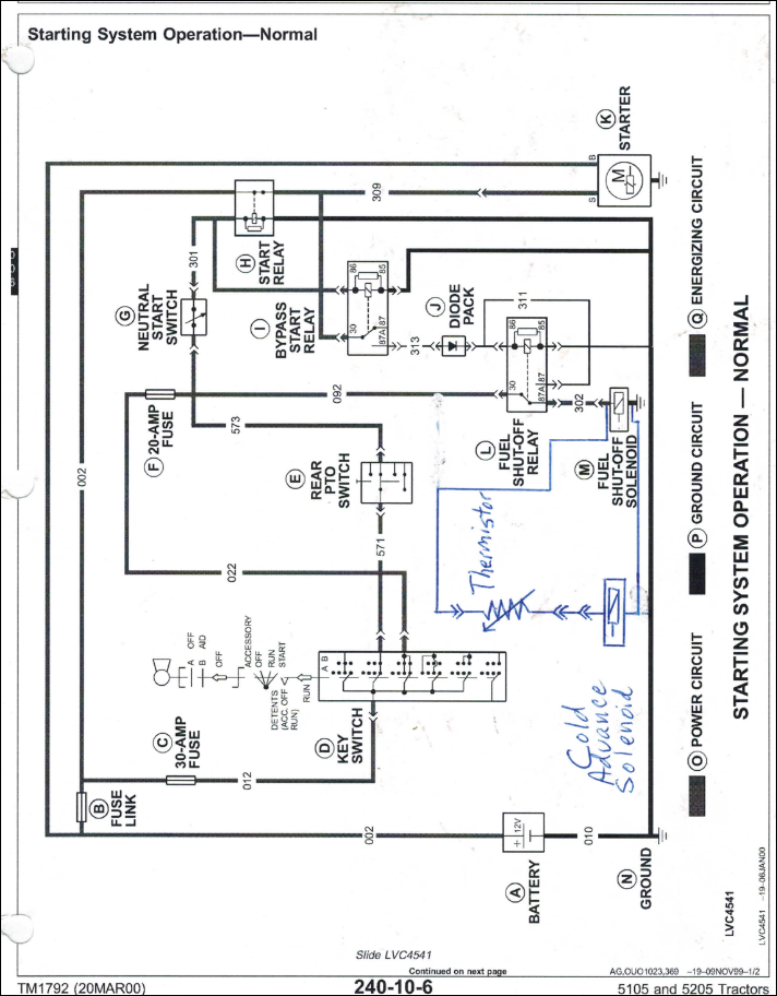

Do you have a wiring diagram you could post for us to study?

This is my fuse replacement tester.. just solder some wires to a blown fuse so the light bulb is in place of the fuse.. instead of blowing, it will light. Your fuse may look different than this spade fuse.

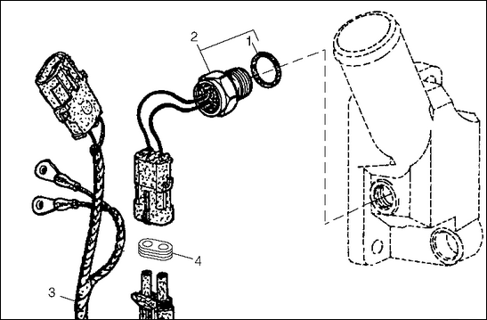

Sounds as if cold start switch has shorted out. Unplug switch,install new fuse & attempt to start tractor. If engine starts & runs you've located your problem. These switches have a long/long history of failure. RE503242 Temperature Switch - ADD 49.58 USD
Jim...you are a rock star! Unplugged switch and put in new fuse....cranked right up! Any Idea where I can get a wiring diagram without buying the entire shop manual?
Beenthere...that is a pretty cool little tester you made there. I will make a couple variations for different fuses. Thanks for sharing

This wiring diagram might be close. This sensor has been causing blown fuses since the mid 90's & I think JD enjoys the revenue that it generates.:drink:

tks tass.
It saved my bacon a few times, the first time was with a car that had a worn wire that went over the headliner to a dome light. Put that bulb in the fuse slot and poked and tugged on wires for hours until accidentally bumping the headliner and it flickered. Removed the headliner to find that vibrations had caused a wire to short out. Often wondered what a service shop would have had to charge to find that bared wire.
