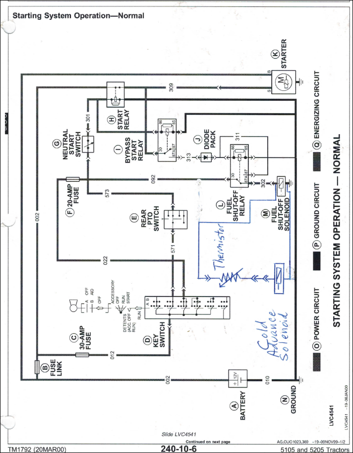

Jim...you are a rock star! Unplugged switch and put in new fuse....cranked right up! Any Idea where I can get a wiring diagram without buying the entire shop manual?
I don't think you can do that, but you can buy the manual on CD off of ebay for much less and just print out the pages you need.

They're known to fail in the shorted position. My understanding is they're for better "emissions"/ fuel efficiency when starting in cold temps, but not really required from a performance or starting aspect.
   / Starter relay fuse keeps blowing #14
This wiring diagram might be close. This sensor has been causing blown fuses since the mid 90's & I think JD enjoys the revenue that it generates.:drink:
Curious...ever since I unplugged it, I get white smoke at startup. Never had that before. Do you think it affects timing? It clears up after a couple of minutes.
   / Starter relay fuse keeps blowing #17
I don't understand how but I think I'm correct that the cold start sensor does alter IP timing when engine is cold.
Since the injection system is a common rail electronic one, I think the opening and closing of the injector and changing the amount or length of the fuel injected and also when it is injected is just an electronic signal.
