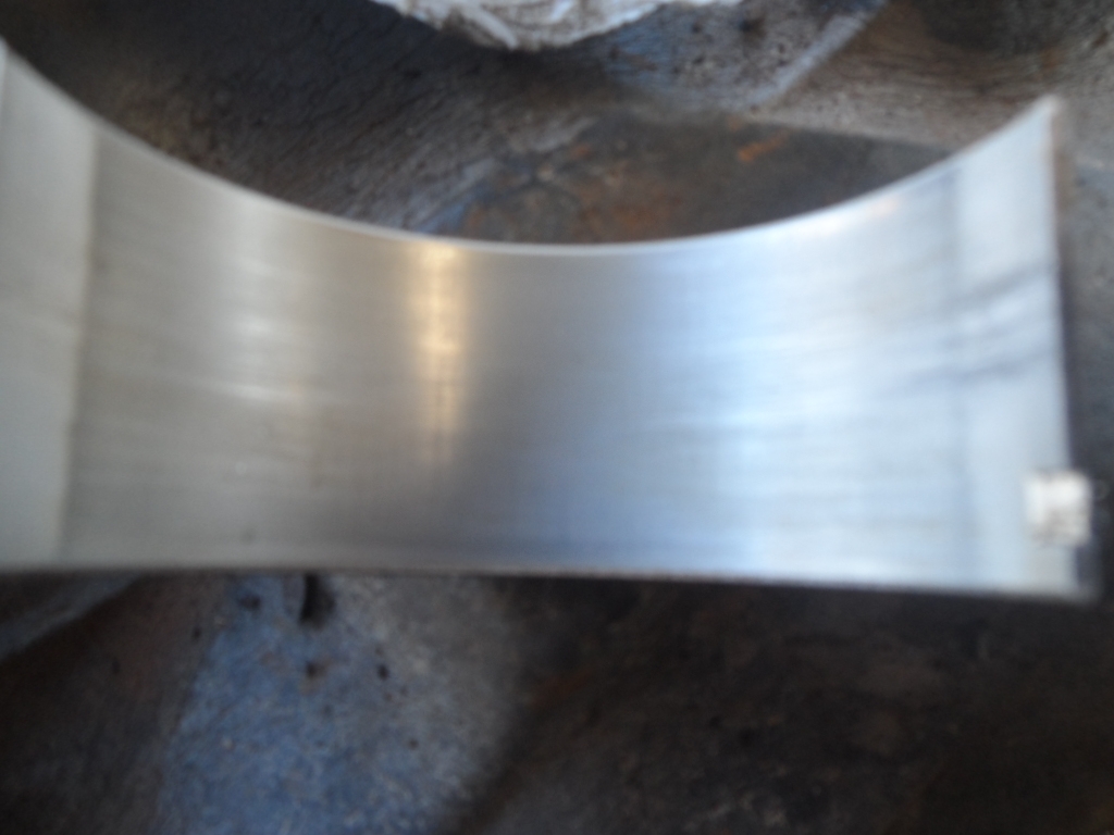

Hey

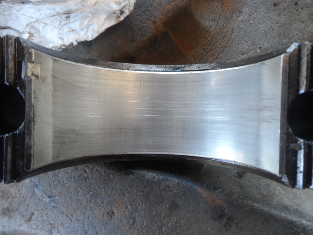

Ok so i took them all out again dipped them in oil and put them back in , and so i had put number 1 and 4 in and tightened the bolts as har as i could and it was rotating fine , i could rotate it with a spaner then i put number 2 in. It went down the cylinder alright but when i tightened the bolts for the rod it when like before but when i lossen the bolts and only hand tightened them it was rotating fine again . Is it the rod bearings then ? do i have to replace them?
thanks
T
   / Starter on Carroro 68.4 #66
The rod bearing is the problem, but if you are using the old bearing in the same spot, you may be simply overtorqueing the bearing.
Make sure you have plenty of lube on the beatmrings and the bearing is properly seated.
Torque should be 85.417 newton metres/63 ft. lb. or, if you don't have a torque wrench, 'pretty snug' with a 1/2" ratchet.

Just out of curiosity, how much does a set of bearings cost?
This sounding like spending a lot of time to get an engine torn down, and then not replacing "easy to get to now" parts. In my mind, new bearings while you have it apart and have access to them is always the best answer if you can afford them, and they are available.

I've figure it out . I had very stupidly put them on the wrong way round .

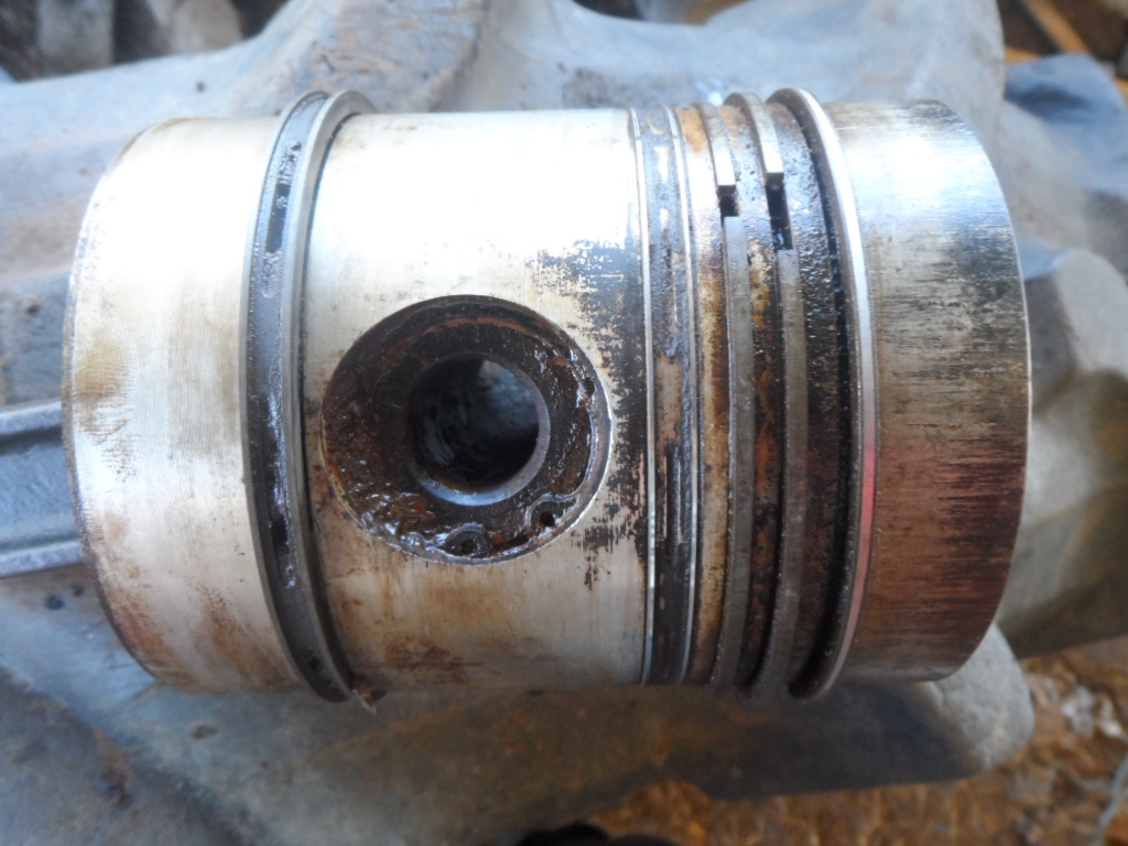

Right , so i got the piston rings yesterday and put the pistons back in and the balancer .Then today i've finished cleaning the head and the gasket and lapped some of the valves cause they weren't sealing , so i got them sealing better but not perfect . so i put the head on and injectors but not the oil pan cause i wanted to make sure it would turn over before i put it back on .And adjusted the valves and at that point i could turn the engine over with just a spanner so then i tried the starter and it turn round but slowly and would slow down at one point . So i'm guessing it's the starter that's the problem now but also i could hear air coming out at the intake so i guess the valves aren't sealing as well as they should and I think i could hear some coming out from bottom of the pistons but i might be imagining it but would that mean that the sleeves need replacing ? and i only did the valves with medium grinding paste and i guess i need to do them with the fine stuff but i thought just to see if it would work .

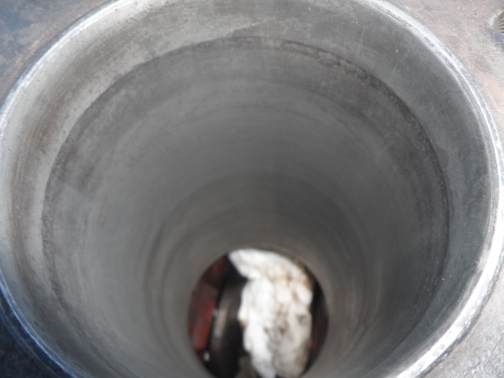

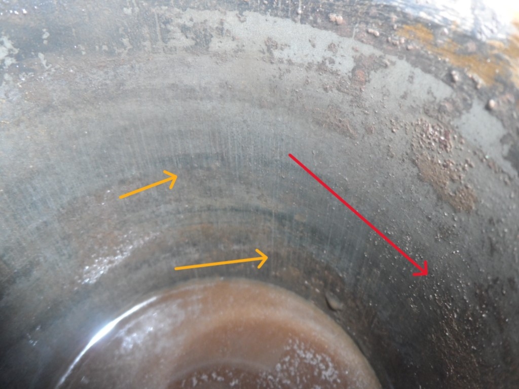

Ok cool i'll have a look . I've found out one of the sleeves is leaking so might have to replace . New one is around 23 euros , i've seen a trick where someone gets a small screw driver and hammers down along the sleeve but to put a new one in it's freezing it but how cold does it have to be to just slip in ?

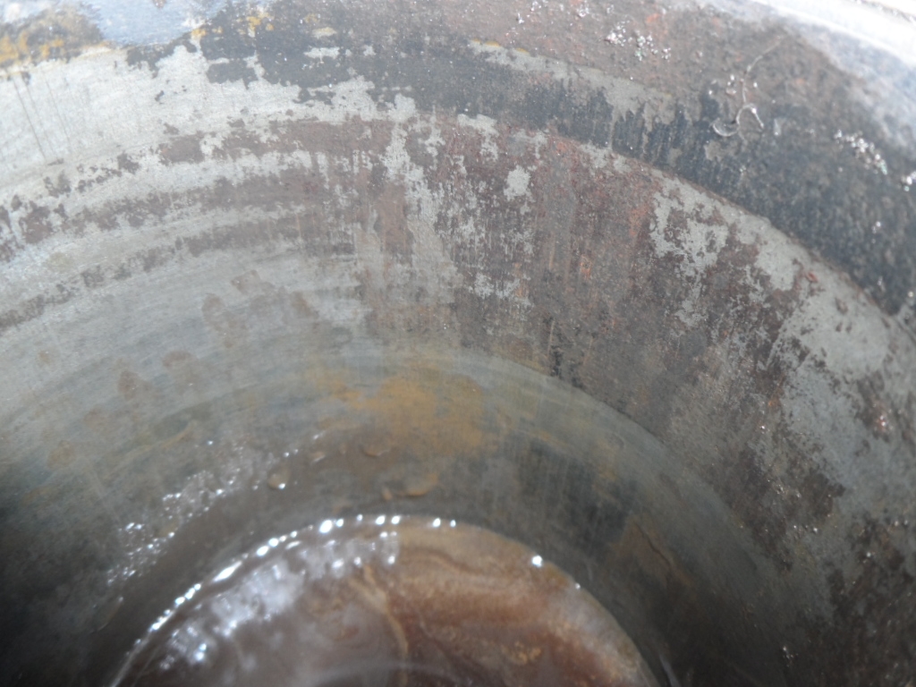

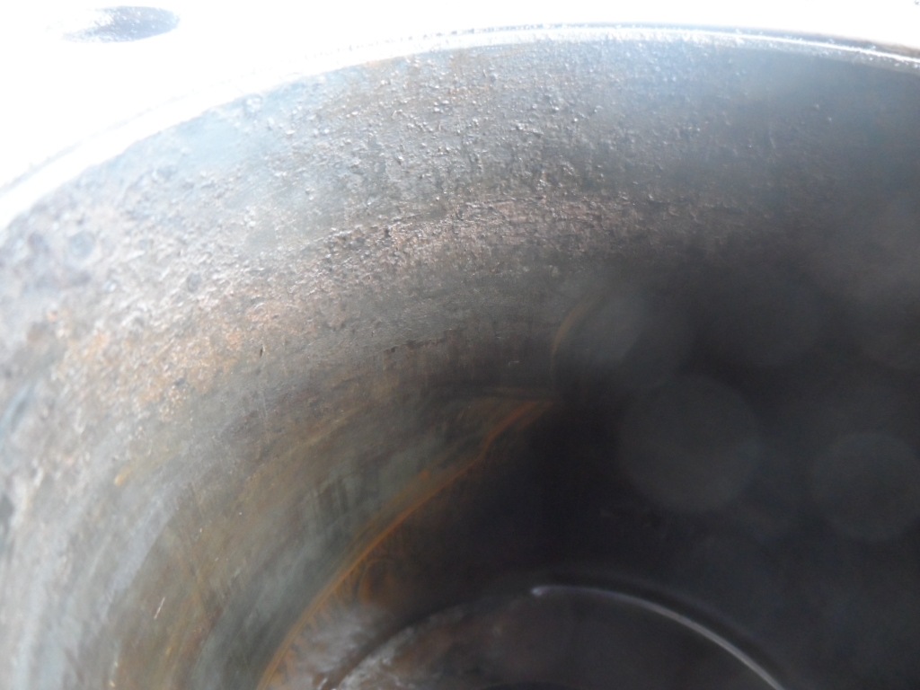

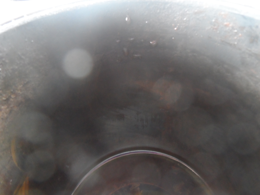

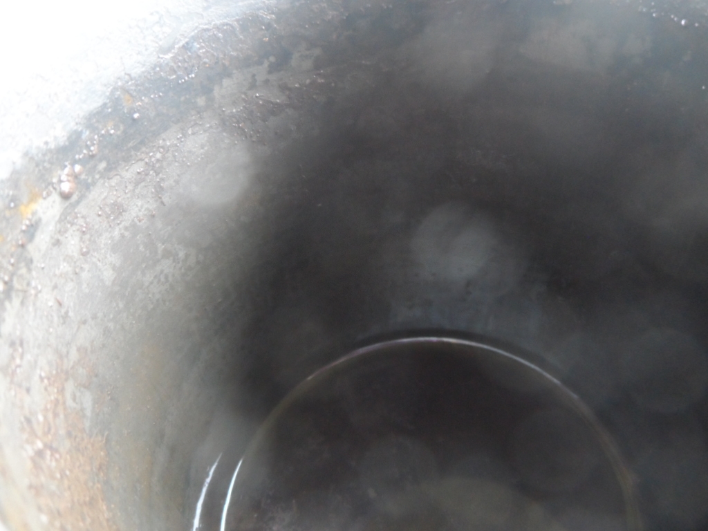

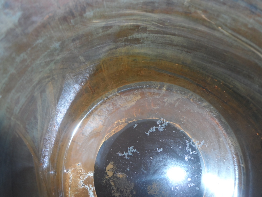

Ok right night , i thought i would try it again with the cylinders and so i put vinegar in them , and for some reason all but one stayed full . does that mean theyre all right after all ?
   / Starter on Carroro 68.4 #75
Not sure why you would use vinegar and why 3 of 4 don't leak. Unless the cylinder has a hole/crack, it should not leak. It also shouldn't move, but it is kept in place by the head.
#76
i used vinegar cause i didn't have diesel and didn't want to use water , there not holes or cracks .
