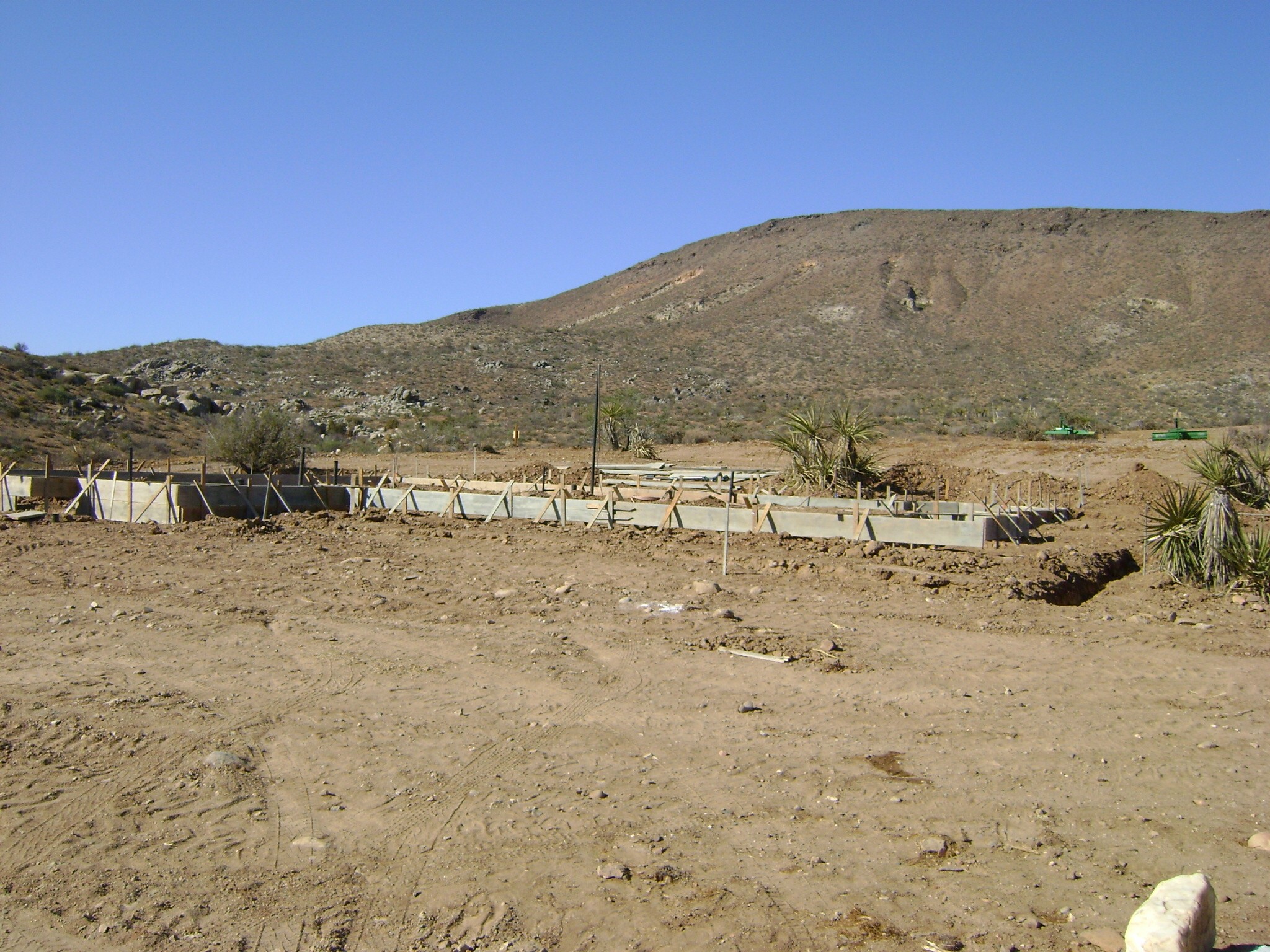

Well I finally decided to hire a GC and start the new house. They are off to a good start, dug the footings last week, finished the rough plumbing today and get the first inspection tomorrow. This home will be 1728 sq feet with a 670sq foot wrap around patio, 12x12 pitch, metal roof, Hardi siding and 100% off grid with propane and solar power.
I did the Well about 4 years ago and just had the septic put in before the foundation guy started.
Kind of scary but exciting as well.

Looking forward to see how it turns out. We want a house off the grid some day. Was the plan designed by you or did you have an architect? Doesn't look like sunlight will be in short supply... :)

No the solar will not be in place for a few months. I use my generator to fill my 10,000 gallong tank that sits about 100 feet higher than my house site on top of a hill, so all of my water is gravity fed once it makes the 700 foot trip from the well to the water tank.
The fire department requires the storage tank here as well as fire hydrant and a fire srprinkler system in the house.
We got the first inspection out of the way today so they will be pouring concrete next week!
I'll be using my tractor this weekend to get my 3,000 foot driveway in order.
