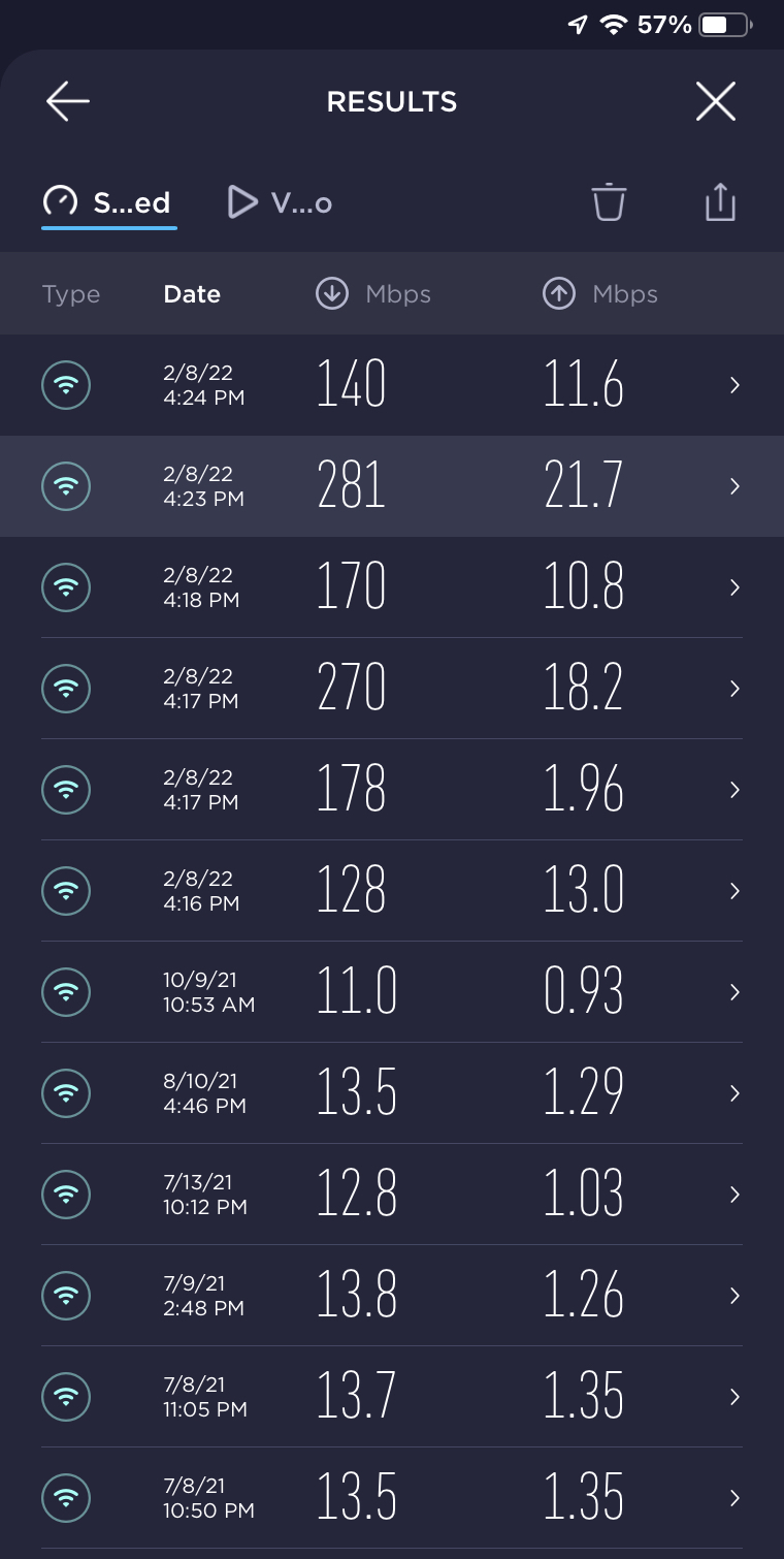

Received the StarLink kit today. A breeze to set up. I have it temporarily sitting on the ground for now. Here’s the early results. Below the first six are my DSL speed history tests.
A question - does the dish move periodically or does it stay put after the initialization?
Boy I wish my dsl speed was even half of what yours was I'm luck if I get 2 mbps on a good day it is usually less than 1.5 down
