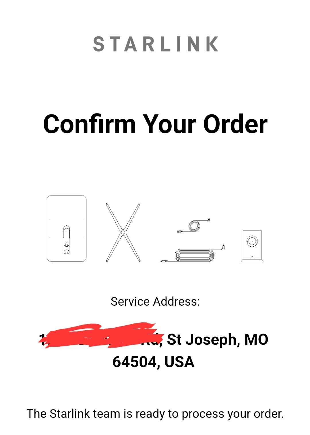

Got our notification this evening. Located in NW Missouri. Have a friend located in Topeka KS that recieved his notification today as well.
For those who have been thinking about canceling and reordering later I just checked another address for my area. It shows we are already at capacity and new order may not be fulfilled until 2023 or later.

My brother who lives down the road from me, and I both got our notifications Tuesday, when I used the link to confirm, Bang! They used them "card on file", and the deed was done, now we are waiting for the shipping notification.
