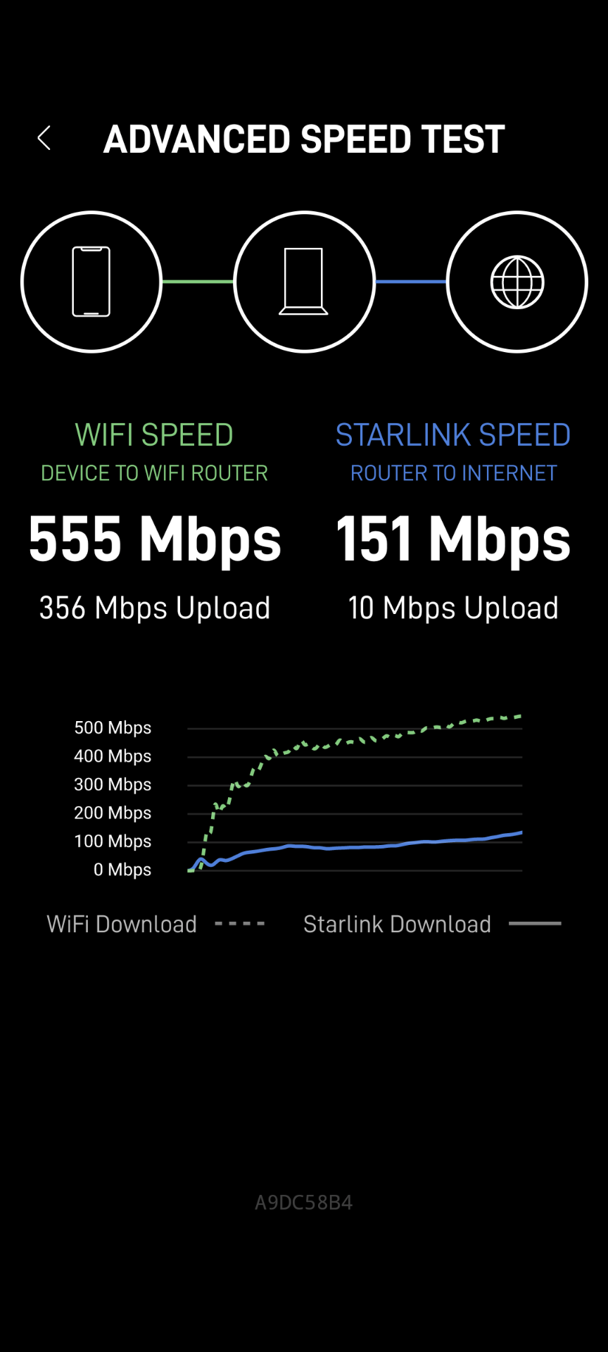

I think this may be the highest that I have seen with my "best effort".
/ Starlink #3,606

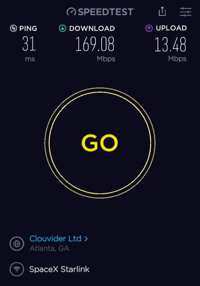

Received our Residential? kit and we have been getting between 130-168 on the download when run on a 5G phone.
It drops into the 30-40s when run back to back on my old laptop.
So I guess wlan in my laptop is old and slow and just limits speeds.
How old of laptop? Is laptop connected via wifi or ethernet? Wifi standards could have been less capable if it is quite old.
