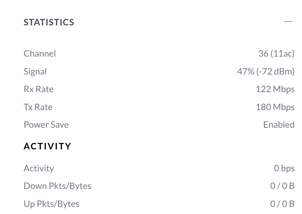

@RedNeckGeek You might want to check that your access points aren't putting you on your presumably bandwidth throttled guest network. I.e. try deleting all of the WiFi authorizations except for Gunsmoke 5GHz on a single device, e.g. a tablet, and rerunning the speed test.
Here's a snap of the Statistics tab in Unifi Network for the iPhone:
Doesn't look like the WiFi link is the bottleneck, at least not from the Rx Rate and Tx Rate being reported for the iPhone:
Looking at the RF Environment of the iPhone on channel 36 shows a pretty narrow 5G band is being used. Would a wider band channel be faster? Or would it even matter, since the Rx/Tx rates are already much higher than what SL is reporting in the iPhone app speed test?
With the SL router running in bypass mode, the SL app on the iPhone reports 16 Mbps down and 6 Mbps up today. The readings are fairly consistent. FWIW, this area is currently wait listed for new SL residential.connections.

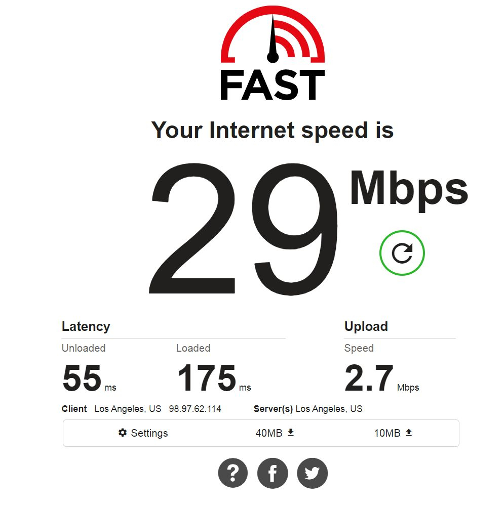

Just ran a test, also in a waitlist restricted area. From a wired PC-- 29mbps down, just under 3mbps up.
Shortly after that, one iPhone reports 116mbps down. A 2nd iPhone reported 36mbps down. All within probably less than 2 minutes.
Just noticed on the Starlink app, at least on mine, it no longer breaks out phone to internet vs router to internet. So I'm not sure which of those the phone is measuring?
